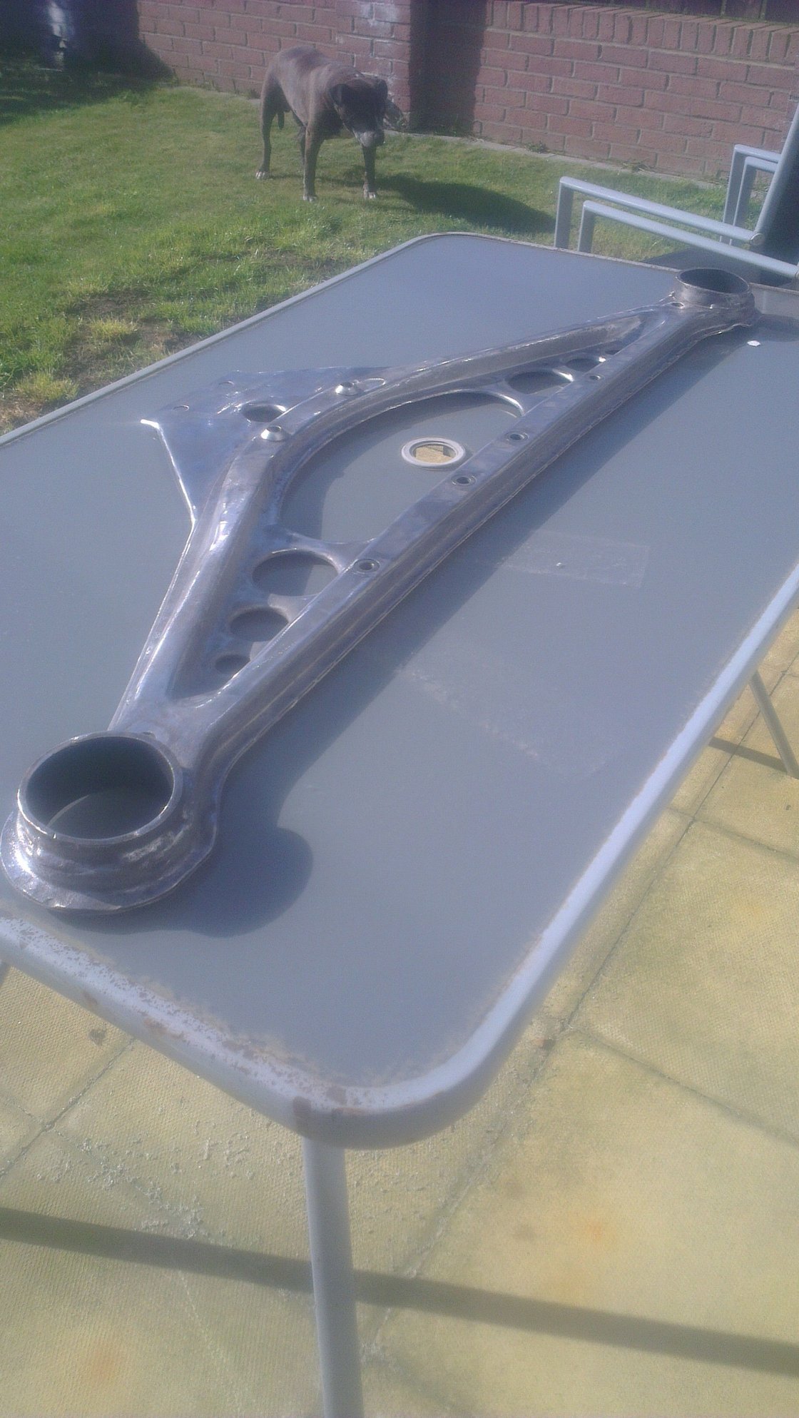

New to me 'A' frame and the bracket's have been cleaned back to the steel, then had three coats of epoxy 121 applied at 5 day intervals, then left for over 2 weeks to harden .
Sorry didnt take any pictures of the epoxy coatings, but here is one of the A frame cleaned back just before applying the first epoxy coat ..

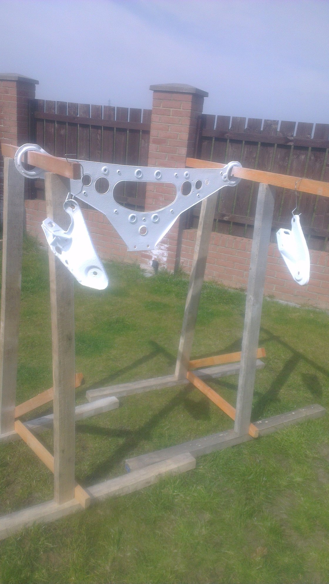

After about two weeks i gave the epoxy a scuff up with 320 grit and then coated it and the brackets with stone chip..
Then left for 7 days or more, and then a base coat of white x3 and a coat of lacquer x3 ..
Then left for 7 days..

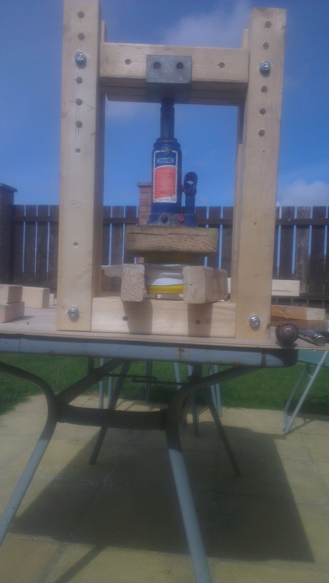

Next was to fit the new A frame bushes, (power flex)
So i made up a jack press, (from some timber off cuts) and a 4 tone bottle jack .
It worked very well, and the bush went in easy.
The finished refurb....

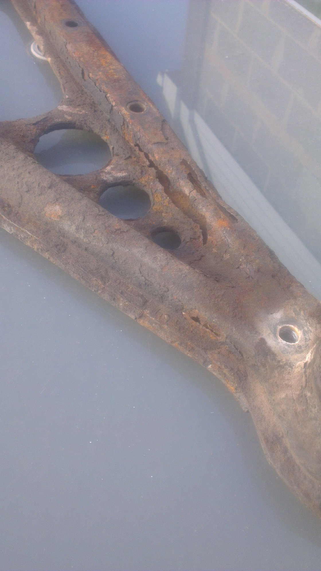

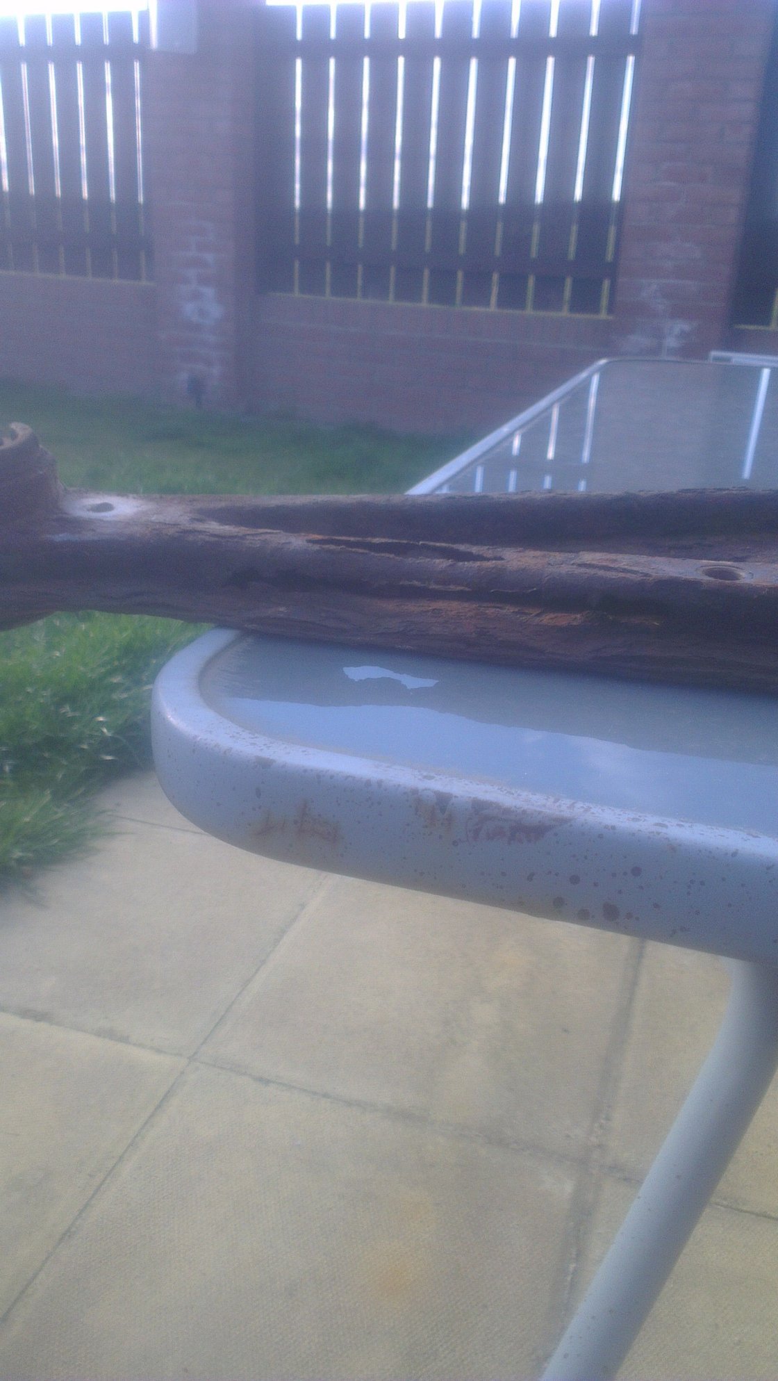

Well that was difficult......
Took me all day to get the old A frame off the car.
All the fixings where badly rusted, and i had a right struggle with them. Looks like i will have to get all new bolts to refit the refurbished one.
Some photos of the rusted A frame.

XKR-DAY,
Crikey well done getting that off! It was never gonna get through the MOT.
With the subframe in that condition, it does beg the question about all the other parts.... Did you see any other horrors?
