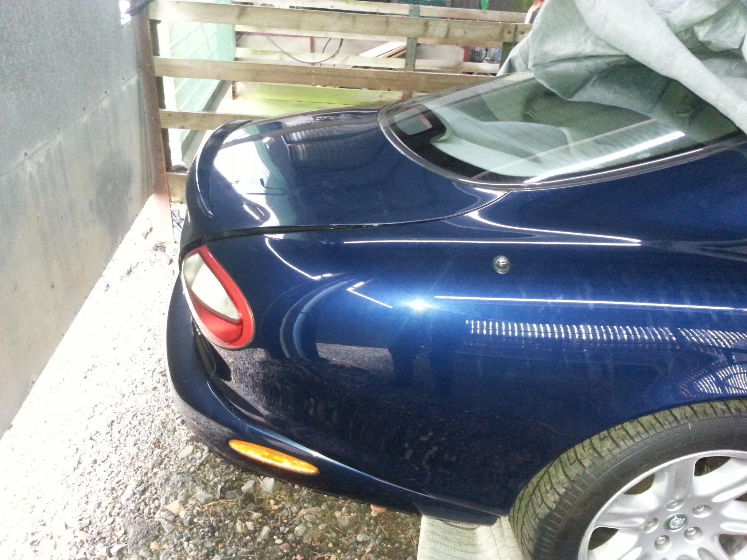

Went up to where the cars are stored to pay for this winter....disaster my friend is handing over the barn to another for sheep!!!! So its my last year for storage, may have to sell one of the cars.
However I took up the spoiler Tony sold me and placed it on the boot and took a few pics. Not sure exactly where its supposed to sit, any advice appreciated. Will fit it and the front grill in the spring, hopefully.
