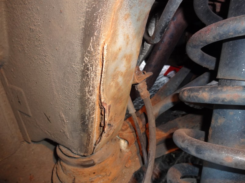

I spotted this yesterday while working on the wheel arch. I hope I can get it cut out and new welded in without having to take the damper and spring out the way. Will also need to check the other side.

I found a couple of other UK owners with the same problem, they removed the rear sub frame to get good access and have good pictures of the process.
I had planned to do a rear end suspension rebuild at some point in time so will do this at the same time.

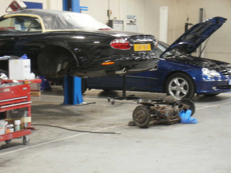

Hi RD - I am a new UK member with a 2000 XK8 Cabriolet that had failed the MOT due to chassis rot where the rear suspension bolts to it (level with the rear of the centre sill section, i.e. in front of the rear wheels) both sides.
I presume I will need to somehow prop the car up on axle stands and drop the rear suspension to let a welding expert repair the chassis rails there but trawling through the forums and youtube I still can't find a good pictorial guide of the work this entails - just the task of removing the exhaust looks like it will wreck it as the joints appear rusted together.

Does anyone on the forum know if I need to remove any part of the exhaust to remove the rear suspension.
The Jag manual doesn't appear to mention it coming apart or off but I did see a post where they cut the pipes to the rear silencers to get better access to some of the bolts. I don't really want to do this as my exhaust whilst rusted together at the joints, still works OK.
If anyone has removed their rear axle I would appreciate your input - if you have photos of the process, even better.
If not then it may be me documenting the process.
Thanks Mark

Here is a picture of one showing you can leave the exhaust in place.

Thanks RD - for me pictures speak many words.
This is exactly what I was looking for.

i dont know which it is yet - i WANT to do rear end work on my subframe or i HAVE to do work on my rear subframe?
is this really true? can you really drop the rear end/axle out of the car without disturbing the exhaust?

I was awakening a thread from 2014 with hopes on an answer to whether or not the rear axle can be dropped with or without disturbing the exhaust pipes in the area...?
I can look around a bit but was just wondering

Yes, it is possible.
Full details here. https://www.jaguarforums.com/forum/x...repair-149852/

Whoa!!! Deep bow and thanks! Really, looks scary as heck thinking about doing this on the street in front of my place (did my XJS rear end this way), due to all the bits and pieces, I think is a NOOOO go. But it's good to know that it's possible. Shoot, with all that work I don't even know if adding in some exhaust disassembley even makes THAT much a difference, lol...
Love this. I'll do it, but I guess I have to find a place.
