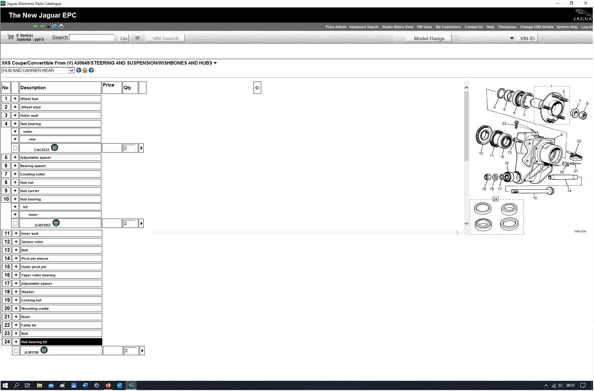

Try forum Sponsor S N G Barratt for the option of Jaguar OE or aftermarket equivalents:
Rear Outer Hub Bearing
https://www.sngbarratt.com/English/#...0%60CAC6333%60
Rear Inner Hub Bearing
https://www.sngbarratt.com/English/#...21053%20%20%60
Rear Wheel bearing Hub - Kit
https://www.sngbarratt.com/English/#...0%60JLM1708%60
Here's the relevant section from JEPC showing the P/N's:
