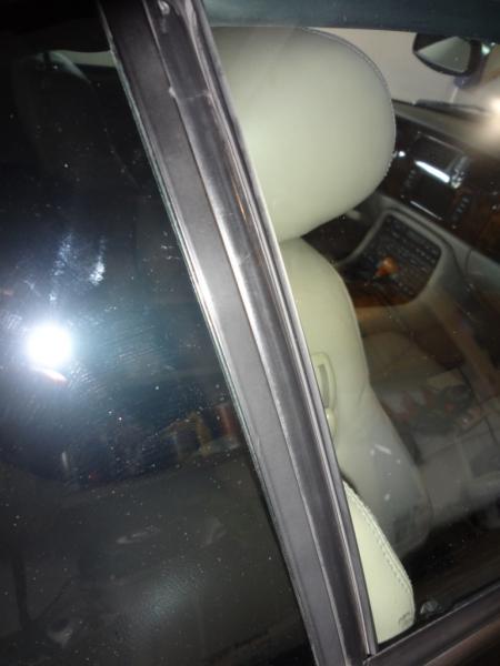

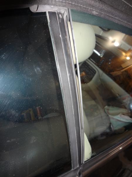

Wow! Was not expecting to see so much movement in correcting the issue from adjusting the front window screws but why should I have doubted the members of this forum ;-). That's the good news (that the window is now capable of sealing). Bad news? I still am forced to pull the rear window forward to get it to seal but I will count my blessings and live with pulling the window for now . . . until it ticks me off enough and there is enough sun out to want to work on pulling the back seat out
Pics of gap and reduction yet to come.
Well the results are in and I have to say WhiteXKR was right in that the seal I am able to achieve after adjusting the front window is markedly improved. This has significantly reduced the wind noise and, given how easy it was, I can live with pulling the rear window for now. Maybe a project for next winter is to take out the rear seat and adjust the rear ones as well. Here's a few pics (as promised) showing how much the window moved. Thanks again all.
