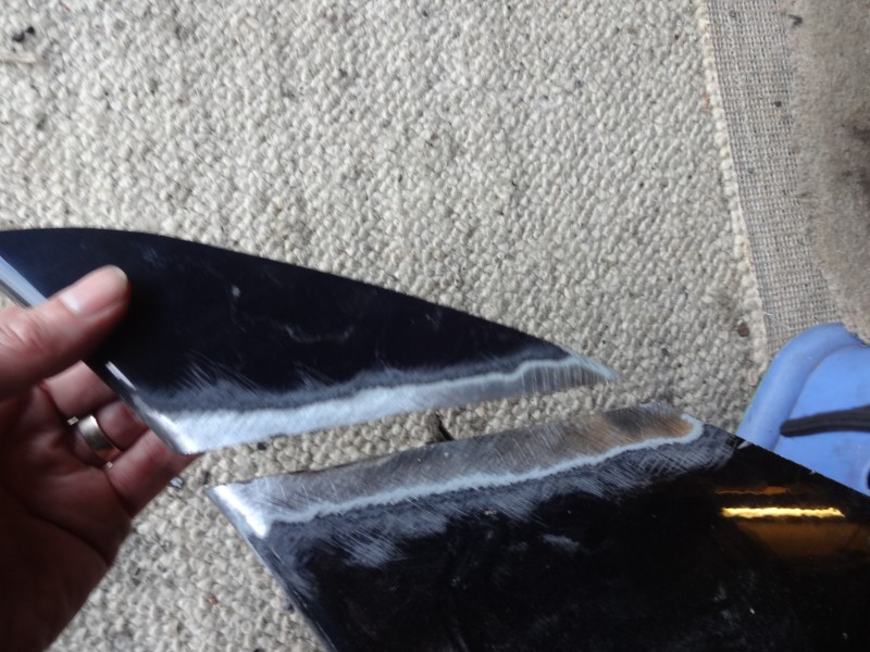

I decided to try on this part of the donor, the left hand half of this is double skinned with a foam filler you will see in the pics below.
Chopped off.
Cross section

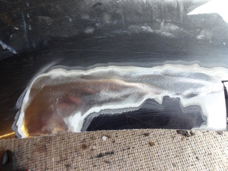

First mistake, I held the two parts together with magnets and not clamps.

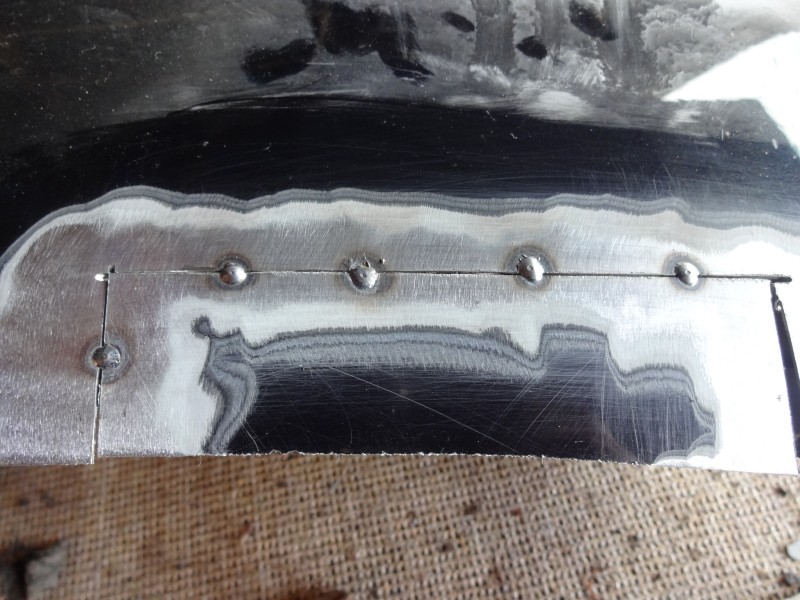

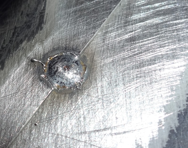

Now I set the welder up and had practiced on some scrap 1mm plate and was getting nice welds, but the first one on the donor went like this.
The next one like this, at this point the foam lit up and flamed till I blew it out.
The third tack looked good but by then the two sections had deformed and overlapped.
Backside of the 3rd weld.

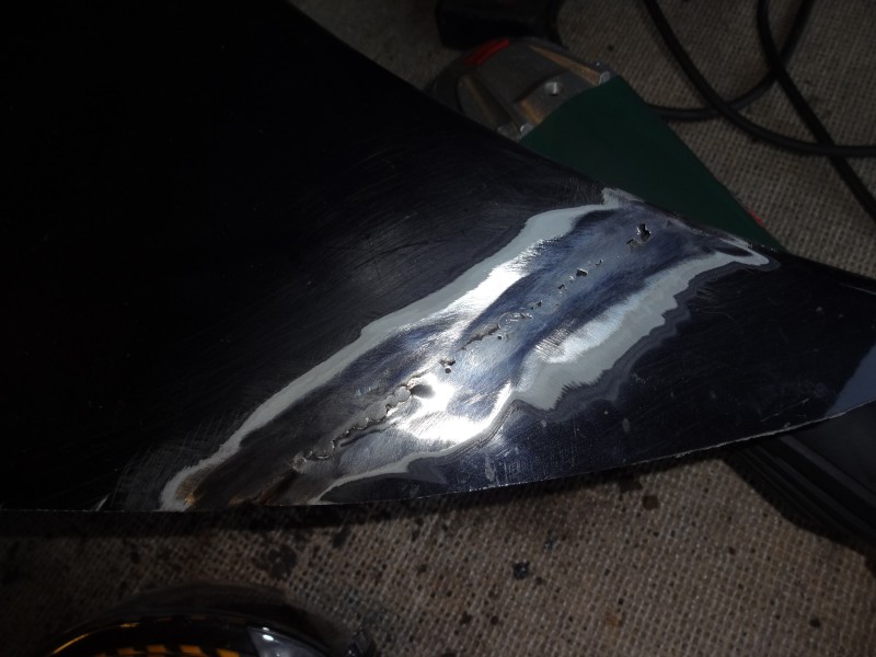

I then impatiently tacked up the rest after turning the voltage down a notch, had a few blow throughs.
Ground it down, too much on the bottom left which was proud till the metal was wafer thin.
I'll chop off another inch tomorrow and have another go.

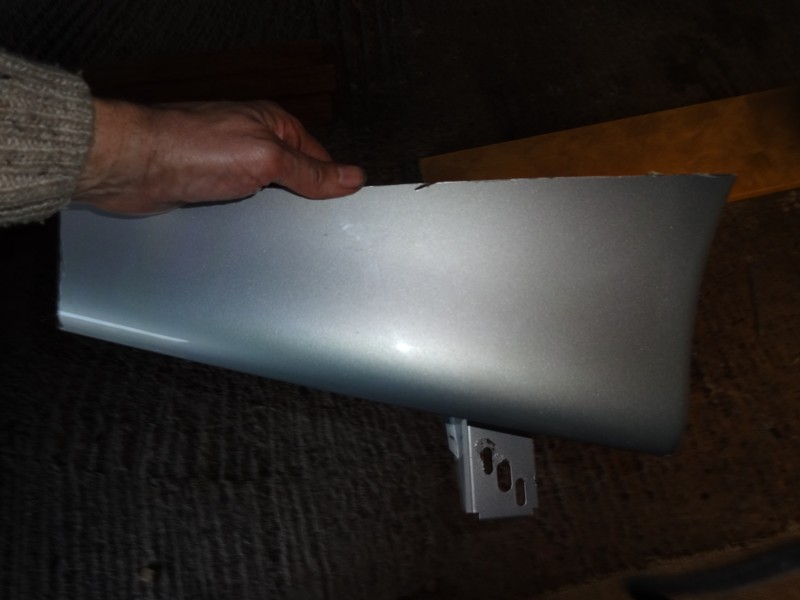

I looked at who was selling parts on ebay and the called and asked about the wings. The one I got from Eurojags was in the best condition but was also the most expensive at £160 inc delivery, the other I cut off myself at a breaker in Ayr and got for £60 + £20 in fuel to get there.

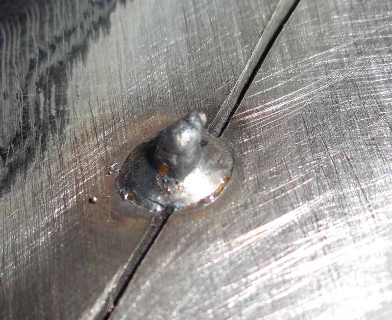

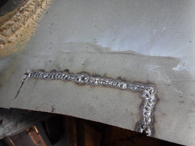

A bit more welding practice tonight.
These 7 tacks were identical, I guess the ones that exploded were directly on top of the foam and the good ones were not! I'll need to find a way to get rid of any foam before the proper job.
The new section which was clean on the back, except for paint.
Tacks went on cleanly.
Stitched up between the tacks, still needs to be better, need to take more time.
The back.
Ground down with a flap disc.
That feels a bit better.

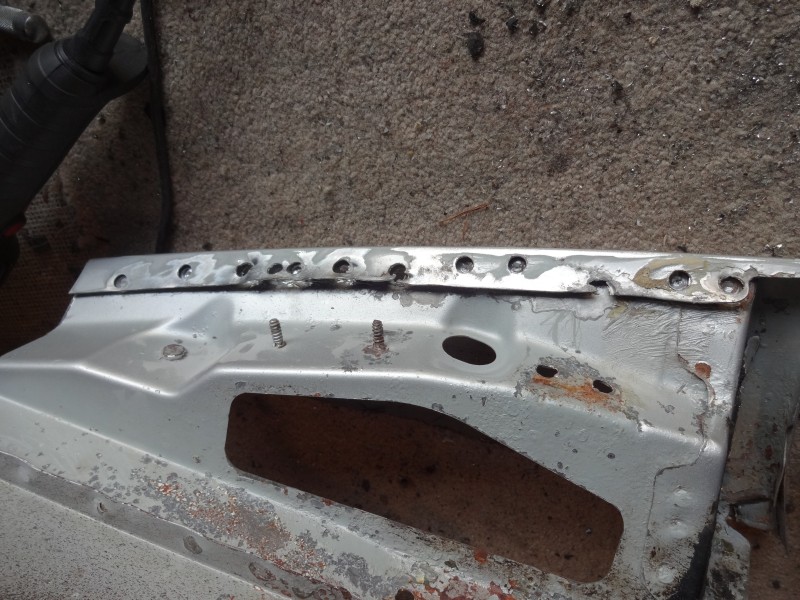

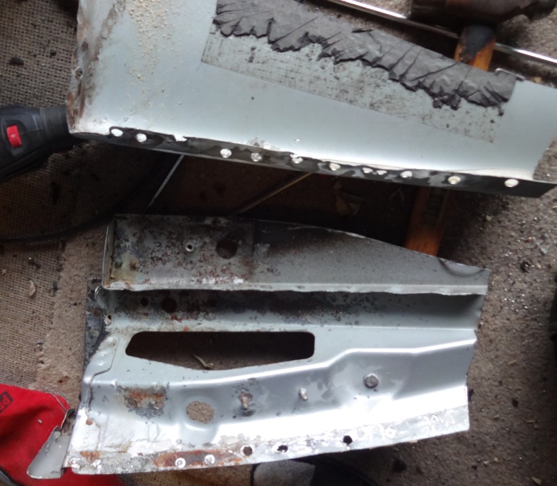

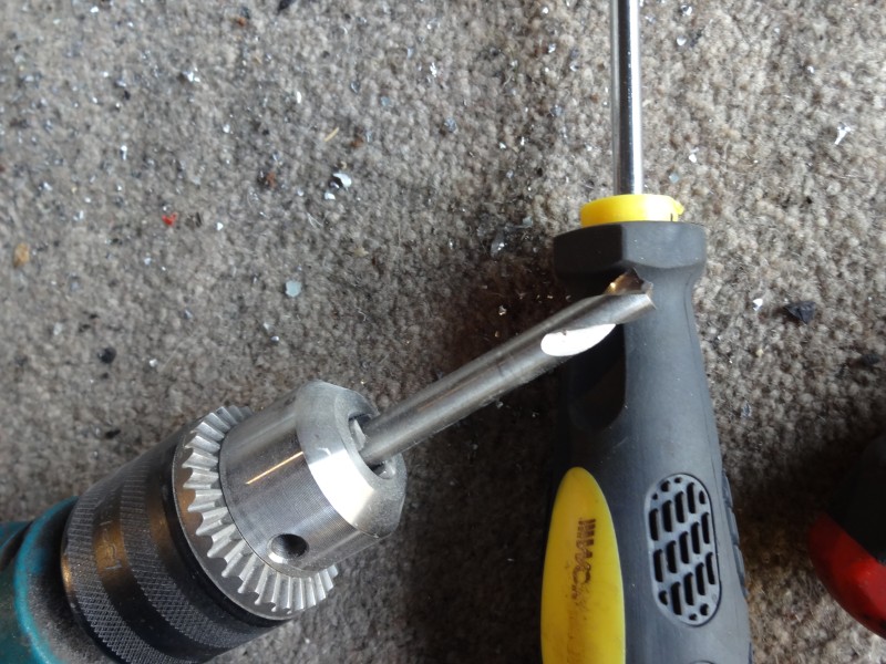

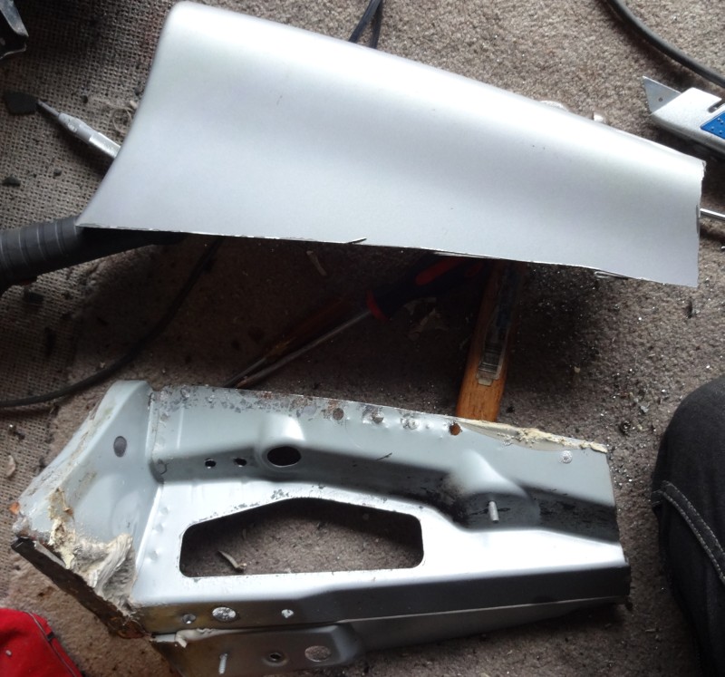

I decided to break down the donors into the component parts, I'll then strip them of paint before cutting into the car.
I used this spot weld bit but the other type with the cutting saw blade is better. I ended up having to chisel a few of them apart I ended up going right through on a couple.
