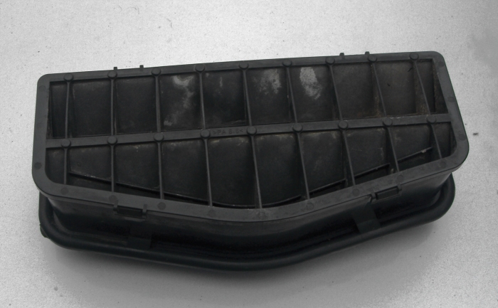

Here is what I plan as an alternative air vent. I plan to put in three of these so there is not too much of a restriction. They should tuck away behind the carpet.
I will probably also use the two access holes for the wires used for the US bumper lights as they are redundant on my car.
