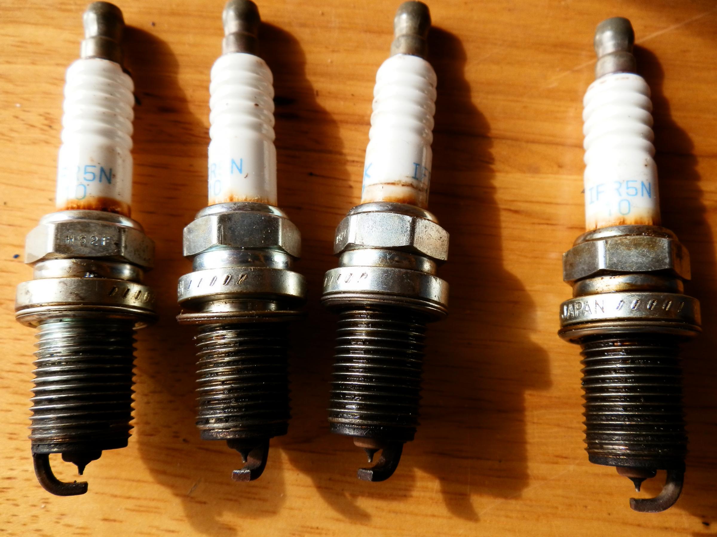

Unfortunately I am Graham, I got the left side bank spark plugs out today as I had another appointment in Morpeth so was short on time.
In all I found four of the plugs were not screwed in tight. Two on each bank, I thought stripped threads but thankfully not the case. Also I found one today closest to the bulkhead, had oil up to the flat heads and the one next to it had brown staining on the insulator. I am hoping the gaskets were just past their best with regards to the oil, and it will be sorted out when the tensioners are changed.
Could not move the crank today as I did not have a spanner or socket big enough for the job, anyone any idea what size it is and should it turn easily with the plugs out?
Would it be easier with the Serpentine belt removed?

Just did another search on the NGK web site and it looks like the plugs which were in the car when I bought it were not the correct ones, they are/were NGK IFR5N10 - stock # 7866 which are iridium not Platinum like the correct ones I have just bought NGK PFR5G-13E - stock# 2761.
As the car performed well engine wise coming back from South of London last year I cannot think it will have come to any harm, or is there cause for some concern? He started up first crack of the whip when asked a few days ago and no codes to indicate anything of note.

So I see from the photo. Unfortunately you could be rained off again over the next few days.
If the circular rubber seals in the cam cover are past their best, you will get oil in the plug holes and brown staining on the plug insulator. Nothing to worry about with the work you have planned.
The engine should certainly turn over easily (always in the correct direction of rotation and never backwards) with the plugs out and removing the serpentine belt will make it a little easier.
