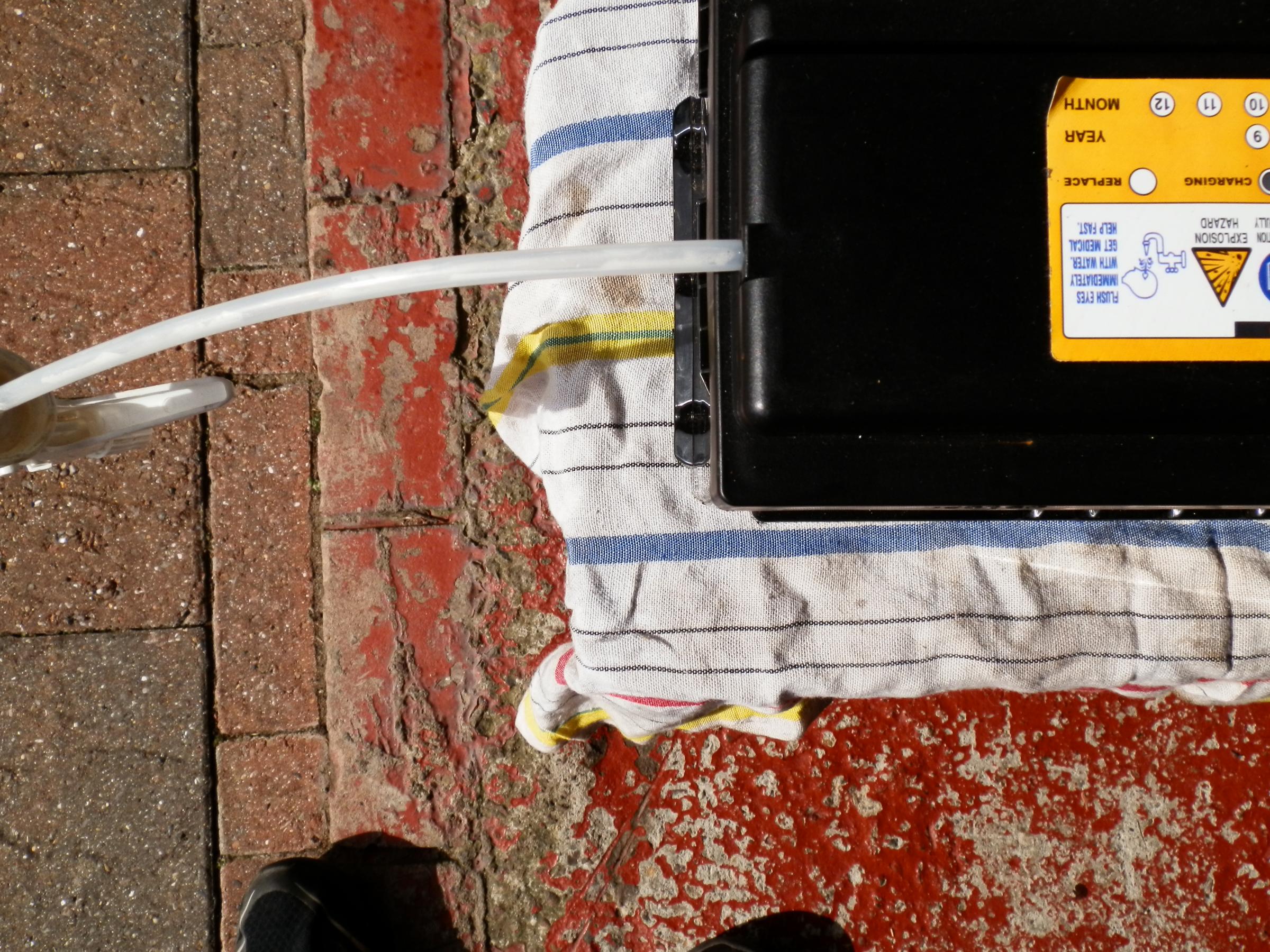

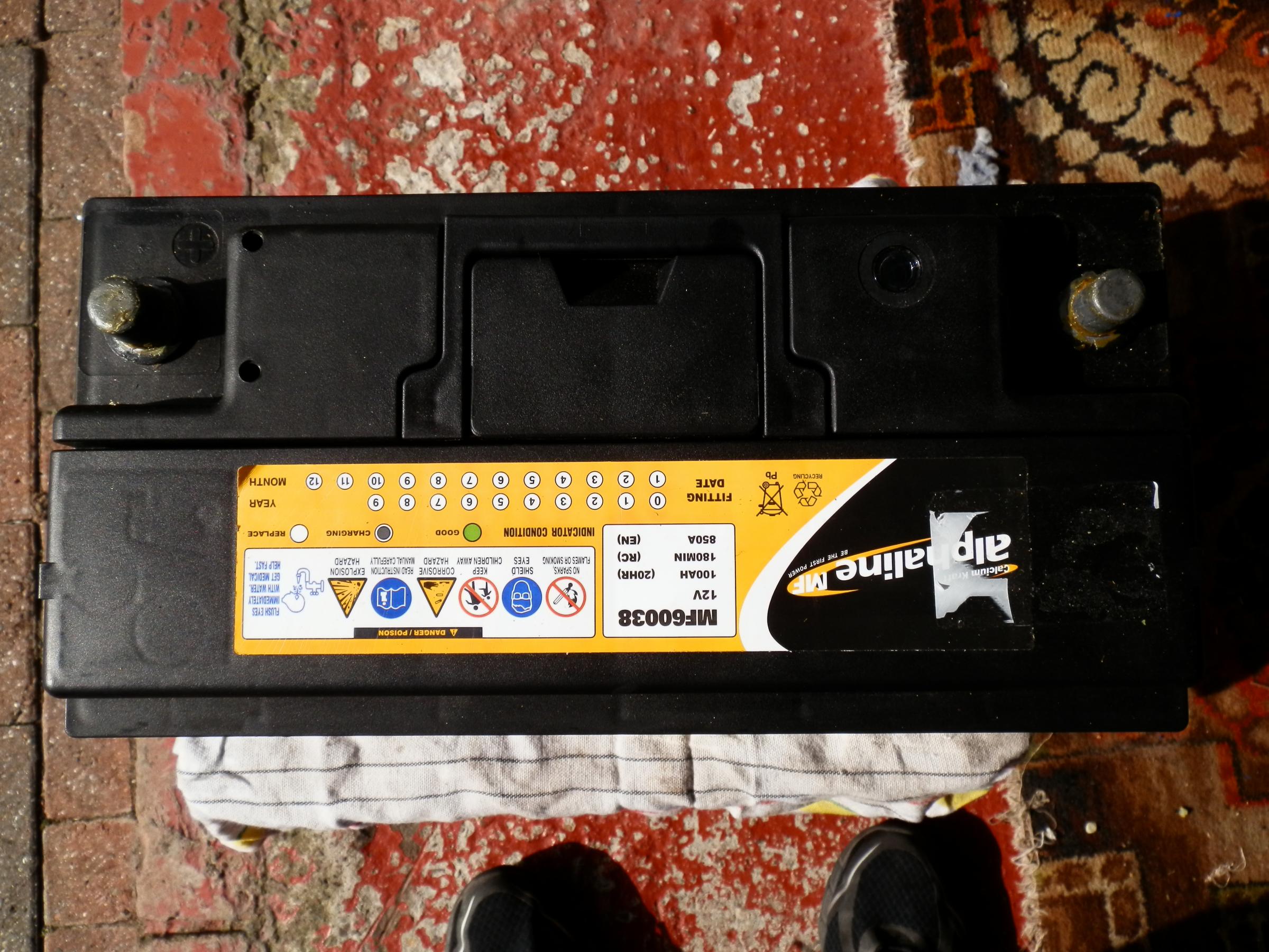

Could not get anything more done today as its just to cold!
I did take a pic of the battery which posed a problem to connect to the exhaust pipe in the boot/trunk. Here is my solution to the problem. I cut about 2" from the pickup tube on an old empty bottle of " greased Lightening ", it was the perfect fit for both ends. Now all I have to do is blank the other end.
Initially thought this was an AGM battery but its not! You just cannot fill it.
Might help someone.
