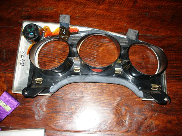

To remove the cluster panel you must remove the steering panel. The steering panel has two 8mm bolts at the bottom and two clips at the top.
Remove the two screws at the bottom of the cluster panel then put the steering column in the down position. Slide the cluster panel down so that you don't break off the tabs at the top.

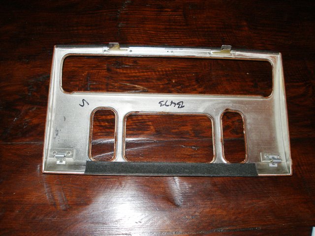

Default Center
Pulls right off.

Smile RE center Panel
See my Photos and you will be able to tell where the clips are. The top clips are installed behind the Air cond outlets and when you remove the panel the clips will usually come with the panel. when you reinstall I recommend that you remove the clips from the panel tab then insert the clips back into the slots and press the panel into the clips. Otherwise the clip reach can shorten and the panel does not fit as flush. I think I have removed my panel at least 50 time while working on the nav system---No damage YET!!!!!!!!!!!

Finally got round to having a go at this. Pulling the centre dash panel off took an awful lot of force and there was an almighty crack as it unclipped. No apparent damage though.
Unfortunately, the gauges appear to be sealed units so there is no way of removing the dust - which begs the question: how did it get in there in the first place?
