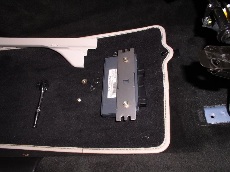

Assuming the passenger seat is working, try swapping controllers (the grey box under the seat) between passenger and drivers seats temporarily.
Old Mar 1, 2012 | 07:43 AM
+1
The case lid is weak and often found damaged. The securing bolts on mine were completely ripped out and I had to replace it:
Shown here with the seat out but you can easily get to them with the seat in place.
