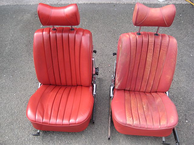

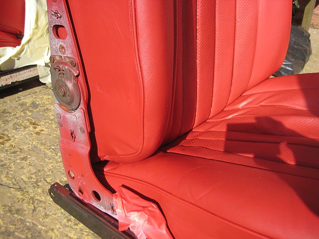

I spent a lot of time on my 30 year old merc seat, I cleaned/scotch padded them with two supplied solvents for wax and silicone removal, then I did a final degrease with brake cleaner.
Sprayed them with three coats of dye, one coat of sealer and then a top coat of clear mat.
Realistically this needed to be done out of the car. I did this more than 2 years ago and the finish is still good.
Attached Thumbnails Repaired leather bolster lasted less than two months.-sponge%2520coat.jpg

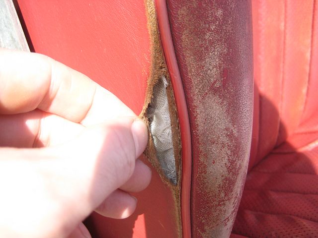

I sent these guys a small bit of leather from beneath one of the seats so they could match the colour exactly and bought one of their kits.
Leather Colourant Kit
I also bought one of their tear kits.
Went to this
Attached Thumbnails Repaired leather bolster lasted less than two months.-gauze.jpg   Repaired leather bolster lasted less than two months.-repair%2520close%2520up.jpg
