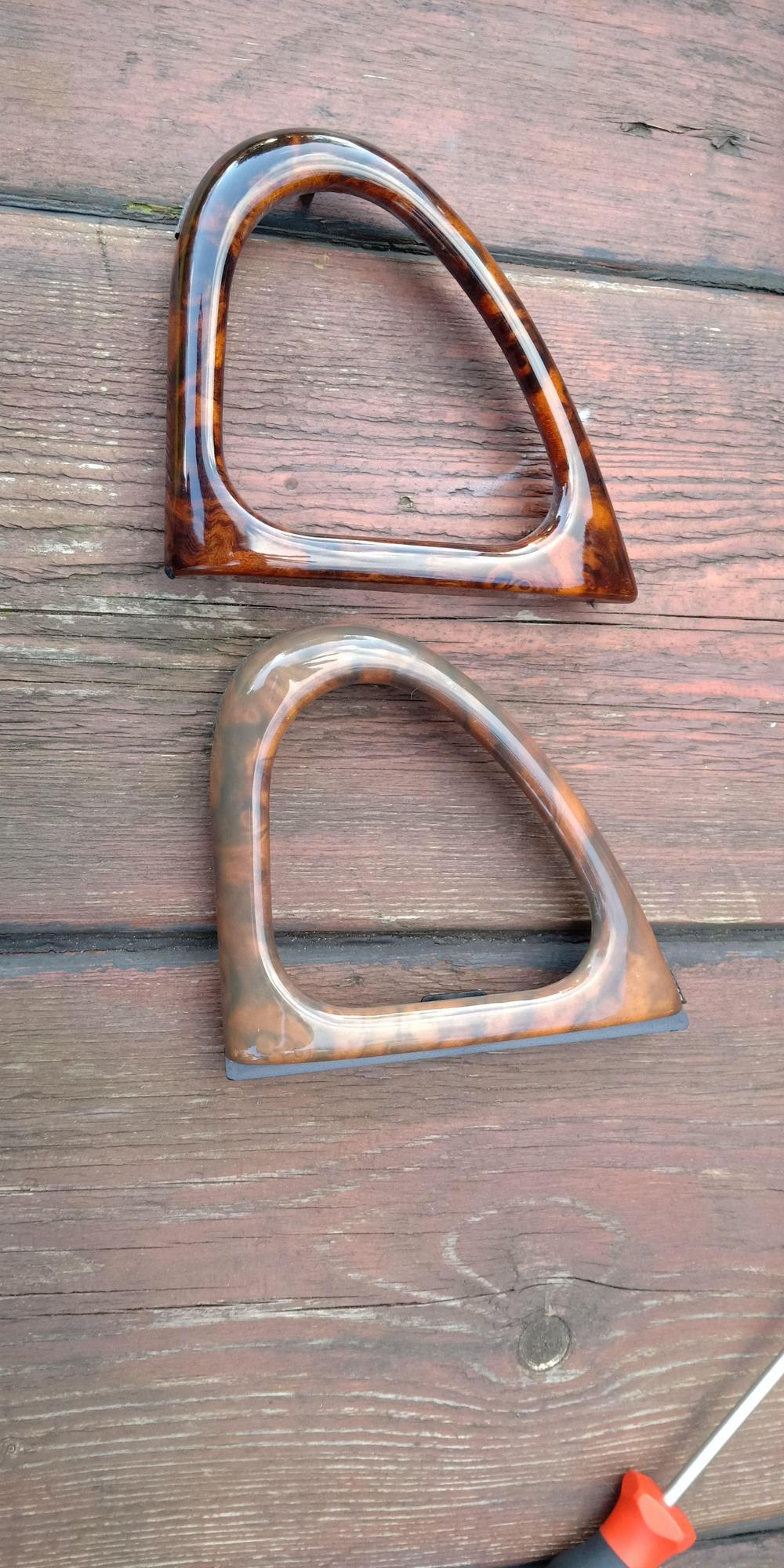

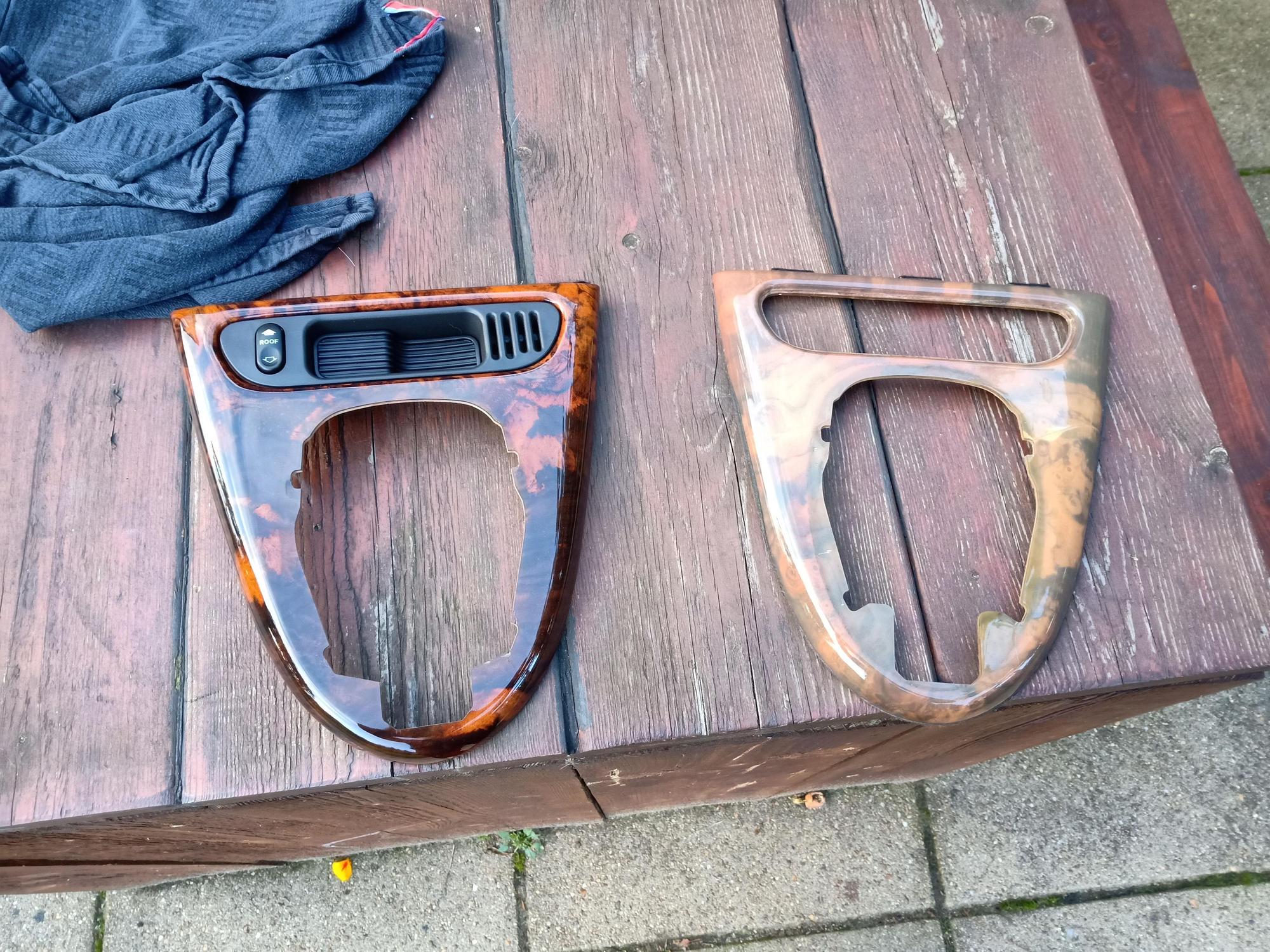

Dear all, after replacing the outdated navi with the 3 gauge cluster I've experimented with dash panels covered in oatmeal faux leather (see my previous post). It looked ok but it was always the idea to change all wood panels. Certainly as my dash has a bad case of milky / yellowing clear coat on the panels (see pictures). Searching ebay I found a nice complete set for $215 and $30 for shipping. Add taxes around $70 and I think it was a good deal. the panels look great, no cracks or anything and the set was complete.
Installing the new set was actually not that hard. You can find tutorials on youtube for almost all panels and only the passenairbag panel was a bit tricky. But if you take the Jaguar workshop manual, second edition 1999 and first remove the glove compartment “Glove Compartment 76.52.03 Removal” you just need to follow the steps for “Passenger Air Bag Module 76.73.37 Removal” and you are there. There is also a thread about removing the connectors on the airbag on this forum. Do note that there are connectors at both sides of the airbag!I didn’t take many pictures or made a video but just wanted to share with all of you that it is not that hard, as always, prepare yourself by looking at all the video’s, read the manual and take your time.

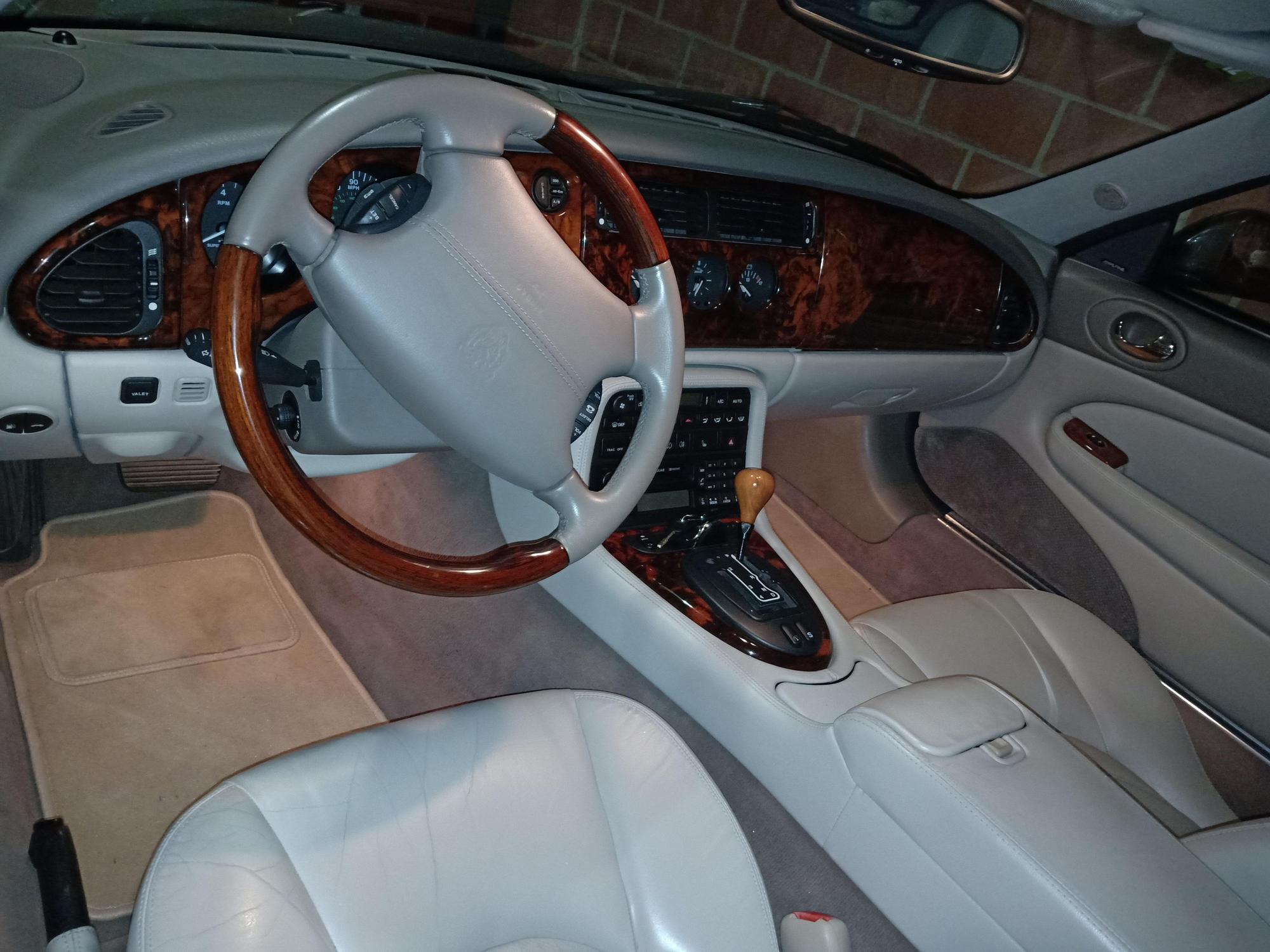

Thanks, answered a question I posed long ago. My 2001 dash is quite a bit lighter than the 2002s. However, it looks nice, in my opinion.
https://www.jaguarforums.com/forum/x...01-xk8-218930/
The picture below doesn't do it quite justice, but it has a pronounced elm'ey effect, but appears clear, not milky like the wood around the door window controls. So much so, that the elm shift knob I now have fits right in. I have a replacement set of veneer (since they were $18), but I guess I'll still keep the bad clear coat anyway now that I know.
Elmy effect that is apparently bad clearcoat.
