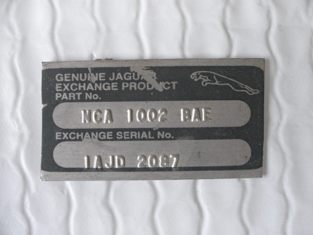

It will look like this if it is an "official" Jaguar rebuilt engine.
