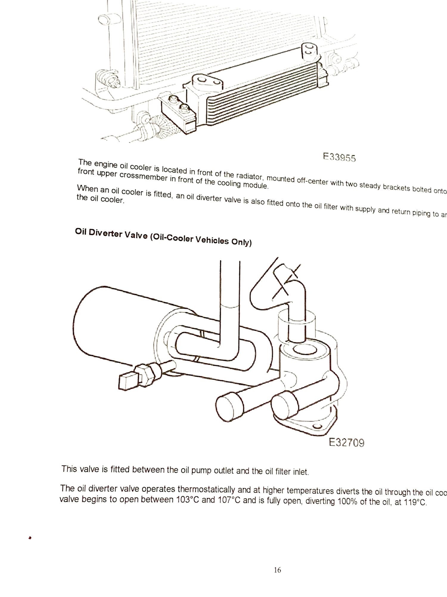

With your larger oil cooler your oil temp might even be cooler if it wasn't for the oil temp thermostat closing off the flow to the cooler when the oil temp drops

Zray the oil cooler is always working. I know they have a diverter valve that is supposed to start sending oil to the cooler when it reaches 217-225 degreesF but when i've been on the interstate at 75 mph sometimes the oil is only 180 degrees when I stop. I get out and feel of the fitting on the oil cooler on the input side and it is very hot and barely warm on the output side so I know the oil is flowing at some small rate all the time.
I believe going with larger oil cooler is good as the original oil cooler is very small.
Jack
i would not be satisfied with oil that didn’t get over 200 F for at least some of the time. Oil gets water condensation in it every time the engine cools off. If the oil doesn’t get to 200 F or more for at least a while then the condensation is never burned out and the oil does a lousy job of lubrication, it gets “sludgy”.
just keep an eye on your oil consistency and you will likely be OK.
Z
PS
sound's like the diverter valve is stuck open, I’ve never heard of that happening but what do I know ?
I am not educated on the precise operation of the oil cooler diverter valve. It may be 100% normal for a small amount of oil to pass thru to the cooler. That said , using my car for an example I can’t feel any warmth on the cooler or the oil lines until the engine has fully warmed up. Of course, one car can just be an anomaly.
