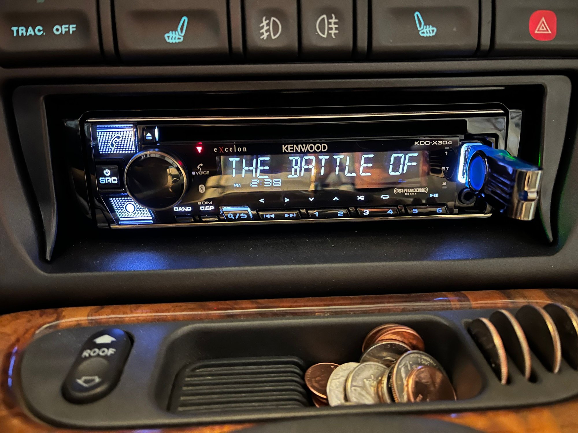

I tried all of these solutions:
Adapter that connected to the CD changer, worked great for awhile….then stopped altogether.
Cassette tape…sound quality issues with a slight hissing sound
cigarette lighter adapter…..had occasional interference
I went with the Dynamic Sound kit out of the UK and purchased a single Din stereo, A bit pricey, but I have all the latest Bluetooth technology and can put back to original in a short time if I like.

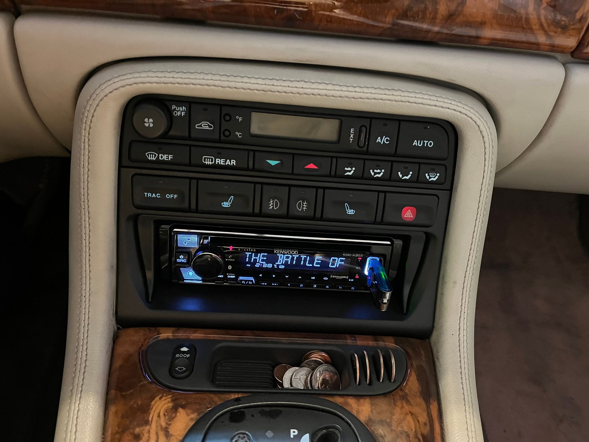

The Kenwood KDC-x304 worked great for me. I usually leave a jump drive plugged in with my favorite music, but SIriusXM and Pandora run great off my phone.
looks great, where did you get the dash kit or did you do customize it yourself. Thanks

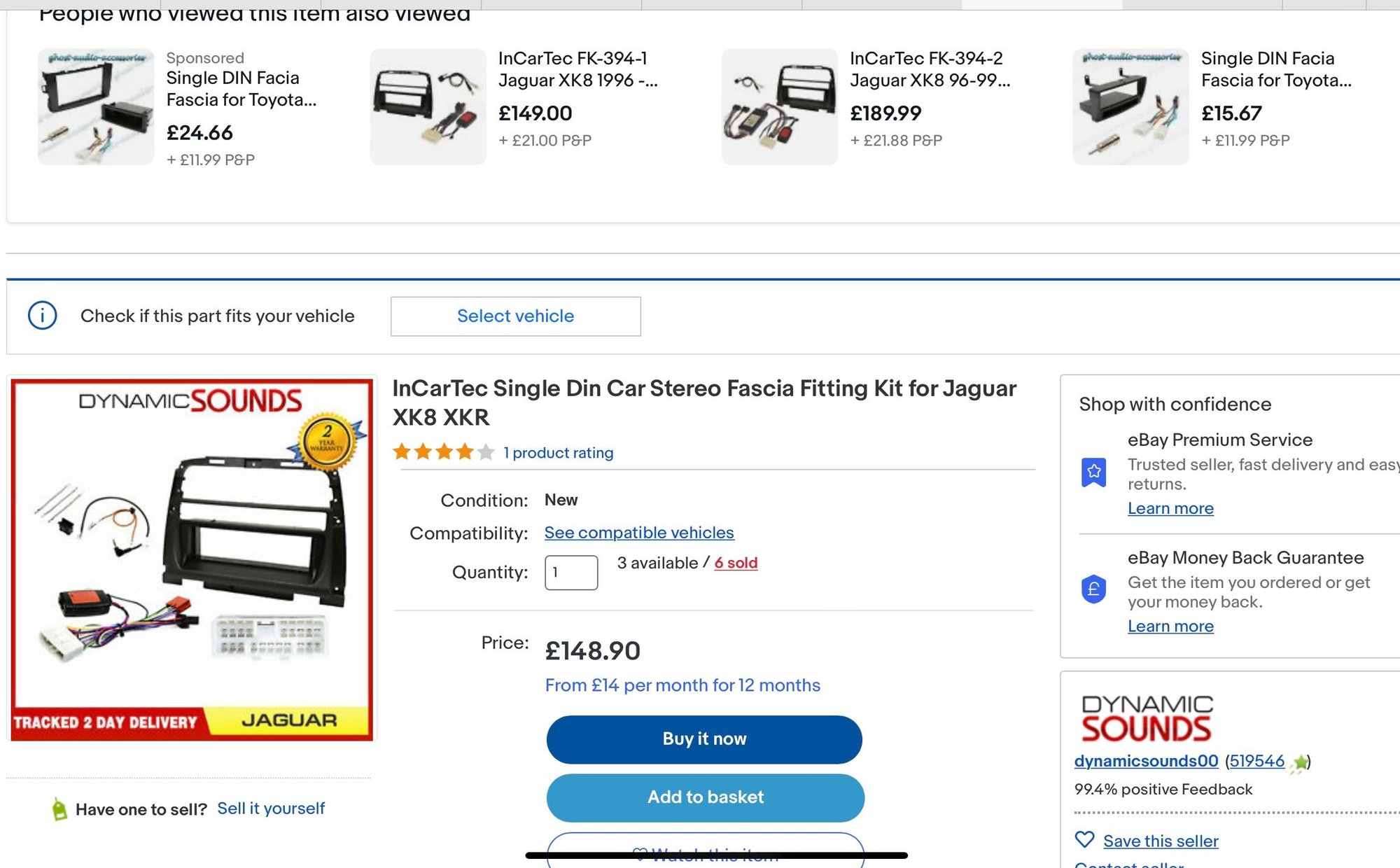

Ordered the dash kit from Dynamic Sound out of the UK and got the stereo locally from Mickey Shorr electronic store.
Thank you for your reply, l know it’s a little pricey but we’ll worth it. Did you leave the same factory amp and just installed the kenwood receiver?
Old Apr 28, 2022 | 06:26 AM
galearmstrong's Avatar
Joined: Jan 2021
Posts: 49
Likes: 19
From: Canton, Michigan
Mine didn’t have the factory amp, just CD changer. Dynamic Sound has several different wiring harnesses, it’s best to pull your radio and compare the plug ends (with Dynamic Sound pictures) to make sure it’s plug and play. With the correct harness the steering wheel controls work and you don’t need a jumper to operate the antenna properly. I had the electronics store install mine, was very inexpensive and I wanted to make sure everything worked properly…they’re the experts. I did pull my stereo and reinstall the replacement trim….didn’t want any trim issues

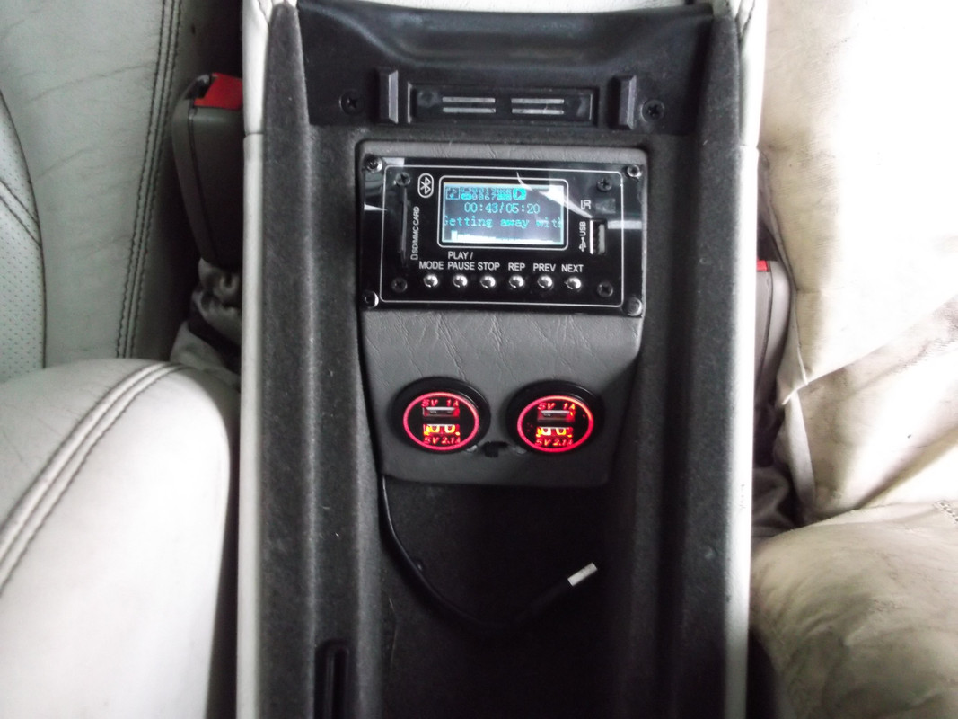

PIE audio module + 12v bluetooth module - inject a line in to the alpine system, combine with a bluetooth module that includes a mic input and splice into the mic harness under the center trans tunnel console - power with the switched accessory circuit in the trunk - seamless - looks OEM- sounds great - hands free mic works too - therefore siri/google assistant works too. Just add a good phone mount and you're laughing.
  • PIE audio module: https://www.ebay.com/itm/265519714312 - $20
  • Bluetooth module:
    Amazon Amazon
    - $14
  • fuse tap for accessory circuit in boot: (a million choices for this on amazon, $5-$10 (i already had one lying around)
  • relay part number for accessory circuit in boot if not present: LJA6703AA either order a jaguar one, or a generic aftermarket replacement with that part number from an auto parts store/ - $10
    All in, an afternoon's labor with a couple beers and just a hair over $50 and you have bluetooth, hands free calling, integrated with the OEM audio completely stock look.
    Exactly HOW you connect the PIE audio thingy depends on your cars audio options and satnav package, but regardless of options, the stuff above WILL work for any alpine audio car. I did it on a premium audio car with satnav and cd changer. On my car, it was NOT necessary to access the back of the head unit. I did all this in the trunk only (well center console cubby had to open up for the mic). I think if you have no audio components in your trunk at all, you need to get at the back of the head unit. If your sound system is that basic, just replace it with an aftermarket head unit.
