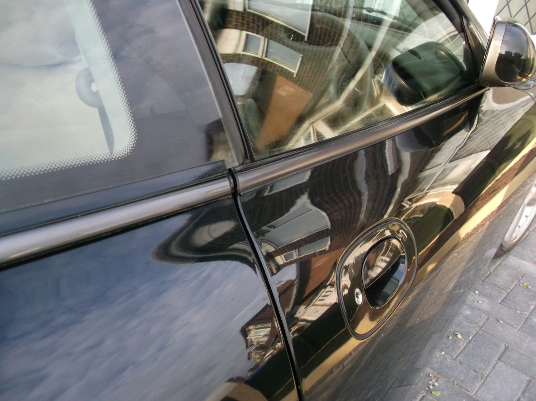

You want to search for "BMW Mini Cooper One R50 R52 R53 Outer Weatherstrip Front Door O/S Chrome". I have fitted them and they certainly look better. However, issues I've had (possibly due to my lack of fettling skills) are as follows:
1/ You do have to cut them to size, they come with removable plastic end-caps and these can be re-used with modification.
2/ They are not as tall as the Jag originals and you can see the inside of the inner window seals through the windows. Also, they do not create a perfect seal against the window; towards the rear of the door I can slip a playing card in the gap between the seal and the window.
3/ I have a convertible and did the quarter seals as well but struggled to get them to line up well (vertically) with the door seals. If doing quarter seals as well you can get away with just buying 3 BMW seals and cutting to suit.

John Dee to the rescue…
My X100 seals are fine, so the question is, will this work for my ‘02 X308?
