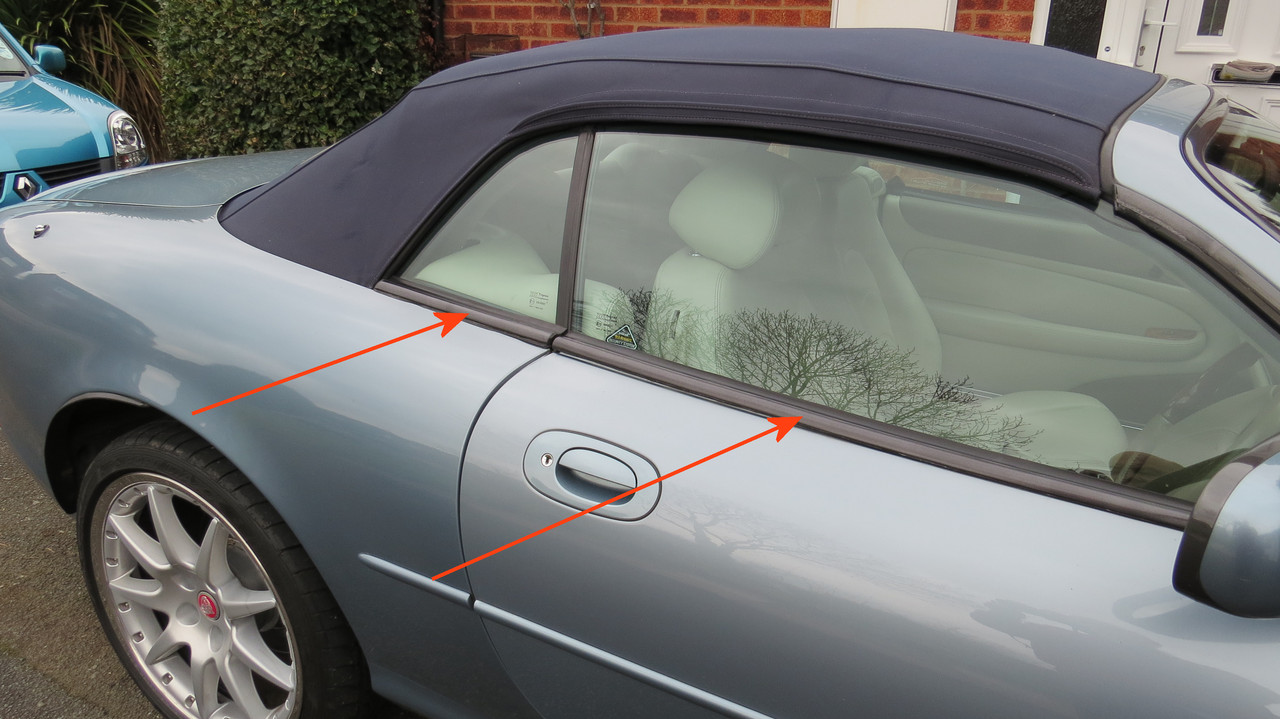

These are the seals I am talking about, the one marked with the arrow on the right.

I don't see a picture showing up, no arrows
I can see them too. Do you want me to send you the photo?
Old Jan 17, 2019 | 06:33 AM
Posts: 25,865
Likes: 4,708
I'm not seeing the pic either - tried 3 different browsers - IE and Edge just display a small box with an x and Chrome doesn't even display an image. I've even logged out, cleared cache and still the same

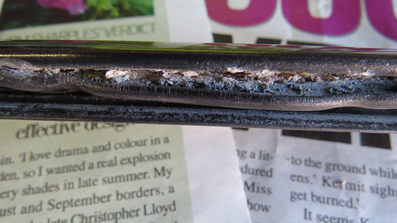

The top of the photo is the metal bit in Dorchester Grey. The next two bits of rubber are supposed to be together but the water has got in. The ally inside has 'blown' and expanded. This is the bit that grips on to your door. If your not careful you can easily bend the seal quite badly when you try to remove it, and you swear someone has super glued it on.
The bottom rubber bit and the distorted rubber bit above is where your window slides pass. Not very nice is it?
That is why the strip is so hard to remove from the car and your window has scratches on it. Remember I am NOT doing this as a commercial venture. I will be just happy to get the money back I pay out for design and manufacture.
