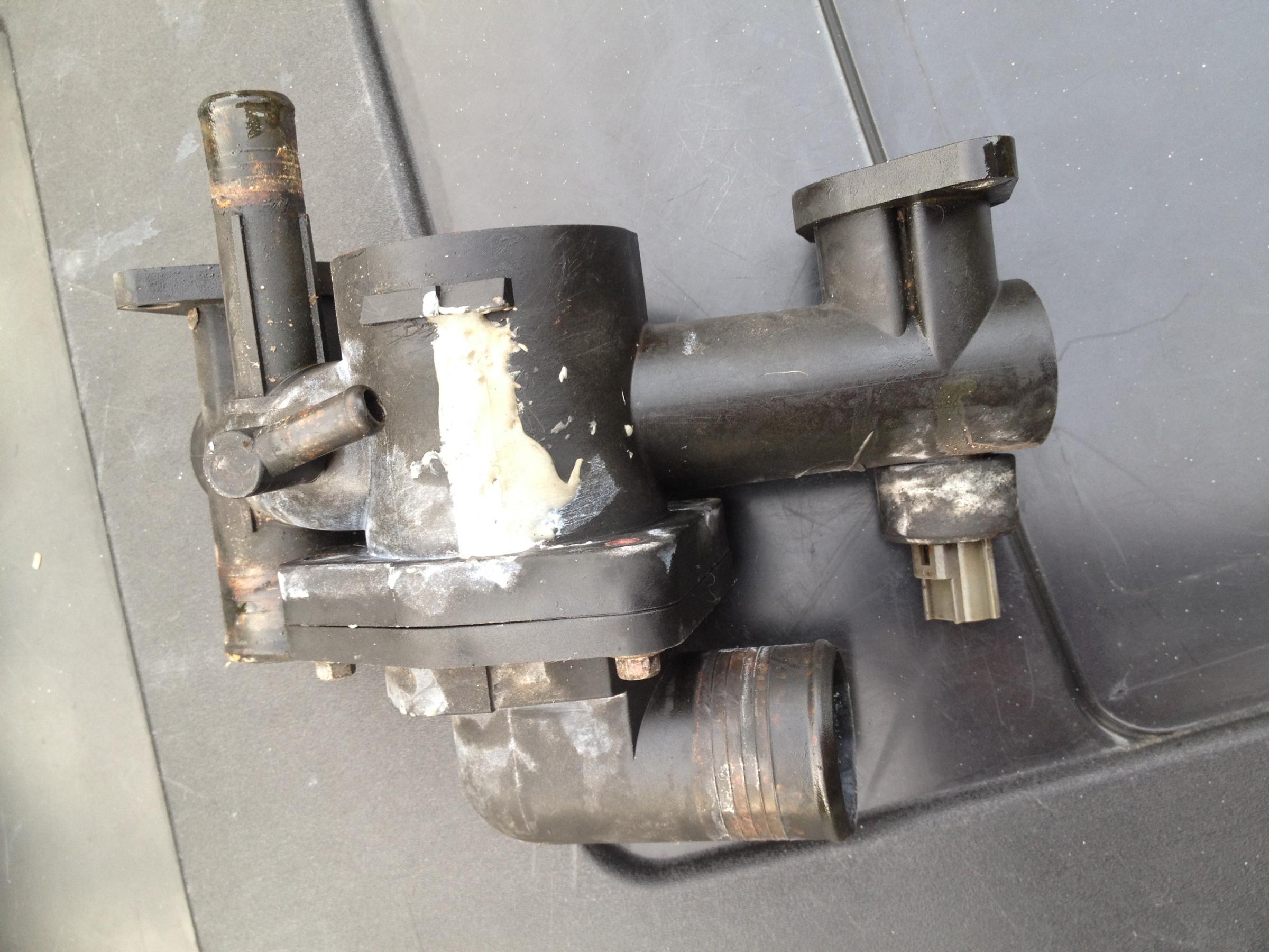

Done! That wasn't so bad. Using a bent 8mm held by vice grips, the back bolts came out pretty easily. Long-handle needle nose pliers helped with the unscrewing. A little snug getting the passenger side one past the front of the intake manifold, but not a big deal. The pics show where I had patched the crack with JB Weld, which itself split right along the line of the crack. The car has about 101,000 miles on it.

good work!
