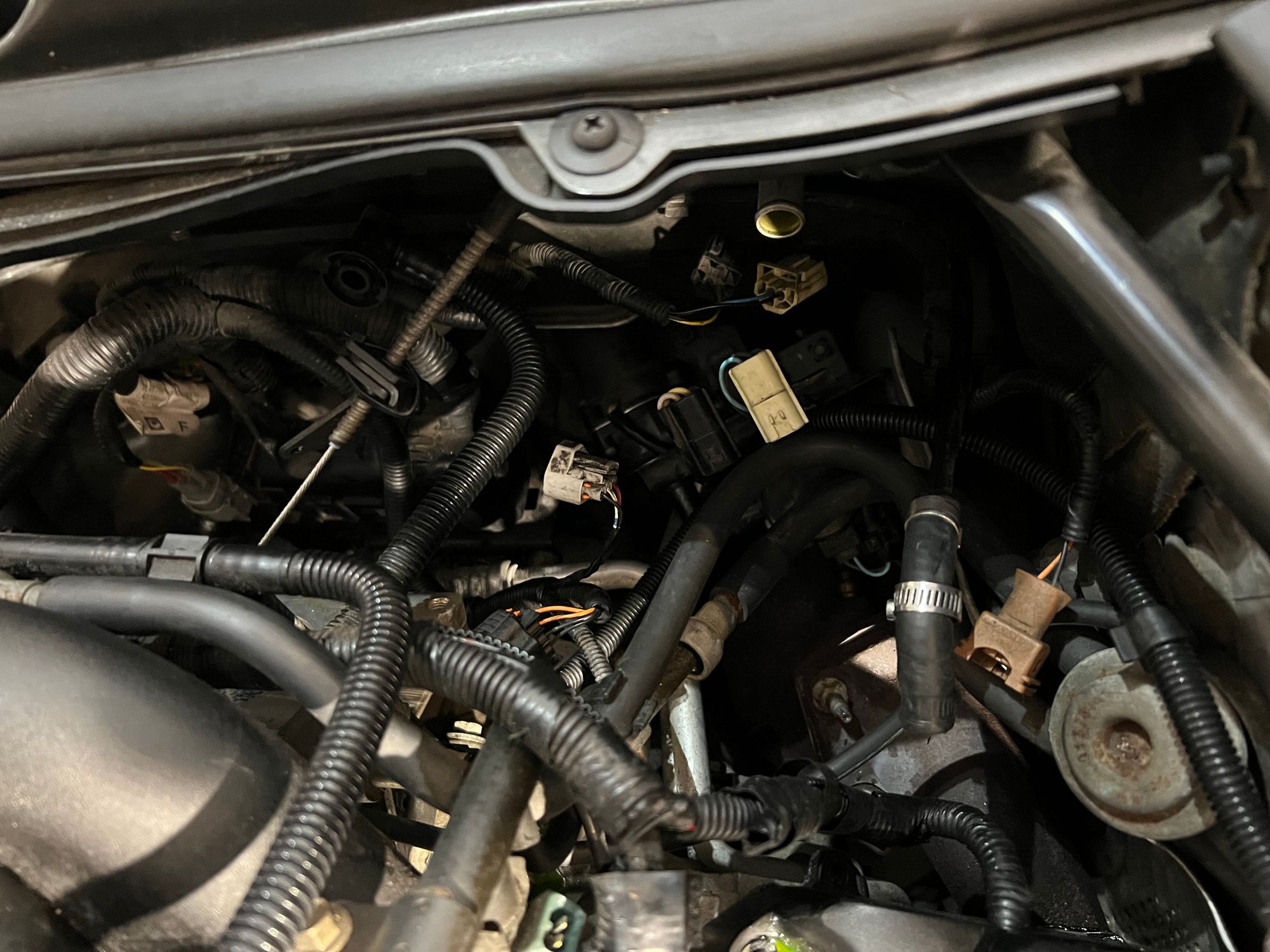

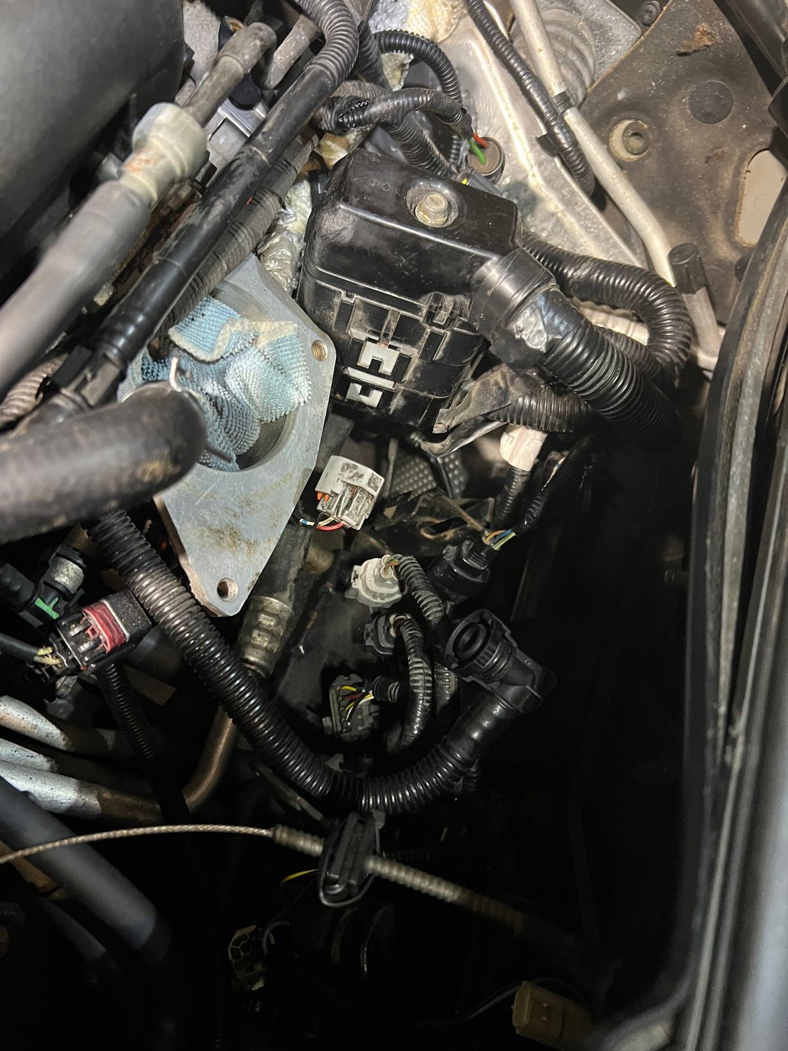

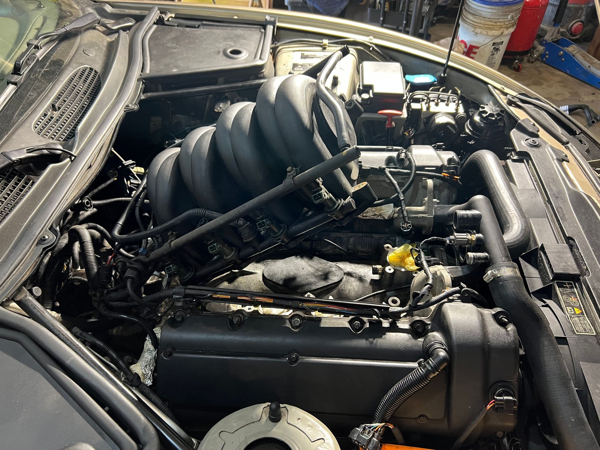

Photos showing access with manifold tilted and throttle body out.

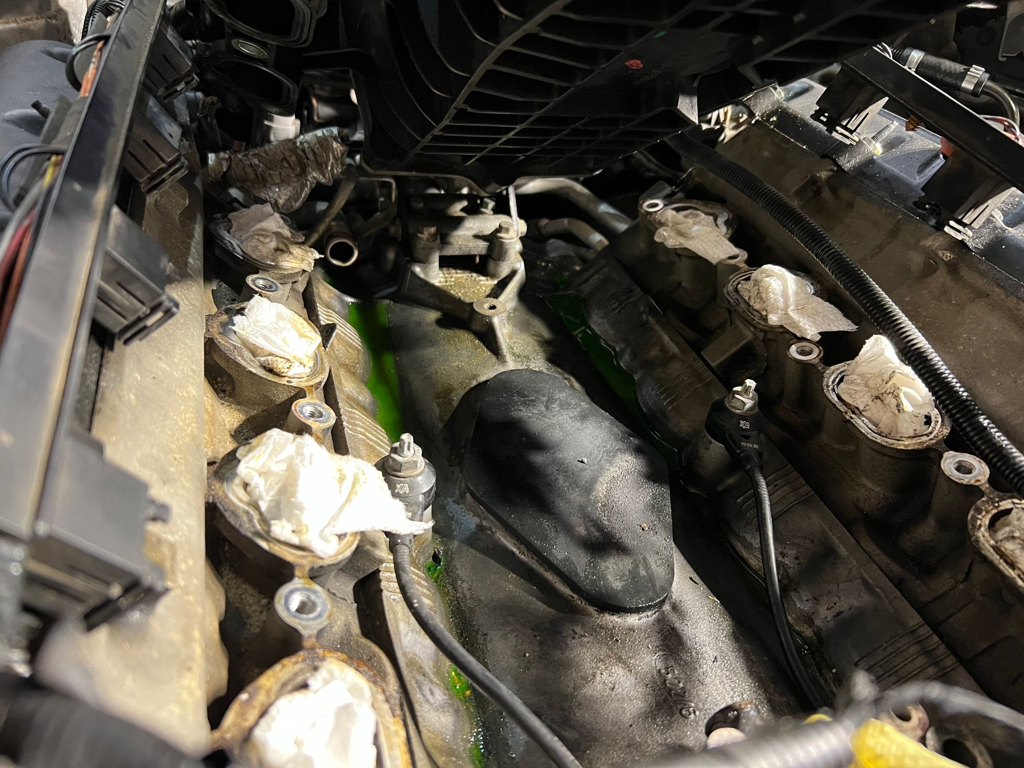

From: Pensacola, FL
Helpful items. Little spray of silicone on outside of hose for clamps to slide into place. Hoses sliding on fine. To remove had to cut most length wise at connection because 23 years had glued hose to metal and not much room to pull and twist.

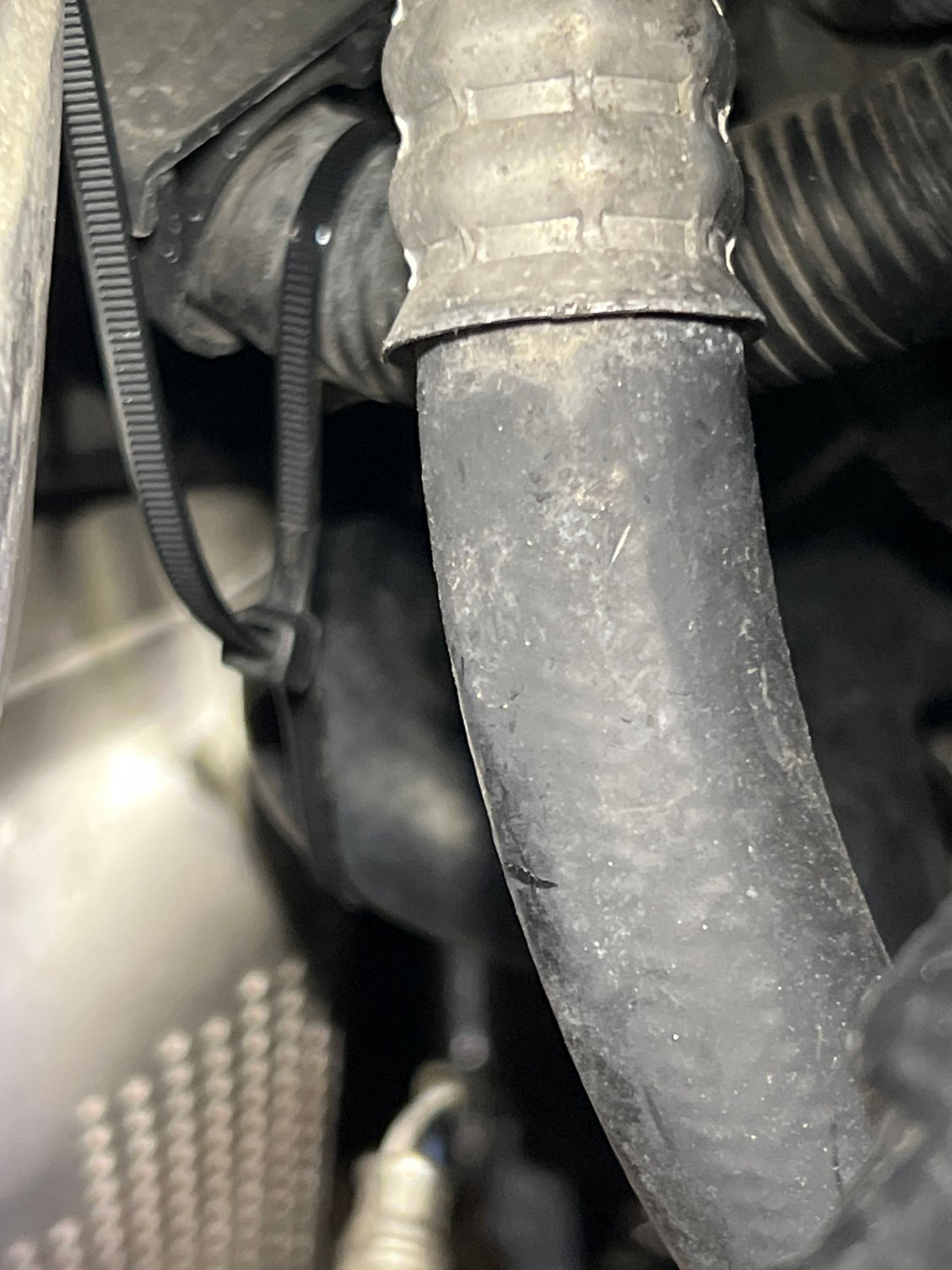

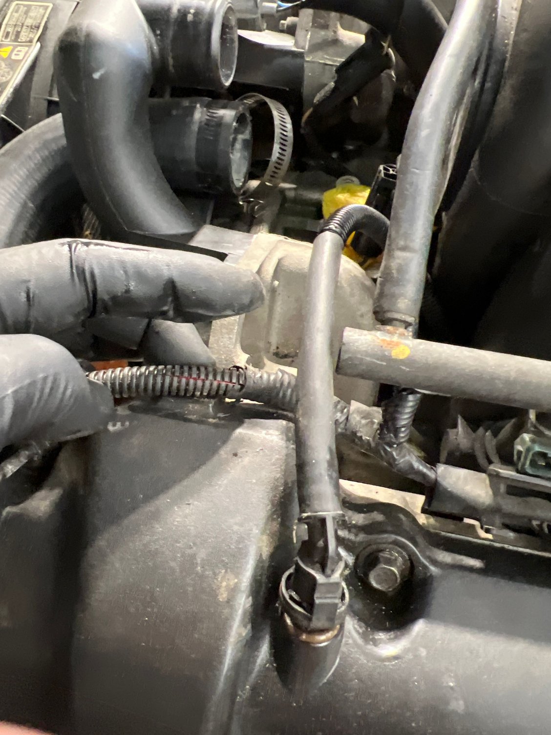

Both original and replacement hose on right have this partial kink. Doesn’t seem right. Can someone send me a pic of theirs?

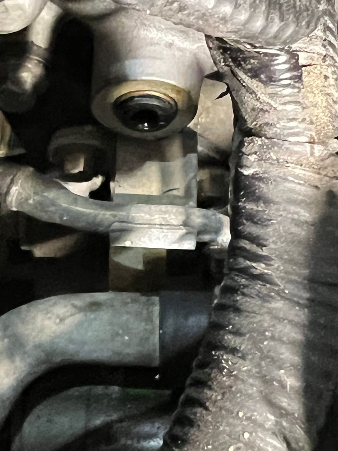

Moving these connectors made room for octopus hose. Should have done when removing old one.
The weird kink is correct. Mine had it too. Don't sweat it.

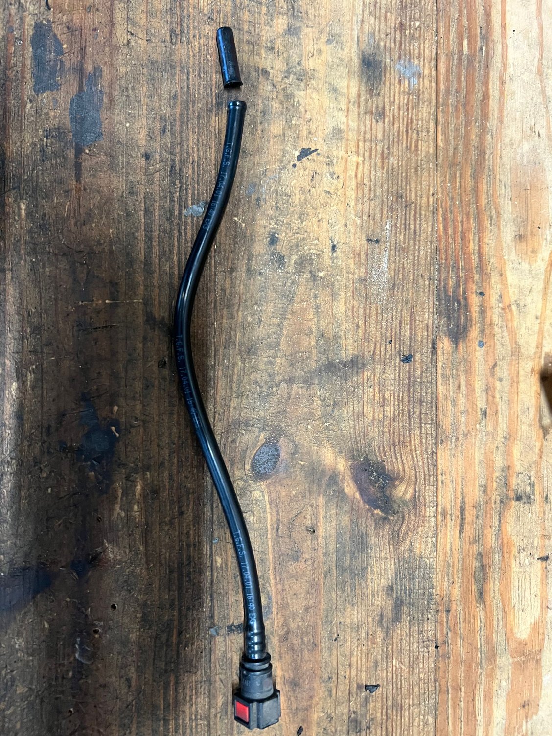

Originally Posted by michaelh
You need a C2S15816. It's flagged for the S-type, but is the same.
Strictly, you only need the insert.
The trick to disengaging the vac pipe from the TB is to press the black insert into the ferrule while pulling (gently) on the pipe.

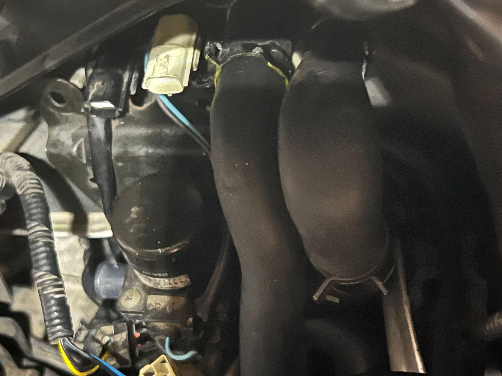

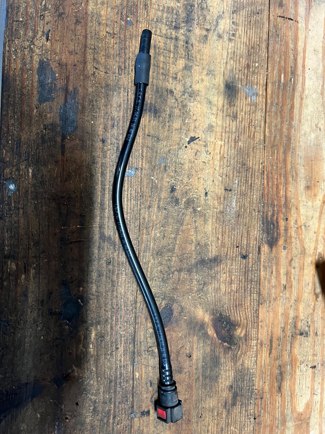

Wasn’t trying to remove, just bumped when wrestling hose in.
This also broke. Pic is post repair.
