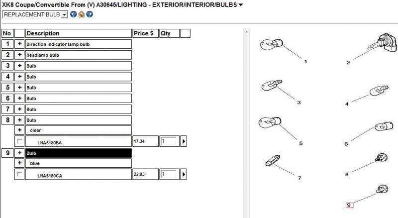

JPEC lists LNA5180CA as "blue" which probably means it is the one you need. The other alternative is LNA5180BA, but that is listed as "clear".
Replacing Stereo and A/C display lightbulbs ?-bulbs.jpg
These are available from Gaudin for $6 and $5 respectively. Expensive for a bulb, but better than $20. Googling seems to come up with a number of sources with varying prices.
Hope this helps.
