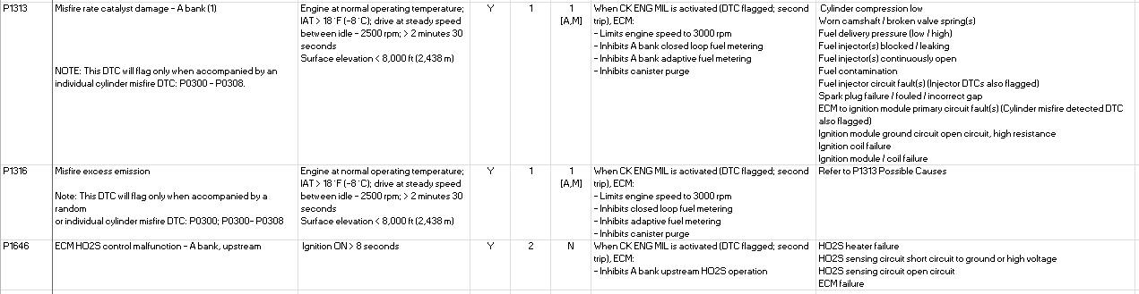

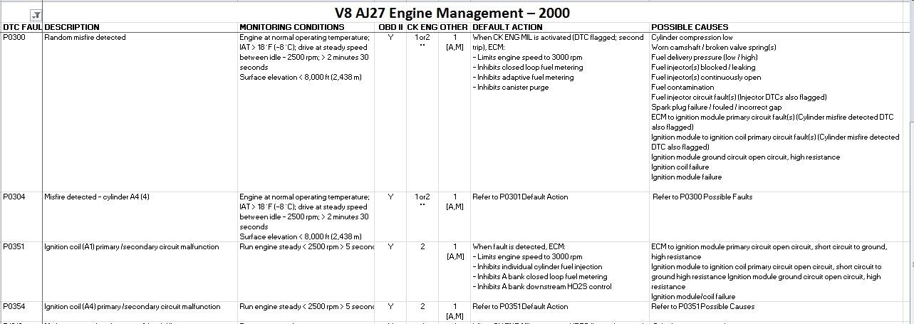

Here are the code definitions from the 2000 EG:
Your first two indicate an issue with ignition for cylinder A4. Plug? Coil? Try swopping the coil with another cylinder and see if the fault follows the move (clear the codes beforehand). I've included P0300 & P0351 for reference
Second pair related to the misfire, warning a risk of catalytic convertor damage if the fault persists.

P1313/P1316 are likely to do with severe misfires and causing catalyst damage. The O2 sensor code (P1646) means you need to fix the O2-related problem and soon if you don't want also to be replacing cat(s).
Separately - I'd try swapping coils round now they should be OK, to see if the fault follows or not.
