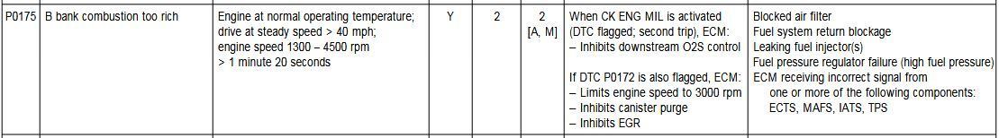

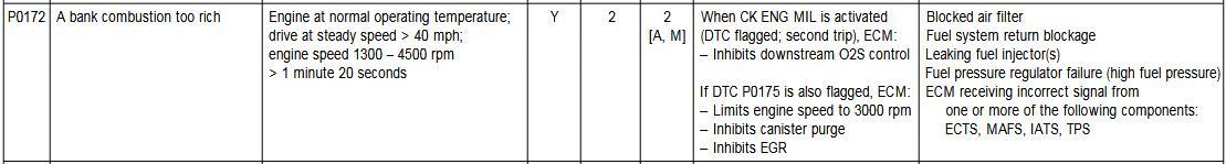

Rich running can be caused by many issues, or a combination of issues. A stuck fuel pressure regulator, leaking fuel injectors, a stuck-open coolant thermostat, a failed or open Coolant Temperature Sensor (ECTS), weak ignition (how are your spark plugs?), a stuck-open purge valve, etc. Here are the listings from the DTC Summaries:
If your scan tool can view Live Data and you can see the coolant temperature, it's worth monitoring the coolant temp while driving the car to see if the temperature is getting as high as it should and to confirm that the thermostat is opening and closing. Also check the signals from the MAFS, IATS and TPS for plausibility.
Throwing parts at these kinds of problems can get very expensive.
