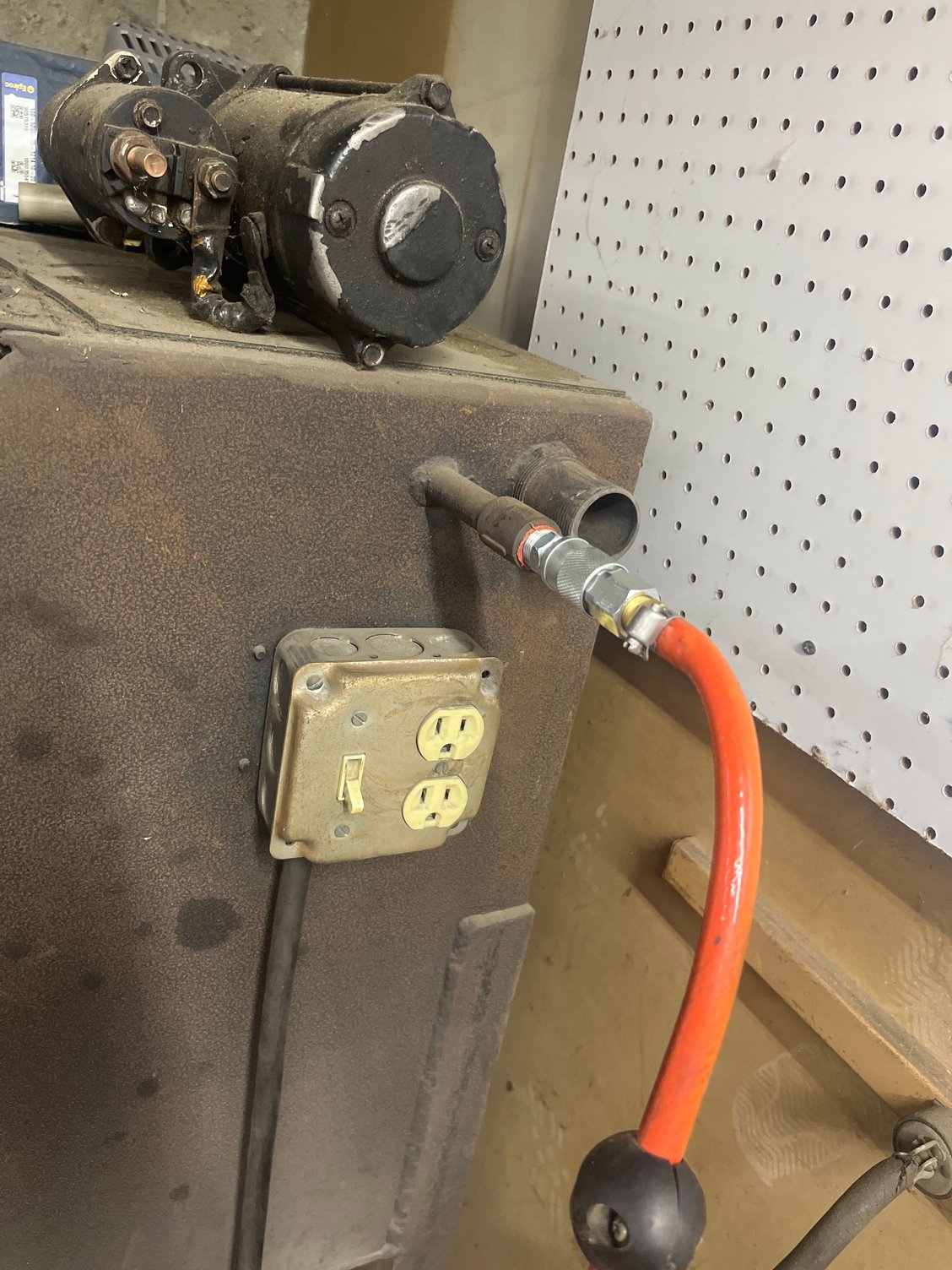

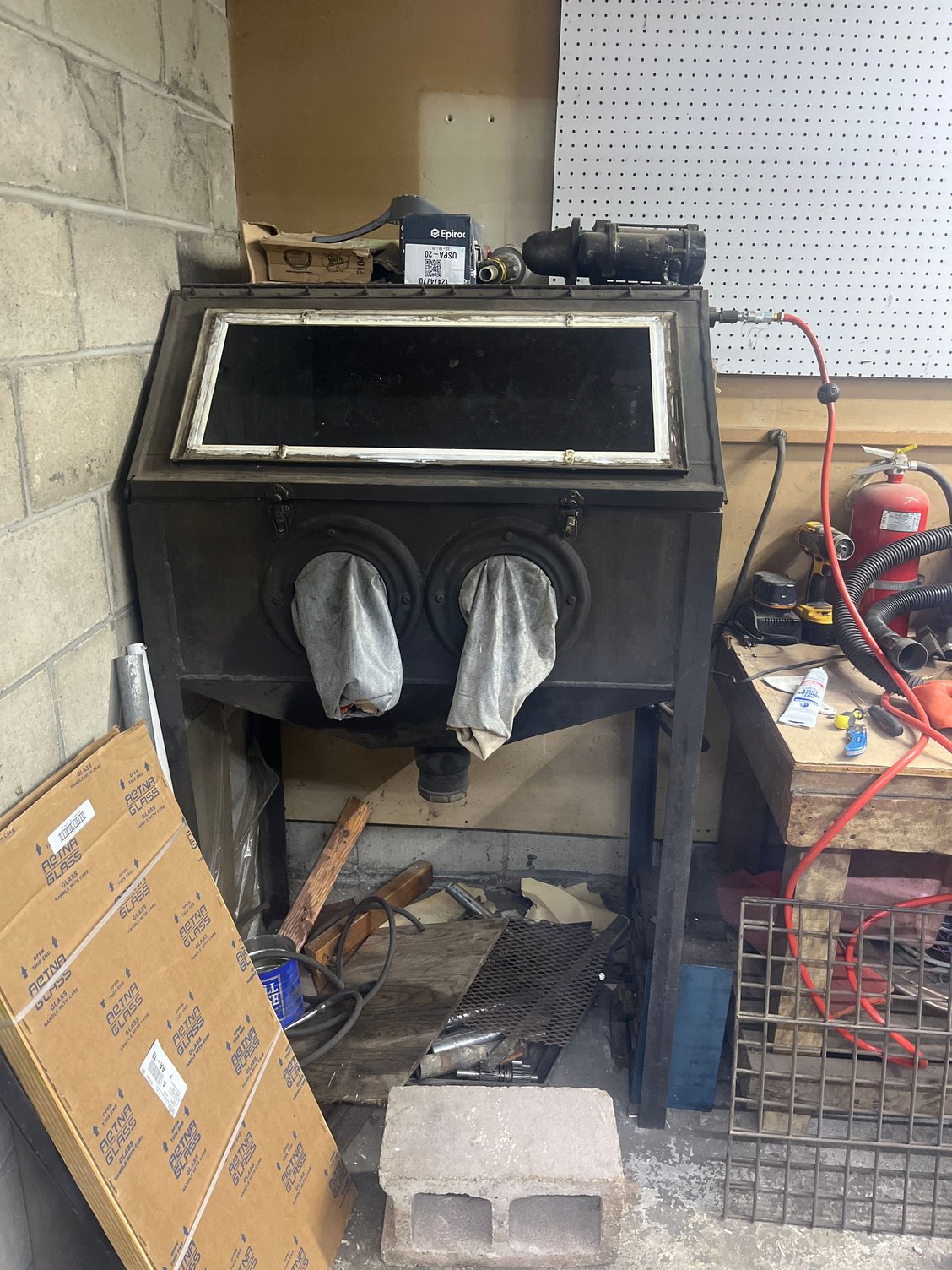

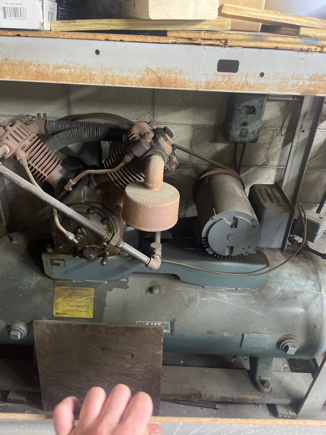

Can’t lie I know nothing about sandblasting cabinets. This one came with our shop and I haven’t messed with it for the last three years until now. Our shop used to be a motorcycle shop where the guy specialized in triumphs and bsa, as well as others(he was in a lot of magazines and world known) I have no idea how he had it set up and can’t ask, cuz he’s passed (god bless). I’ll post a couple pics
Cabinet with new glass lol
Compressor I think that ran it (also came with the shop)
Only inlet and outlets I see, larger pipe is where I put the shop vac on…. Won’t be doing that again lol
