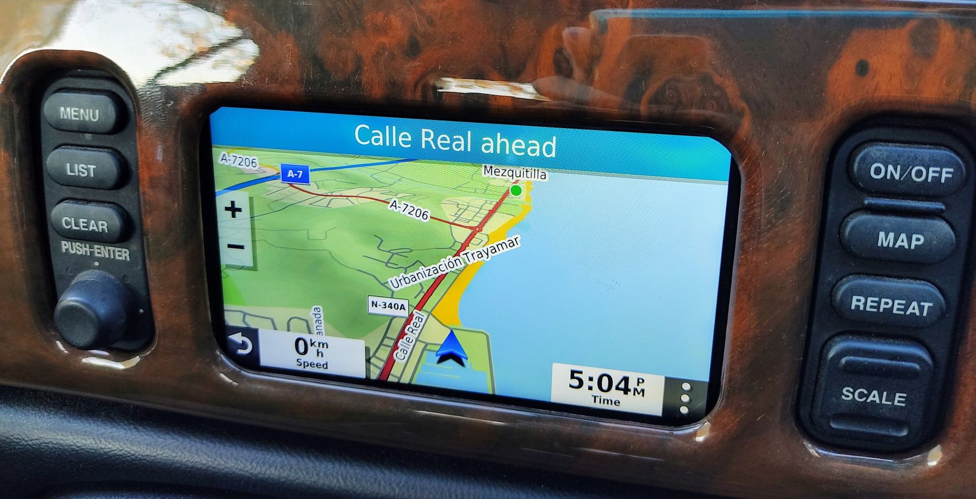

There's the upgrade option. Drove an 06 w/ SAT NAV that had a Garmin unit installed. Yeah it's not "OEM" but looked good and was a lot more functional. Still a classic 3 gauge fan w/ Real Gauge updates.
The Garmin Drivesmart 55 is a very good fit, albeit slightly smaller than the original screen. It has many new features the OEM sat nav lacked, plus WiFi map updates, including speed cameras.
Garmin also do a 6" sat nav that would be bigger than the dashboard opening, just like the OEM nav was. I would try the 6" version if I was doing it again, to see if it fits.

Just looked up Garmin Drivesmart. Very nice and not that expensive. Bluetooth wireless, maps, live traffic, spoken directions, etc. Looks like a great option. It's a rechargeable lithium ion battery. How do you keep it charged?
How hard is the install?
All the connections you need to power the Garmin are already behind the sat nav at the wiring harness. I used the ignition switched 12v supply to power the Garmin's cigar lighter adaptor. The sat nav comes on and switches off with the ignition key.
The install can be as simple or as complex as you want. I glued the Garmin to the back of the dashboard panel, so to install it, you can just unscrew/remove the OEM unit and glue the Garmin in place. I also removed the OEM switches from the old sat nav and fixed them back in place along with the back light connection so they light up at night, but others have just covered the holes with fabric. If you search the forum you will find lots of threads with quite a few different installs, of varying levels of complexity, but its certainly no more difficult than switching to the 3 dials instead.
