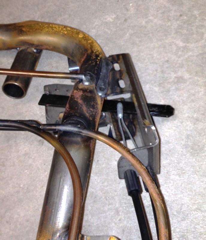

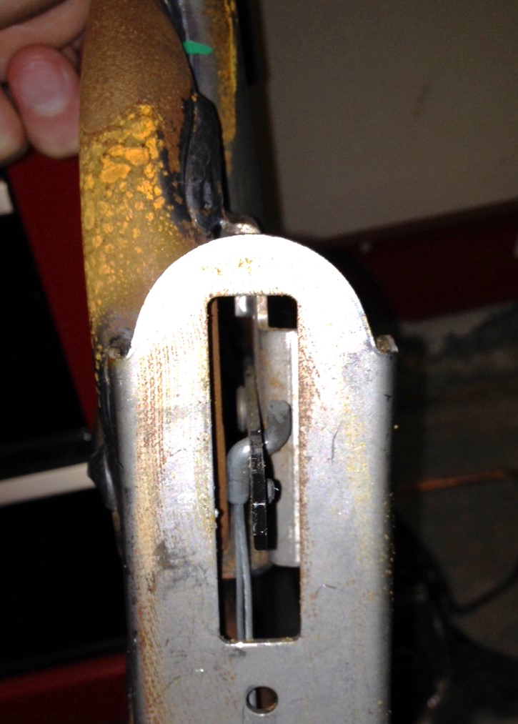

Not happened to me, but I've had the seats apart and happen to have a frame sitting here.
I tried to take some pictures of the mechanism so you could see how it hooks together. There are 2 cables attached to a single lever, one cable running to a latch on each side.
I'd guess that it somehow came unhooked from the lever rather than broke both cables at the same time.
It isn't that hard to take the seat skin off, just kind of a PITA.
Seat Release Lever-picture1.jpg Seat Release Lever-picture2.jpg Seat Release Lever-picture3.jpg

Thanks so much for the photos, that's a great help! I hope you're right!

Thanks for the photos, the cable at the bottom of one side had become detached, so only one of the levers that releases the top part of the seat was functioning. All fixed now!
