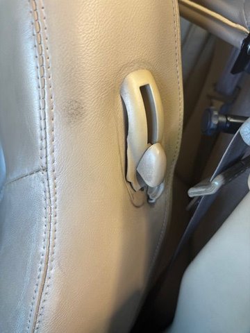

My driver's side seat release lever escutcheon is pretty much shot. I have found a few on line but people are asking around $100 for the things. I'm thinking this is something that can be made on those new fangled 3D printers. However, in order to take it off I have to get the lever knob off. I'm not seeing any pin or other device to keep the knob on. Can I just pull it off from the lever?

If I recall, lift the release and in the bottom, center, there is a metal tab that needs depressed while pulling the lever off
I fixed mine sometime ago. I’m pretty sure you’re right.

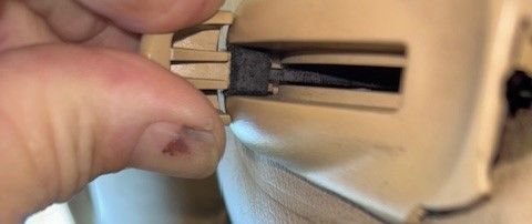

Here's what I found under the knob:
Are you talking about those 2 silver colored things just in front of where my fingers are?
Old Nov 29, 2025 | 06:07 PM
Posts: 25,875
Likes: 4,711
looks a bit different than mine but I will check tomorrow and let you know
