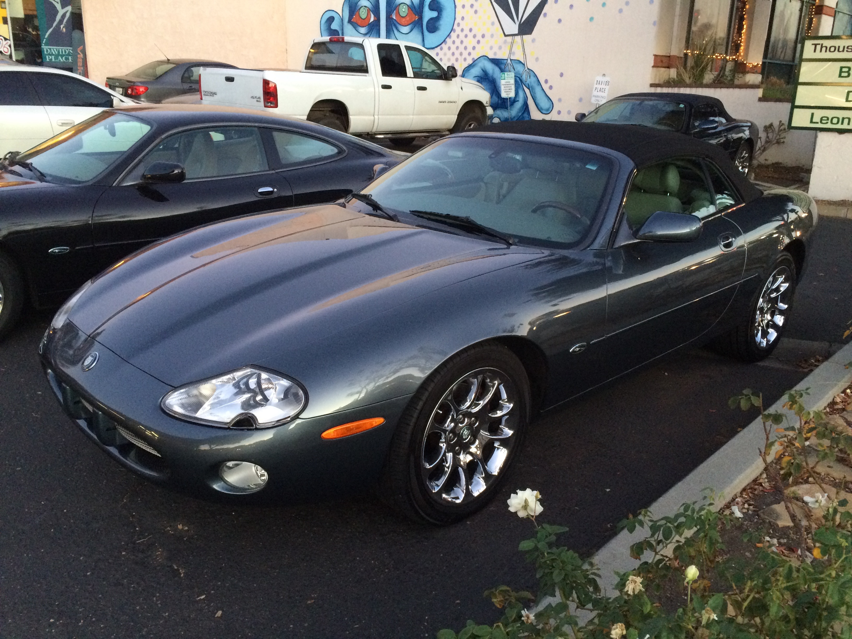

I hadn't used my 2001 XK8 for three weeks, got in and it started first time, I drove to the supermarket, a coupe of miles. I came back to the car, used the remote to open the door, key in ignition, nothing! Error messages scrolling on the dash, "Engine in fail safe mode", "Traction control failure", etc etc. I waited 20 minutes, tried again, the car started right up! Any ideas? Security control module perhaps... Any help appreciated...
