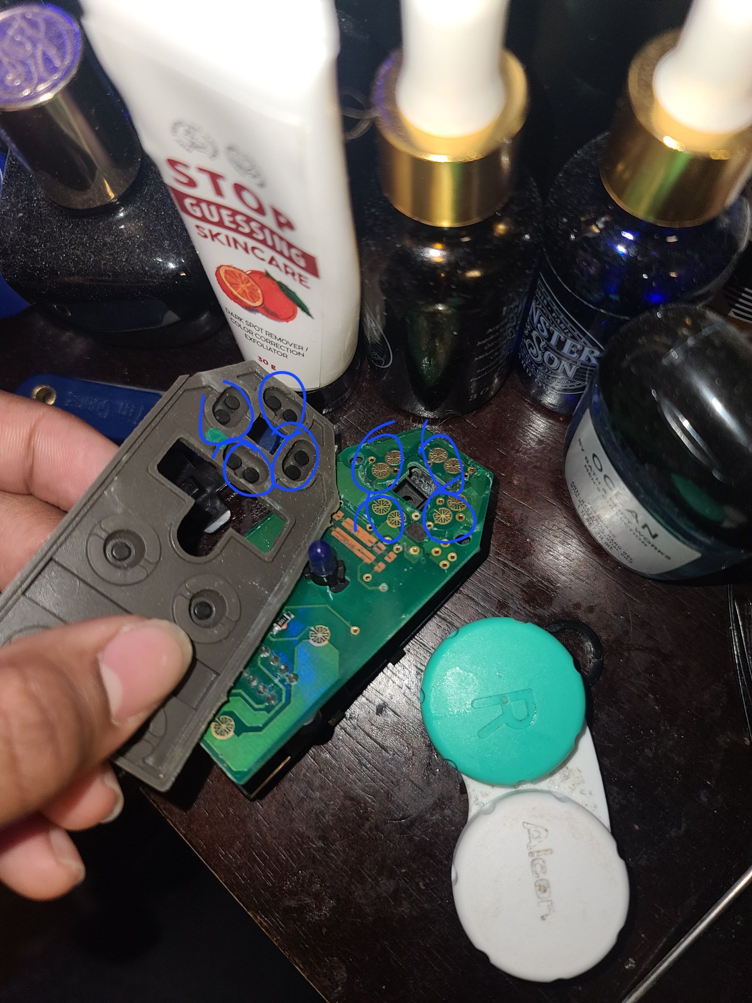

Just an update/resolution I made to the problem. Despite the discouragement to dismantle the switch pack. I did it anyway, I have gotten two from a junk yard but both felt even worse and since my wire harness is glued to the switchpack I decided to first take apart the ones from the junk yard to see how they are assembled.
Compared to other devices I've worked on, (Nintendo switches, PlayStations and steam decks) this was a piece of cake compared to those to dismantle clean and assemble. At least to a technician. To a diy'er for a first time it would be a bit frustrating. But for the ambitious-
-First you want to hold it upside down(keep it this way the whole time)
(​​​​​I had to do it with the wire connected but if you can remove it it's easier.)
-Use a flat heat to remove the plastic clips from the body
-Carefully take it apart and take pictures of how it was assembled and remove the rubber panel, the plastic and you now have access.
-Clean the button point on the board, it should be a goldish/Cooper looking circle with a cotton swab dipped in isopropyl alcohol. And also clean the rubber that makes the connection to it. In my years of working on controllers, it matters as well. Then reassemble and it should work fine.
Just be sure to put the rubber in first before the board, if you do it with the rubber on the board it will fall out or not sit right.
While I was doing this I also changed the switch bulbs to led, much brighter now and completes my car's look.
Thanks for all the responses! I hope this helps! Remember buying these parts won't come new they still need to be refurbished if the seller didn't do it themselves.

Yes, the switch that controls the mirror is what you're cleaning. Since I still have the two from the junkyard with one being dismantled still I can provide a picture.
After years, it's common for dirt and grease to make it's way in and disrupt the contact points. Just like controllers and other old devices. I just knew it was mine after I thought about the way it would not work, I'd have to click down multiple times till it made contact.
But do bare in mind. It's somewhat delicate when putting back together so be prepared to improvise a bit before clicking the peices back in if you haven't done something like this before.
Most people just replace it, and I'm sure the replacements work better mostly because the cars it's stripped from are garage kept or low miles.

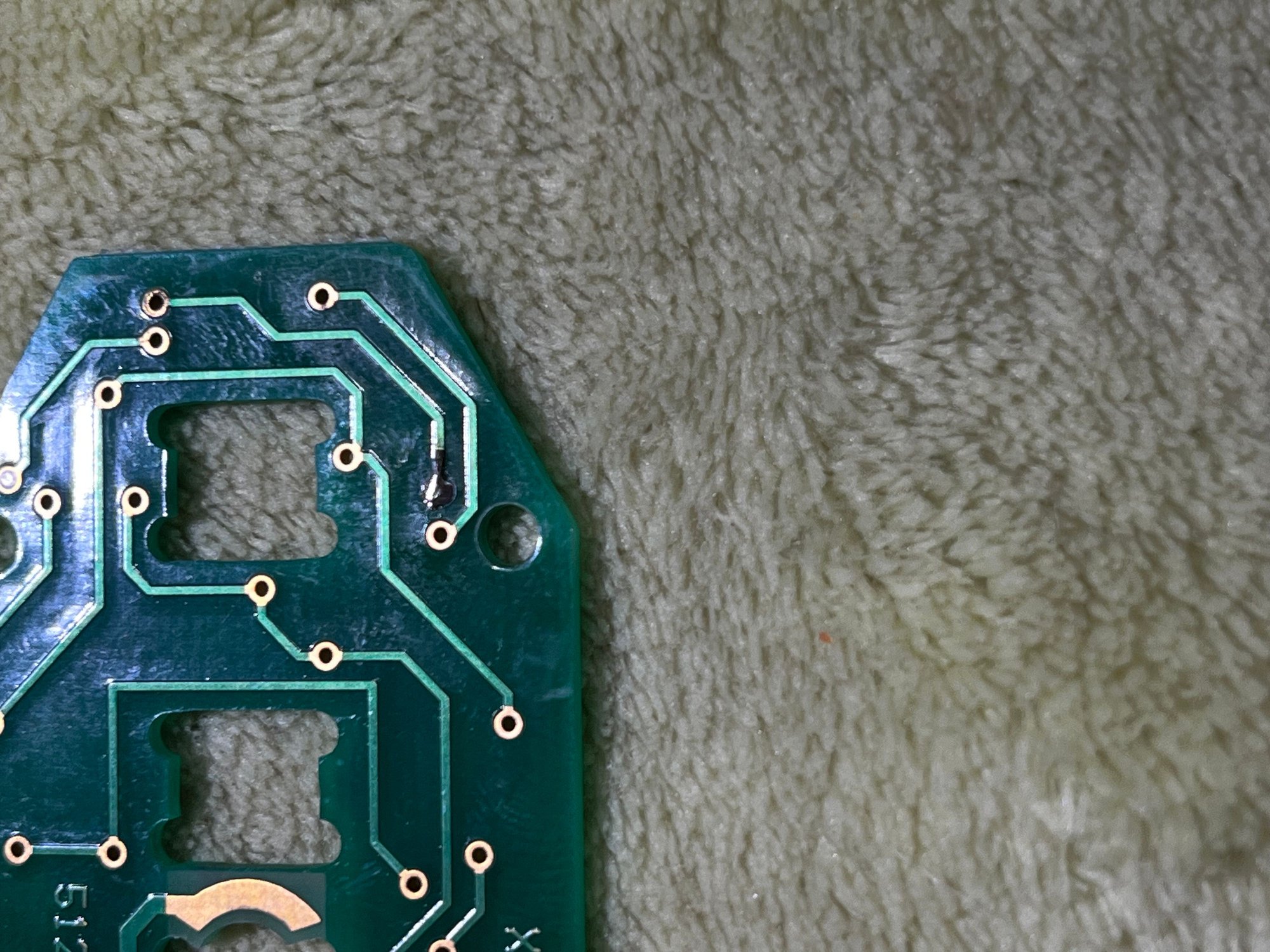

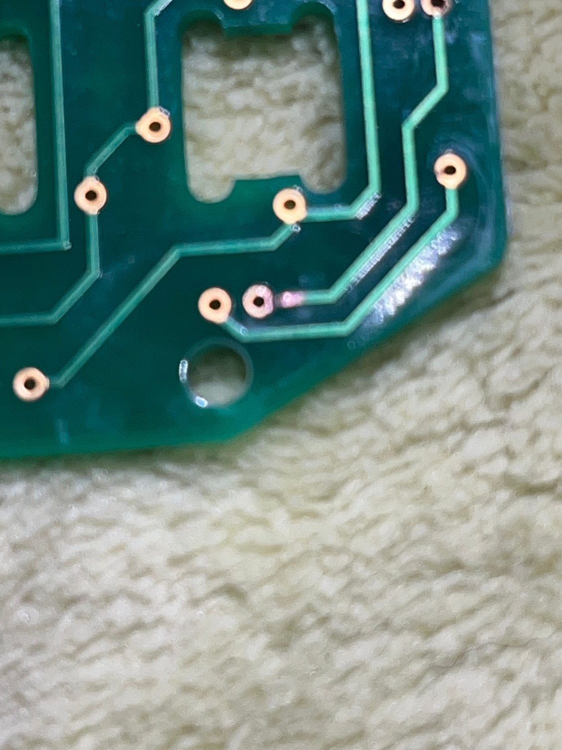

Well it’s 330 am and I can say that with your help I now have full function of both my mirrors with the driver door switch. I took your advice and took it all apart and cleaned it and used a pencil eraser on the gold contact points(I actually learned that trick fixing a Nintendo nes) and cleaned rubber pad and everything. I reassembled it carefully, tried it and only had up and right functions on both sides…a step in the right direction either way.
took it back apart and cleaned again, then went over it with a magnifying glass and my multimeter checking every trace I could, and lo and behold I found a broken trace in the pcb, no continuity. Scraped green coating off of trace slightly and soldered in a tiny piece of copper wire to jump the break. Cleaned it up again and reassembled, reinstalled and bam, all functions work, both sides. Couldn’t be happier, thanks again for the info and pics helped a lot.
Old Apr 12, 2024 | 02:38 AM
stevis05's Avatar
Joined: Jan 2009
Posts: 317
Likes: 145
From: new england
Broken trace scraped ready to solder, very hard to spot with naked eye
Fixed trace
