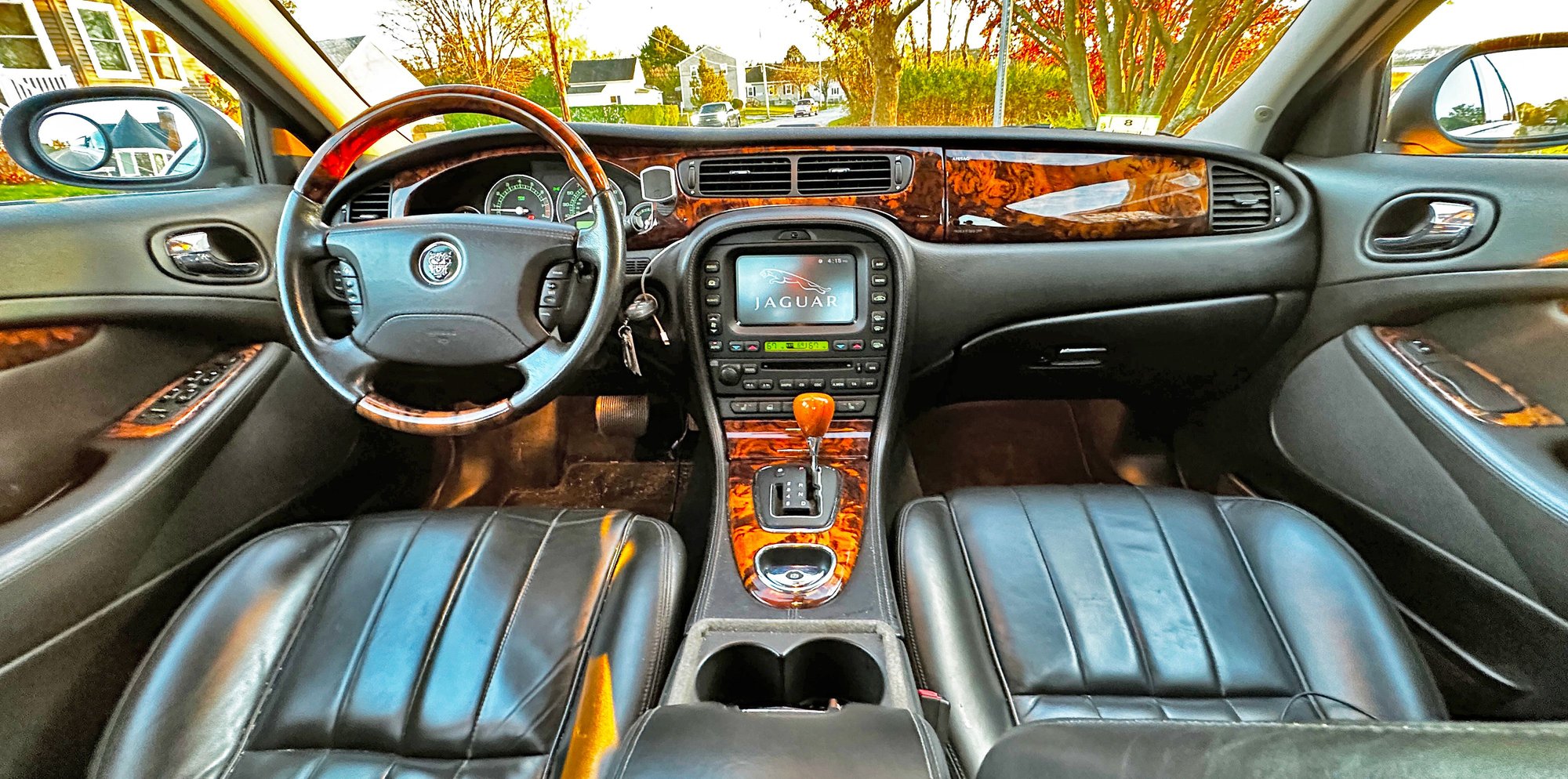

Can't help you with the mirrors but I love that interior!

The wood on that particular interior is really nice. That is what is cool about having wood trim, every car is different.

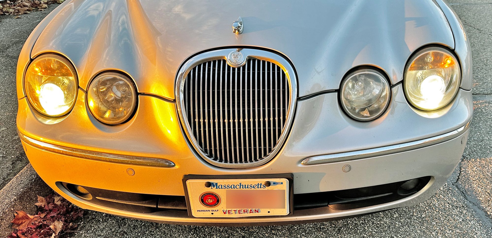

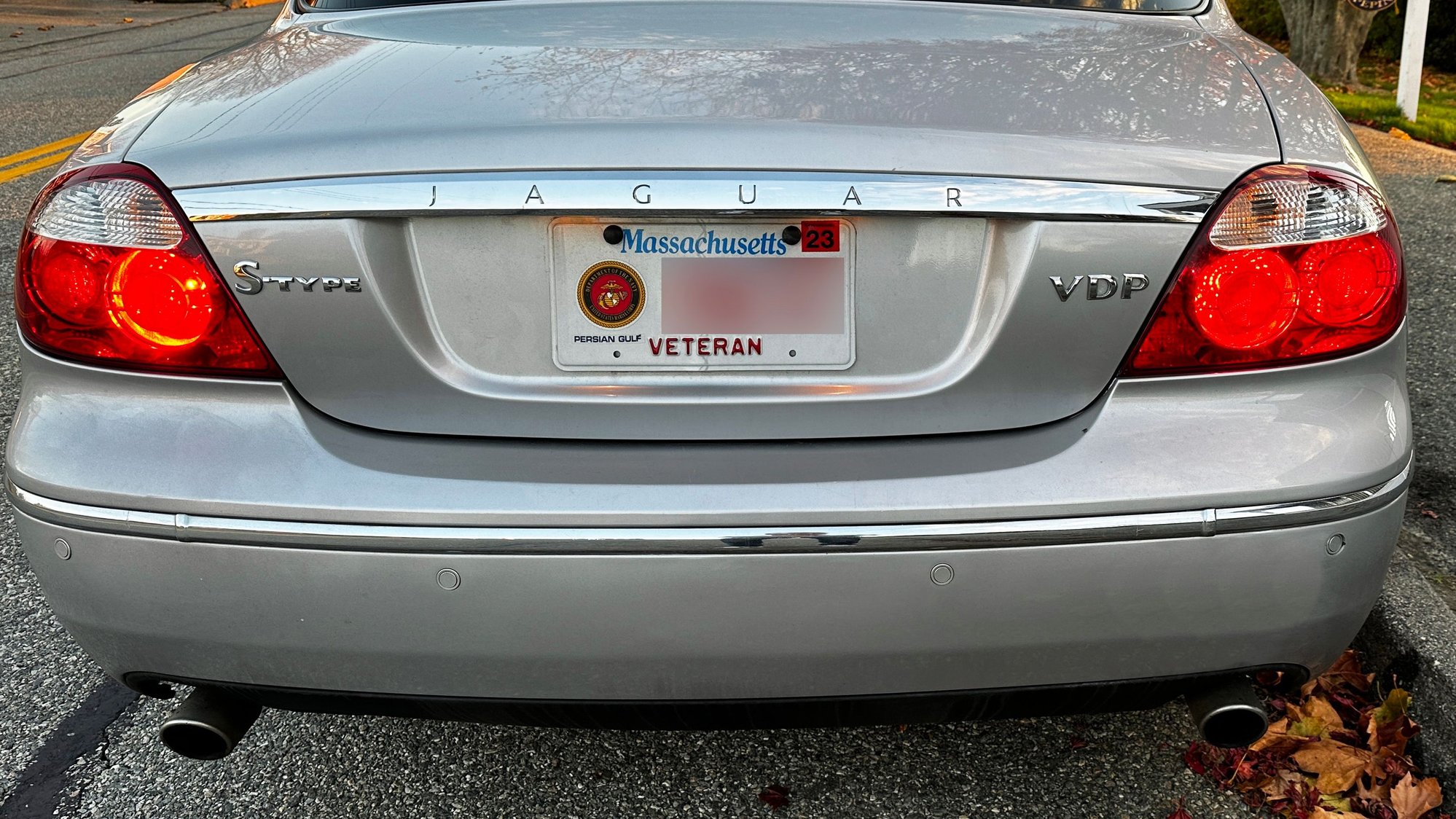

I just noticed your license plate, thank you for your service.

Thank you for noticing and caring. I appreciate that very much.

I know, I was impressed with the car when I saw it on the showroom floor, but silver isn't my go-to color. But when I opened the door and looked at the interior wood, I was hooked. I drove it away and hour later.

Oh I thought veteran was referring to the car. I had wondered why such a modern classic was classed as veteran🤣.

Wow. The USMC Seal and "Persian Gulf' didn't give you a clue? I guess they don't issue 'Veteran' Plates where you live. BTW, if it referred to the car, the plate would say 'Antique' or 'Vintage' depending on the state.

No, they don’t have different plates for war veterans in the UK. Our number plates are very plain and boring, as mandated by law🙄. If you jazz them up the coppers pull you over for a scolding. I must confess my ignorance; what is a USMC seal? I didn’t even notice the ‘Persian Gulf’ writing. It is so tiny it looks like a blur on my phone screen.

United States Marine Corps "Globe and Anchor"...

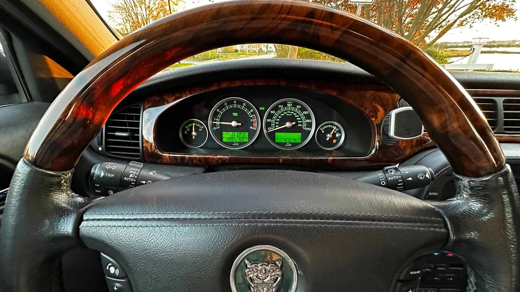

FhvnEd I was thinking that the big interior shot was very clear and crisp, then I checked your biography on the forum and I saw your profession was photographer, that explains it!
