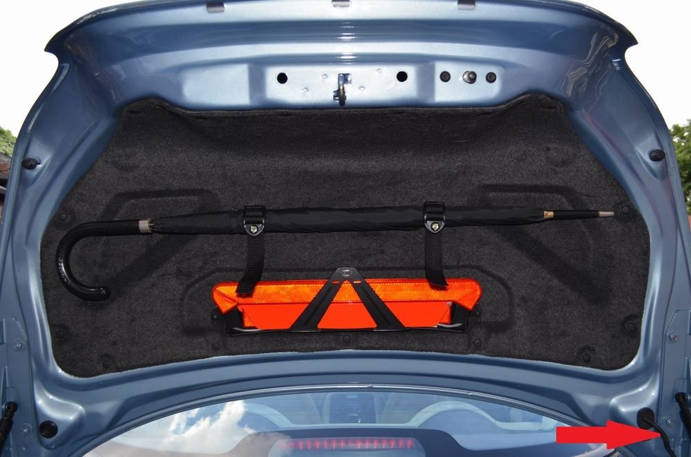

This is my 2005 XK8 Coupe (I don't have a photo of the open luggage compartment of my 2001 XK8) to show the harness (bottom left arrowed in RED:
Continued flexing with opening and closing the lid over the years can cause breakages in this harness. The cover has to be stripped to check individual wires.

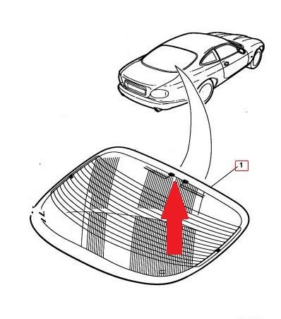

A regular cause of the fobs suddenly stopping working for no apparent reason is the press stud lead connector coming off the aerial on the rear screen:

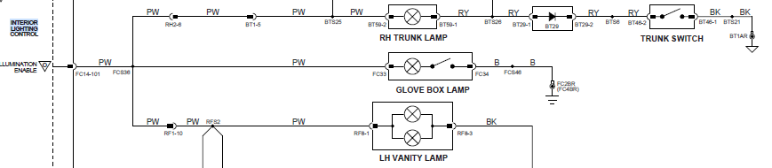

Here's the feed path from BPM to the boot lamps. If your vanity is intact then the BPM is outputting what it should.
