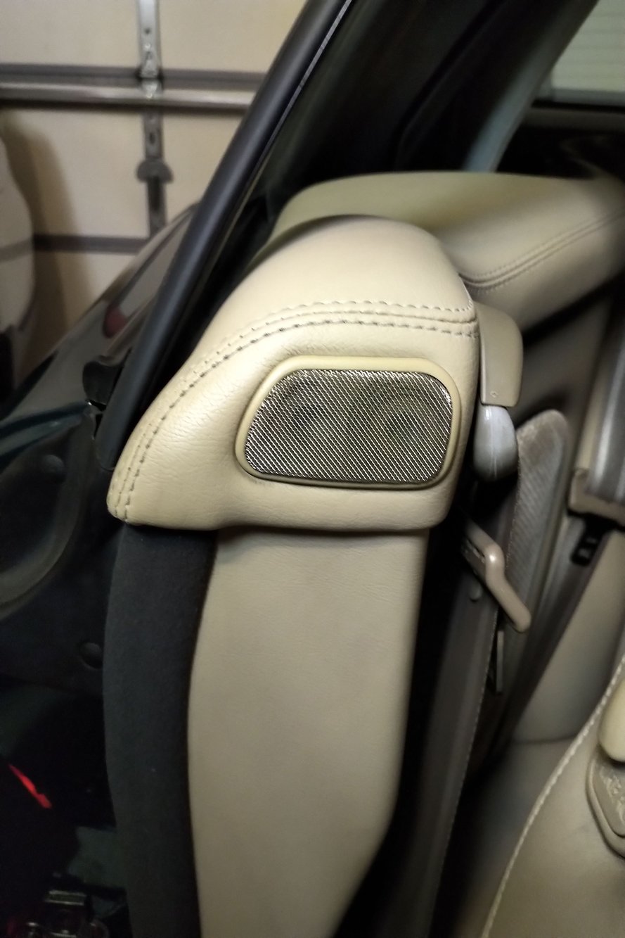

Who can tell me what these screens are on the passenger side of my 2002 XK8 Convertible

Aftermarket speaker additions. Looks like they did a real nice job BTW. 1st photo- interesting position, might be really good choice.
2nd photo, I can't figure where the camera is showing.
John

The second picture is the A-pillar on the passenger side.
When the audio system is on no sound comes from them. I even placed a stethascope over them. Nothing.
Odd they are only on one side of the car.

That's because they are not speakers of any sort. They are, and someone more knowledgeable please correct me if I am wrong, passenger seat occupancy sensors. These help determine if the airbag will deploy for the passenger.
John, my 04' coupe also has these. The A-pillar one is identical, the rear one on mine differs because of it being a coupe.

Those are the ultrasonic sensors for the airbag enable / disable. Lean forward in the passenger seat and the air bag light on the dash in front of you comes on, that's how it knows.
Find a young person and have them sit in the passenger seat, they will be able to hear a high pitched ticking sound.

I have a coupe like you and I don’t hear anything in the drivers seat, but if I sit on the passenger side (rare indeed) I can hear a light high pitched ticking from the B pillar sensor behind me when my head is turned the right way.

They are not speakers or any sound systems related. That are Air bags sensors.
