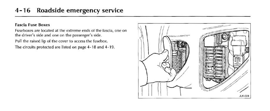

Well, I found the fuse in the trunk, boot, and it is fine, but I could not find the fuse box on the passengers side. It doesn't seem to be out in plain sight. If anyone knows exactly where it is , please let me know. I hate driving this awesome machine with no radio.

...... I could not find the fuse box on the passengers side. It doesn't seem to be out in plain sight. If anyone knows exactly where it is , please let me know. ......
There's a colour coded plastic cover over the Fascia Fuse Boxes. LH one shown in this illustration:
The fuse positions are numbered but you need good eyesight!
Attached Thumbnails So Awesome...........But...The Radio - RESOLVED-fascia-fusebox.jpg

Thanks Graham,
I'll look again tonight, is the box under the dash or between the dash and the floor?
I couldn't find it yesterday, but your illustration will help,
Thank you
