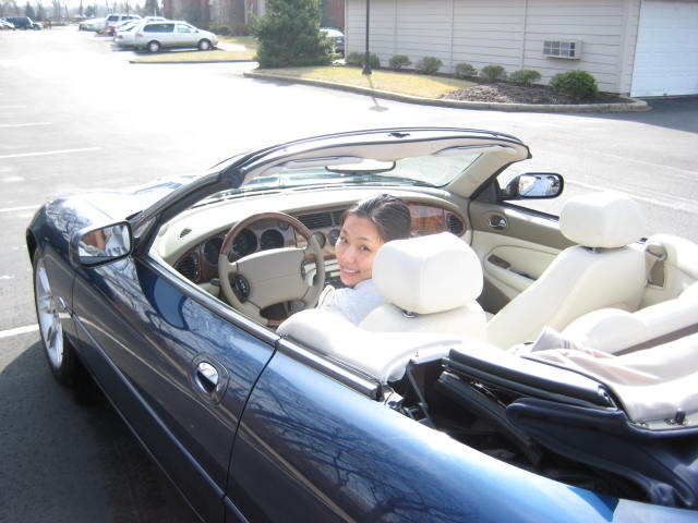

Well, my wife and I picked up the XK8 this weekend (well, she drove it home while I drove the "chase" stationwagon). It looks fantastic. It's still hard to believe it's now in our garage. Driving it still needs a little getting used to, particularly it's wickedly long hood; we've only owned compact cars.
Originally, I was looking for a well-aged roadster, thinking to spend no more than $5k. I was originally looking at Miatas and MG Bs before the interest went to Fiat Spiders. Then with the pending tax refund check, I started looking at Honda S2000's. Although I always thought the XK8 was a beautiful car, it was never on my radar because I didn't believe it was within my budget.
But then I saw this XK8 at a price that was way too good to pass up, perhaps due to the frigid temperatures and, of course, the economy. The price was comparable to a S2000. So I went from my original idea of fixing up a neat tidy roadster to owning a GT car. Really, never thought it would happen, particularly knowing my place in the social strata.
Anywho, the XK8 does have a few issues. It shakes at low speeds and around bends which I attribute to the car needing either a tire balance or an alignment. I'm crossing my fingers that it's not suspension. Also, when the top is down, the soft fabric lining flaps in the wind, which I don't think there's a fix except to put the cover on. I'm surprised it flaps so much out of the factory. I expect all that turbulence would eventually rip the lining. I'll be scheduling a diagnostic with the local Jaguar dealer to have the car checked out for any other issues. Hopefully, there won't be too much to fix. The prior owner did have the Select Warranty up to December 2007. Hopefully, certain major repairs were done prior to the warranty's expiration.

Congratulations on your new baby. The $2,500 warranty for a single year sounds very steep. There are a number of aftermarket warranties that will cover two or three years for that price so shop around. The headrest fix should probably be done for free by the dealer but, if not, it ends up being a fairly easy do it yourself fix.

Hmmmm.... I think I see a problem with your new car. Depending on the angle... I think I see a smile on the driver that doesn't seem like it will be going away anytime soon. You may end up driving the wagon....
Nice car!!!
Nice car!!!
