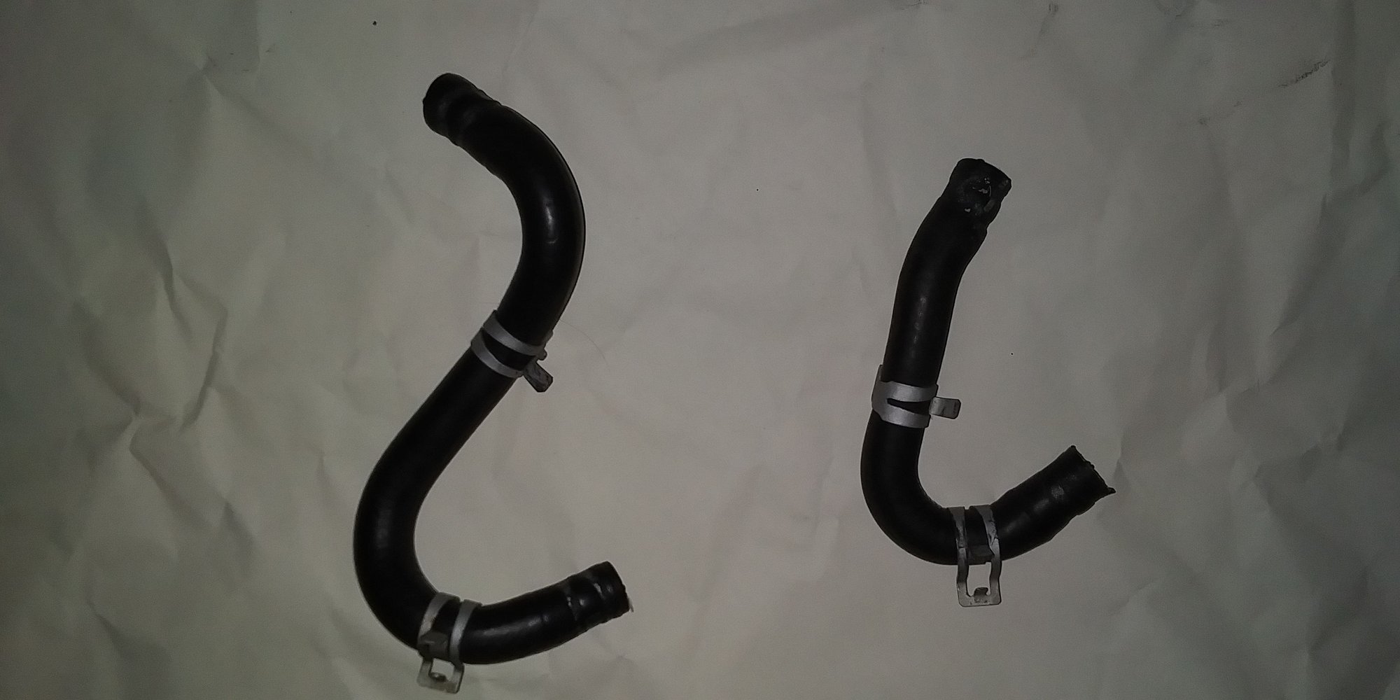

Question Source for Throttle Body Heater Hose
I need the heater hose that goes from the Tee fitting behind the driver's head to the top of the Throttle Body. (I think this is the Throttle Body Heater Return Hose.) I ordered the only heater hoses I could find for the '97 to '02 4.0L engines but neither of the Throttle Body heater hoses matched the ones on my car (see image below). I need the longer of the two hoses shown. I can't find any hose that resembles this from any source. I can make a piece of 'straight' 3/8" heater hose fit but it will wind around behind the Throttle Body and be far less than satisfactory.

The AJ26 and AJ27 coolant hoses are different.

Don't understand. I have an '02 with the 4.0L. Which version of the motor does that make it? And how does that help with parts selection? All of the '97 to '02 4.0L parts SHOULD be the same. Why are they not and how to I find the correct parts if the only thing the parts sources ask for is the year, make, and model?

I would recommend you take a look at www.sngbarratt.com website and download the catalog for your year vehicle. The 2002 XK8 has the AJ27 engine. You will find they have 3 different catalogs depending on year. I think you need the 1999 to 2002 catalog
Sounds like you have the 'hot shower' dealer option
That part changed with the intro of the 99MY / AJ27 motor.The # for the hose on the left in your pic. is NNE3976CA.

I don't believe this is the correct hose:
From JagBits website:
COOLANT HOSE FITS 1999-2003 XJ8 XJR, 2000-2002 XK8. From expansion tank to 3-way connector (NNE3976CA)
It's also the wrong shape.
Thanks for the suggestion though.
I may have disregarded your suggesting prematurely...
I used the 'chatbot' feature at SNG Barratt and sent an image of the hose I'm looking for. They also think it's the NNE3976CA hose. So I'll but one and hope for the best. The worst thing that can happen is that it won't fit.
I did check the barratt webpage. The part they list for the '02 is the wrong shape (it's 6" too short.) I purchased the part they listed and when it arrived I knew it wouldn't fit.

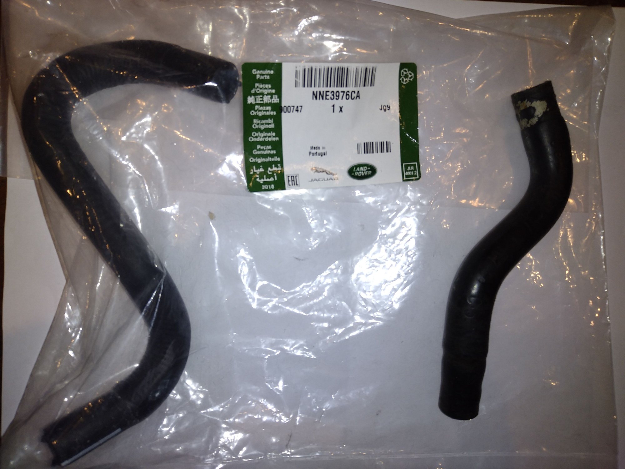

Here's the bagged one I have, which looks very much like your first pic. A tape measure shows the length is ~10"
On the right is the correct one for my 98 AJ26. NCA3976AD. It's ~6" long. The part #s are similar.
What doesn't help is that ALL the parts diagrams (including Heritage) I looked at picture them as being the same shape (as on the right). JEPC does at least give the correct part numbers.
As I look at the two hoses it seems the bends are correct so I was wondering if the left hose can be trimmed to match the original house?
As I look at the two hoses all the bends look correct in the new hose so I’m thinking you could trim the new hose to the proper length.

Thanks,
I guess that would work, although my goof was during the winter PM cycle at the beginning of last year so waiting for the correct one didn't hold anything up.
I hate throwing serviceable stuff away, so I've put it on one side in case someone ever needs one ( I have all sorts of bits and pieces like that, sigh)...

I received the hose yesterday and the shape does look correct but it seems about 4" too short. I need to fiddle around with it behind the TB before I'll know for sure.

I checked the hose over the weekend and it does look like it is the correct part. Yea! Now I just have to get time to install it. Hopefully when I replace the valley hoses.
