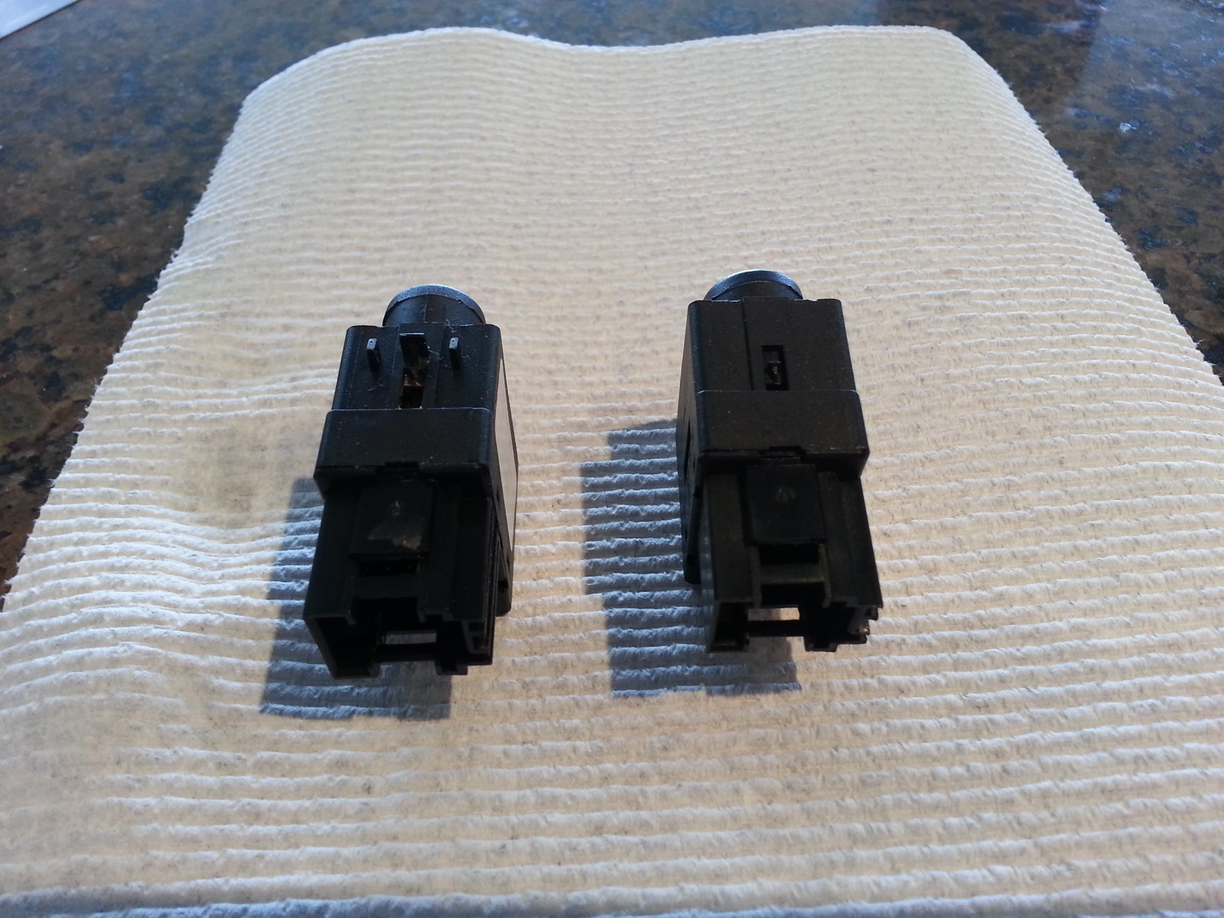

After installing the new mode switch to the shift plate, it plunged down into the console when I tried to use it the next day. Upon removing and more closely inspecting the new switch, I noticed that there were no mounting tabs on part of the housing, which is why it slipped down into the mounting hole when I tried to operate it.
In the picture, the switch on the left is the original, and the one on the right is the new replacement. They are identical in every way but for the new one lacking forward mounting tabs. Perhaps this is a factory defect?
Since the new switch works as it should otherwise, I've resolved to use a mild glue to hold it in place versus trying to exchange this part for another. They are both made in England; no Chinese copies from what I can tell. I will not make any more jokes about British electrical components or quality control - although I'm tempted to.

Maybe you received a part that was previously returned ans put into stock without close examination. But then, you didn't buy from Home Depot either.
It does look like something should fit in that hole.
I feel your frustration, can only offer my wish of good luck.

It is weird; the part fits the hole but there's no tab to hold it in place. Even in a different application I'm not sure how the switch housing would stay mounted. It works but for $140 it shouldn't require a dab of Shoe Goo to make it stick. Oh well...
Not sure, but I am thinking perhaps the mouting scheme of the part changed when they went to the metal bezel in 04.
