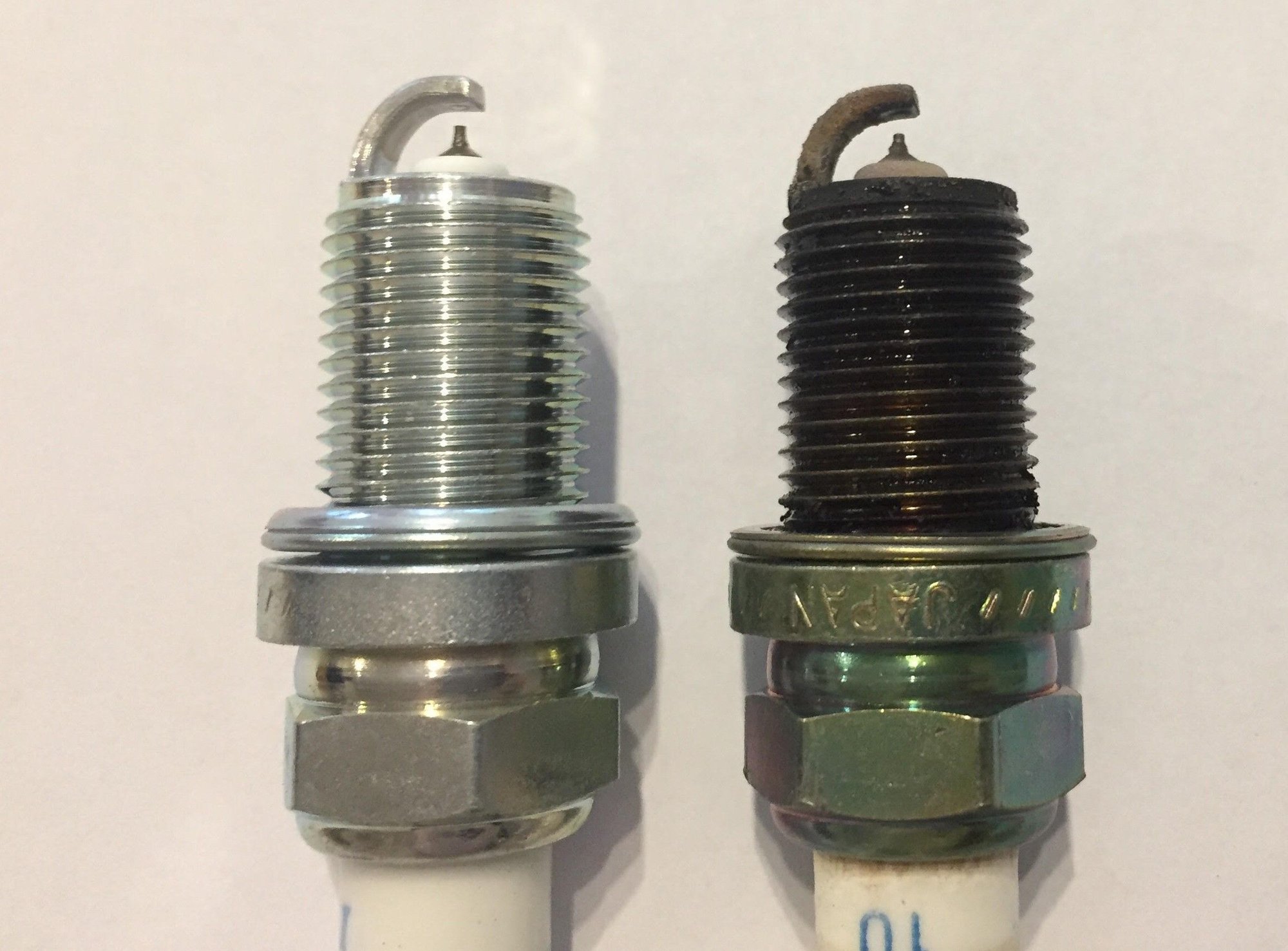

Good afternoon. I have checked the plugs today(which were all on the loose side) and looking at them wondering if at 100,000 miles these could be the original plugs. I have ordered a fresh set, but i do not know the torque setting. It would be much appreciated if someone could tell me the correct torque for the plugs. Many thanks. Anthony.

Your plugs likely have steel threads which are going into an aluminum head. When the engine heats up, the greater expansion rate of the aluminum precludes the need for extreme tightening.
the plug threads should have a very small schemer of anti-seize on them. Tighten them snug with the engine cold. Removal of the old plugs should also be done on a cold engine.
I believe the manual calls for 18- 22 ft lbs or 25-29 NM, with the larger number being for new plugs.
i would be extremely cautious going over 15 ft lbs. I tighten spark plugs by feel, and have never had one come loose or have the threads strip. Less torque is better when dealing with alloy heads and steel spark plug threads.
I’ve had to repair a few hundred heads that had stripped spark plug holes due to overtightening.

I also tighten spark plugs by feel, being extra careful as I have a tendency to overtighten nuts and bolts. Been doing it that way since the late 1970s and have never had a spark plug issue as a result....

I also changed my plugs at 100,000 mile service. They looked so good that I wondered if it was necessary. I changed them anyway. Used on the right....

..... I tighten spark plugs by feel, and have never had one come loose or have the threads strip. Less torque is better when dealing with alloy heads and steel spark plug threads. .....
Originally Posted by Jon89
I also tighten spark plugs by feel .....
Me too.
That way you can feel any unusual resistance indicating possible thread damage in the head tapping and the 'bite' as the crush washer contacts.
