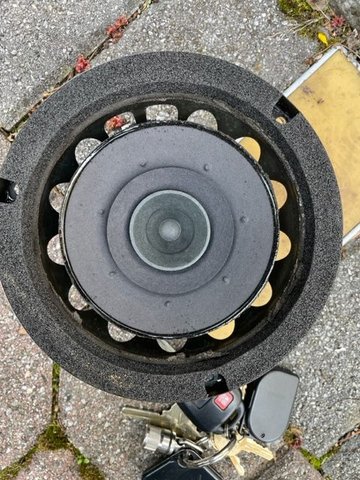

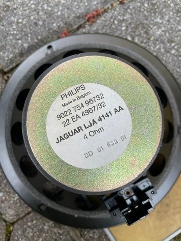

Here is an update.
No premium sound. Speakers at the bottom of the doors and in the back. I believe the correct wiring diagram is below:
Speakers are 4Ohm and foam completely deteriorated:
I am planning to get a set of four Kicker 43DSC6504 6.5" 240 Watt 2-Way 4-Ohm Car Audio Coaxial Speakers available on Amazon, but welcome any recommendations. Good frequency response 40Hz-20kHz, seem like a perfect feet. A head unit recommended above maybe a next step, will see..
When I removed the speakers, a mystery object fell down, is this related to the door mounts? I never removed the doors before.
Thank s everyone.
Old Apr 7, 2023 | 10:16 PM
Johnken's Avatar
Posts: 5,457
Likes: 1,816
From: New Jersey USA
Its probably for the speaker's grill. No big deal. Its too late at night for the old brain to remember the items name, but it slips over the edge of sheet metal thats right next to a small hole in the sheet metal. Allows a sheet metal screw to thread onto something.
Picture a 6 inch hole for speaker. Six 1/4 holes evenly spaced as satellite locations around the speaker hole half inch away. Slip the fastener in photo over the small holes - gives a nice strong threaded mount for the screws to hold speaker in. That's just an example for you to picture how it works.
Wait! Come to think of it its probably used in the arm rest. Picture thar vertical area where the 2x4 inch rectangular leather(ique) cover presses on right behind the door switches. There is a sheet metal screw behind it that uses the piece.
John

Old Apr 11, 2023 | 07:30 PM
Throwback's Avatar
Joined: Jul 2022
Posts: 277
Likes: 161
Ahh, the pre-2000 cars are 4 ohm. Good. Much more choice in speakers then . Those kickers are great, those are the ones I have up front but in component form. I didn't find them bassy enough, but I can only assume you do not listen to The Prodigy as much as I do lol thus I added subs. Speaker choice has a lot to do with taste or my lack thereof. For a while I thought the stock audio sounded a bit meh, but then I realised it has great dynamic range for classical music or pop at reasonable volume and that I am just a chav who wants bone crunching bass.
