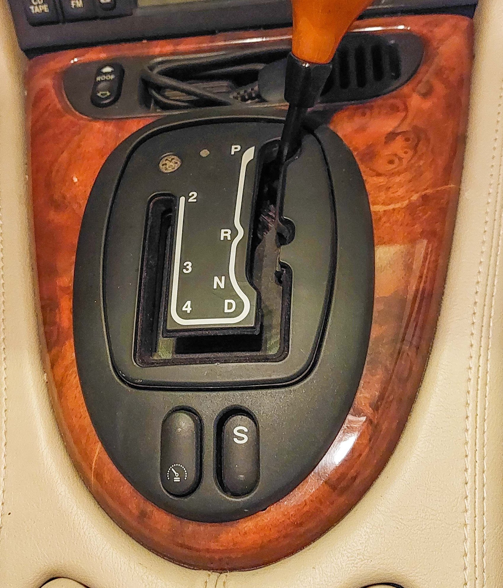

Hello. I have a 2001 XK-R Convertible with a Sport Mode switch that has become dislodged from the cowling. It still works but I'm not sure if the switch is actually broken (plastic lugs?) or just come lose. What I don't know is how to disassemble this area to get at it without breaking or snapping some piece of plastic. I have no idea what the structure looks like underneath.
I am in London, Ontario and would love to have a chat with anyone who could give me some advice in fixing this.
Dave

HiDave. Take a look at the sticky section under How to Videos. Look at the one How to remove the center console. You have to remove the section around the transmission J-Gate, and then you can see under Meath at the clip that holds the switch in place.

Thanks mate That helped me sort the issue and also explained why this switch was the way it was. A previous owner had been in there resulting in (1) two broken catches on the J-Gate bezel, (2) the switch being inserted upside down (1st photo) and (3), the lower catch on the switch was broken, probably from trying to put it in the wrong way. The ends are not symmetrical. His fix was to crudely tape the Sport switch to the Cruise Control one.
I will need to source a new bezel and a new switch. In the meantime, I cleaned things up, put the switch in the correct orientation and carefully but strongly taped it to its mate, the cruise control switch. Pure "bush mechanic" solution but it should hold for a while until I get the parts.
