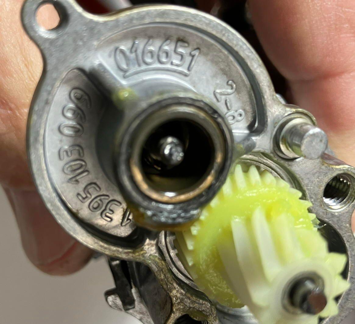

2001 XK8. so my steering wheel telescoping stopped working. The motor makes a noise like it is working but there is no movement in and out. Up and down work fine.
I was able to pull the column out of the car. Note: be sure to remove the footwell light before doing this, it impeded the removal.
Now I think I can connect 12 v to the motor terminals of the green and grey wires to activate the motor but nothing happens

The drive cable is broken.
The reach position sensor is faulty so the motor did not know when and where to STOP.
When you get it repaired, you need to disable the AUTO feature so the reach motor won't run the gears to the mechanical stop and stress the cable AGAIN.

well there was not good contact to the terminal, so motor works and it spins but no movement. if I rotate the cable butt at the end of the motor, the long cable coming out the other side does not rotate.
Cable sheared off within the final gear.

broken pieces
