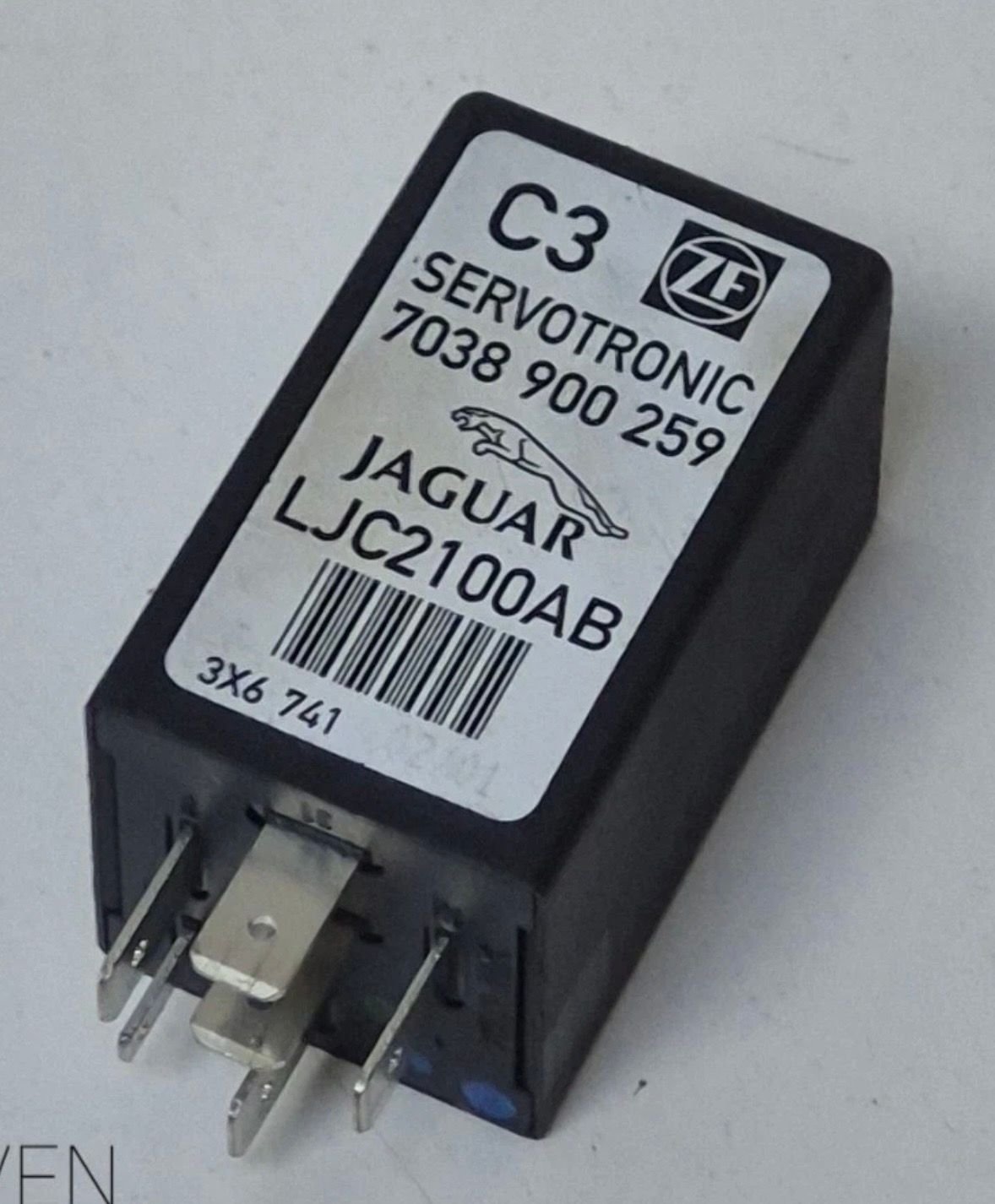

A faulty Servotronic relay will not generate any error code, because there's no data connection to the body processor module. It works only from a 12v ignition power and a speed signal. It's something that either works or doesn't work, it's strange that it causes that problem. In any case, try removing the fuse. If the mechanical parts are ok, the steering will be stiffer, but consistent and linear.
Good to know. Would the best way to troubleshoot this be as suggested above to unplug the sensor and see how the steering reacts?
If the sensor is not too expensive maybe just replace it anyway.
"The sensor" is a solenoid that increase the servo assistance at low speed, driven by the Servotronic relay (which isn't a relay but a little electronic control unit). Usually the problem is the "relay" itself, I replaced mine three years ago with a used one. So yes, you can try disconnect the solenoid connector on the steering rack and see what happens.
