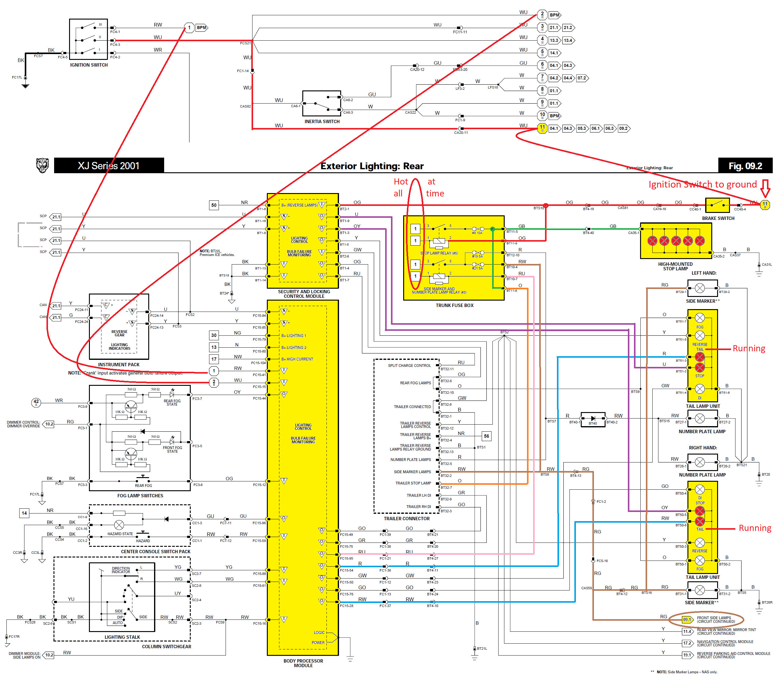

This is a very like wiring guide I made up to the X308 and will get the specific wiring guide to the X100 in the morning . Notice the difference between the brake light ( in purple ) and the running light ( in blue ) .

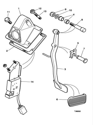

This is what you are looking for (item 14):
A real pain to change.

http://www.jagrepair.com/images/Auto.../jagxk2000.pdf.....see page 109
Very much the same between the X100 and X308 with the exception of wire colors . If you want to test the switch just bypass it by removing the black or green / black wire before the brake switch ground .
Note the adaptive dampening circuit can also give it a ground......see page 102
There is a error in the X100 wiring diagram on page 102 as the adaptive circuit should not have the mechanical brake switch in it . The brake switch is the primary device to signal braking and the adaptive is a add on .
