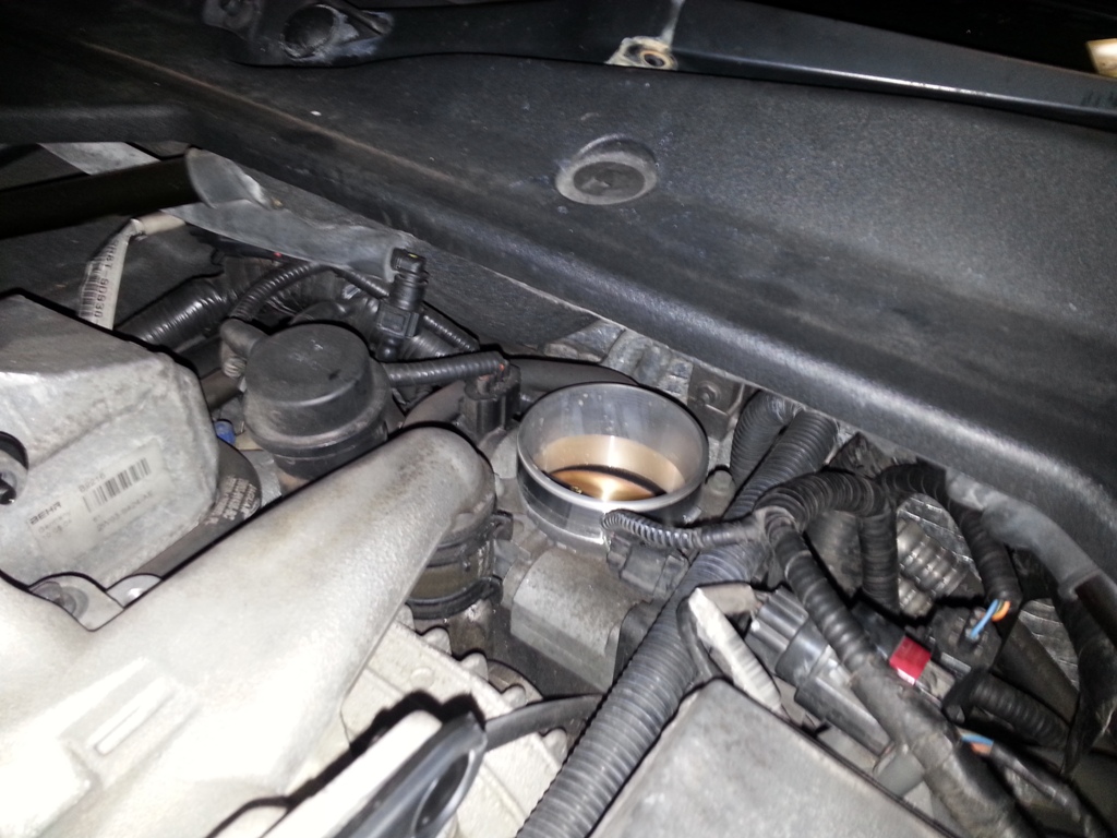

The X350 doesn't have the same "V8 Plate" as the XKR's & earlier X308 XJR's, but it's not too complicated to get a look inside the supercharger.
- Intake pipe/tube off, loosen the top hose clamp at the throttle body only.
- Remove the hose clamp for the bypass hose from the s/c to the throttle body.
- Remove nuts & bolts from the duct seals.
- Loosen the 4 bolts that hold the outlet duct in place (but don't try to remove them, they have captive nuts on the inside, if you completely remove them the nut will fall into the s/c, not good.)
- Wiggle the top plate from side to side to get the duct seals out.
- The outlet duct plate will just lift up from there.
Attached Thumbnails supercharger noise sounds like box of rocks-20131029_144240.jpg   supercharger noise sounds like box of rocks-20131029_143700.jpg   supercharger noise sounds like box of rocks-20131029_143043.jpg
