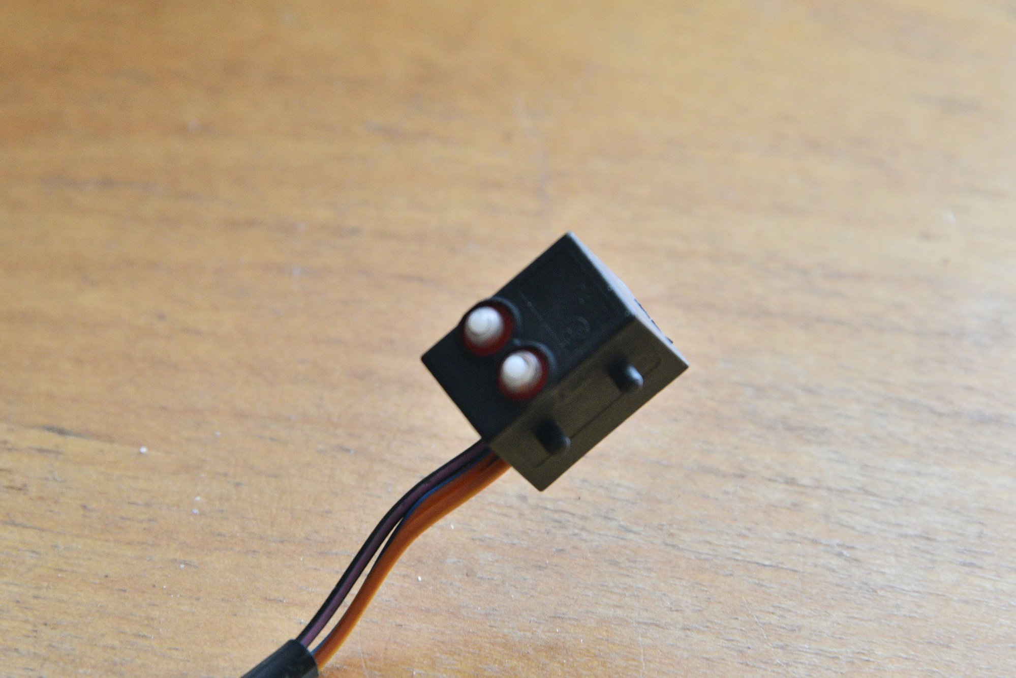

Changed the switch in the photo and its still the same,slightly shortened the rod from the door handle to the switch and no difference.

Looks like two switches sharing a common in one package.
I thought originally that the lock status and polarity-swop changeover switch were both external to the actuator, but it appears that only the lock status one is. There is also more than one location for that external switch. O&DR's video shows a single switch directly on the actuator arm, whereas in Gus' pictures it's located differently (at the opposite end of the mechanism to the 'door open' switch) and your wiring colours match his picture:
JagRepair.com - Jaguar Repair Information Resource
I guess (if the Electrical Guide is correct) that is the lock status switch, and only the Y and BK wires are actually used.
That would have been my first stop given that the door is unsure of its locked status, but you've replaced it... Could there be something mechanical obstructing the actuator movement?
