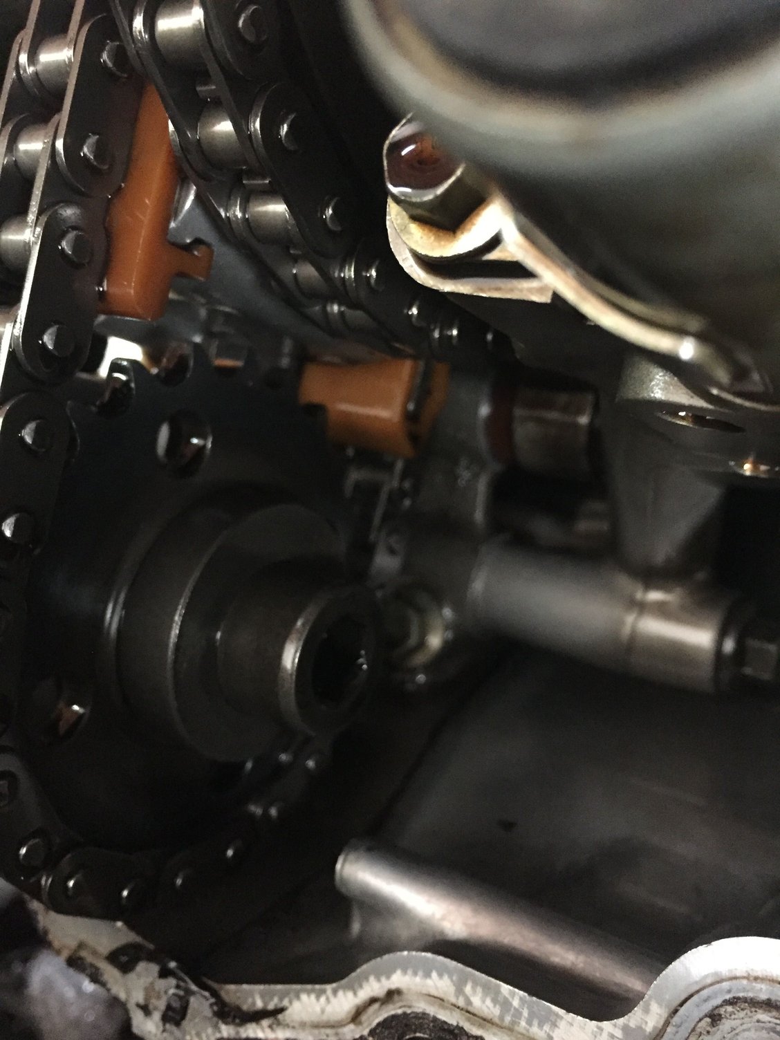

Thanks, a friend just opened up a 1999 and it had the metal tensioners. Must have been upgraded by a PO.

From: Bahrain
Default Same here - PO changed mine on my 1999
Pete,
Thanks to this forum, this was one of my first checks when I got the car. For ref, see pic below.
