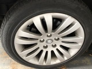

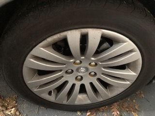

These are the tires and rims worn by 2005 XK8. They're pretty beat up (cracks on sidewall) and appear to be older Michelin Pilots. The date code is confusing: DOT 4M BA 001X: I think that means 4th month but which year? 2011??
Anyways, I'm going to replace them ASAP, but the question is, which size? All four are currently 255 /45 R18. I'm not conversant on the rims/wheels but they appear to be Jaguar, or with a Jaguar emblem in the middle, at least. Should I just replace with 255/45 R18 all around or put 245s on the front tires. Would those wheels even take 245s?
Any information or advice would be greatly appreciated.

Norm, l don't think what you reference is the date code. It is more likely the dept. of transport approval.
​​​​​​Date is generally a 4 digit number and may only appear on one sidewall of the tyre/tire. First two digits are week and last two the year.

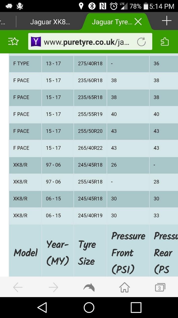

I think I'm the third owner, but the door decal says the car should be wearing 245 in the front and 255 in the rear. Someone along the way must've swapped out rims or just decided to put 255s all around. Am I damaging the car by putting on new 255s all around again, or should I be looking into getting new wheels to go back to OEM specs? Or will these existing rims take 245s on the front and 255s on the rear? Does anyone know if these are standard XK8 rims?
Edit: OK a quick search shows that these are one of the standard 18x9 wheels (Aris) that came with the XK8. Looks like it's fine to go back to 245 on the front and keep 255 on the rear - as specified on the door decal. Any idea why someone might want to go 255 all around? Just curious at this point.
Interesting. I was going to comment that the rims appear too wide for the tyres, but if they are stock then perhaps it's my dodgy eyesight. The rims should be different widths (I *think* 18x9 and 18x8) - i.e. slightly narrower on the front to accommodate the narrower 245.
If the rims are all the same width then that would account for the same tyre size all round. If not, it may be the tyre fitter didn't know any different? My car came with 245 all round on 18" staggered rims

Your Wheels are called: "Aris" and they were made for the 2003-06 XK8...It's 18" OEM Rim...They do not appear to be Staggered, therefore they are 8" Wide Front & Back....
You may use whatever size Tire that is shown for that Wheel on the underside of the Armrest Lid.. If the Wheels are all 8" Wide....You could vary the size from Front to Rear using a Wider Tire on the Rear.....for more Traction...but that is up to you...You would not be able to "Rotate" the Tires if you do this! You will be fine overall by just using the same size Front & Back....It's up to you.....Look in your Book or Under the Lid....

My '03 came with those rims, they are Jag OEM's but I believe they are from an '05 so the PO of my car may have changed them. But the car should have 8" wide in the front and 9" in back, 18" dia. all around, plus the stagger of the tire sizes. Go with 245/255 combo if you have 8" wide in the front. Someone could have changed them in a previous life so check what you have. Take a wheel off and look at the inner part of the wheel. I am looking for an 8" front rim as I curbed it a good one, DOH!!
