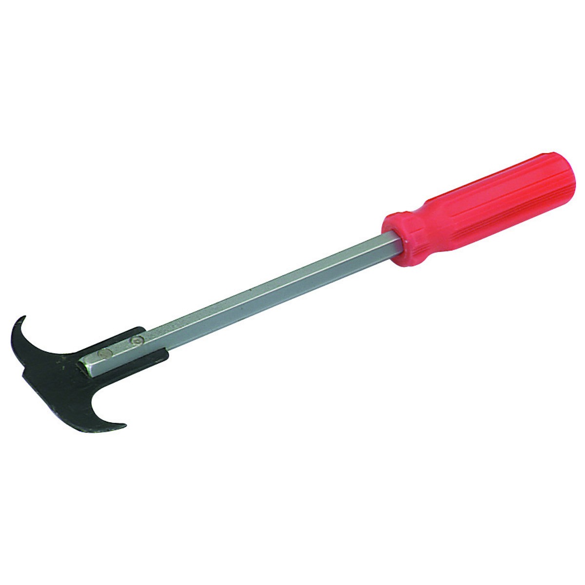

You should be able to squeeze a standard seal puller just take your time and be careful not to nick the crankshaft, that you leave you with a potential leak.
Good luck.

that is a sweet tool. I was able to carefully pry out the old one, now am putting in new one. I know the depth to re install new one just want to equally insert it in place. There is not alot of room as the engine is in car, did remove fan and radiator. any good ideas to seat it in properly?
