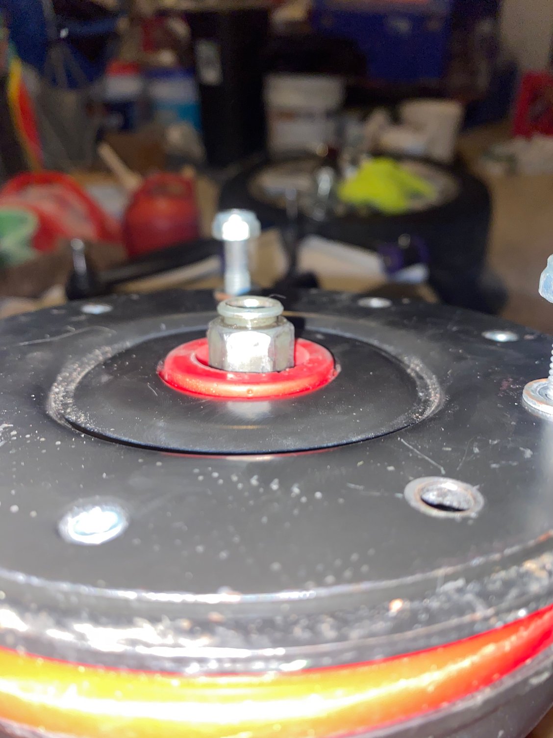

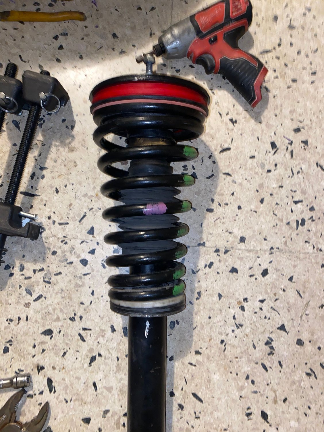

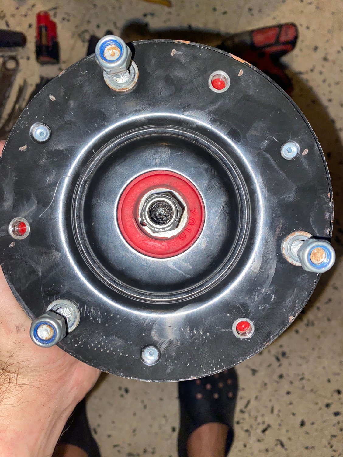

Yeah, we do, although with COVID, I would rather stay at home. I got one of the shock mounts fitted (on the problematic shock to boot!) and torqued down.
The part you sent me is of much better quality compared to the Welsh part. No doubt about it. The center bush is much more solid, and as can be seen in the pictures, the shock rod is perfectly centered. I think that will hold up very well.
One caveat, when I was about to install the second mount, one of the rivets popped off... I’m assumining either it was weak or some error on my part. No worries. I will rivet it shut again tomorrow.
Wayne, what size rivet do I need? I know a store that can sell them individually instead of in bulk for pennies on the dollar.

Gian, the mounts look terrific and sorry about the rivet. It's a 1/8 inch with a like washer on the bottom. Just clap it down with the vise grip to install.
Lets hope it works as good as it looks.
Great job.

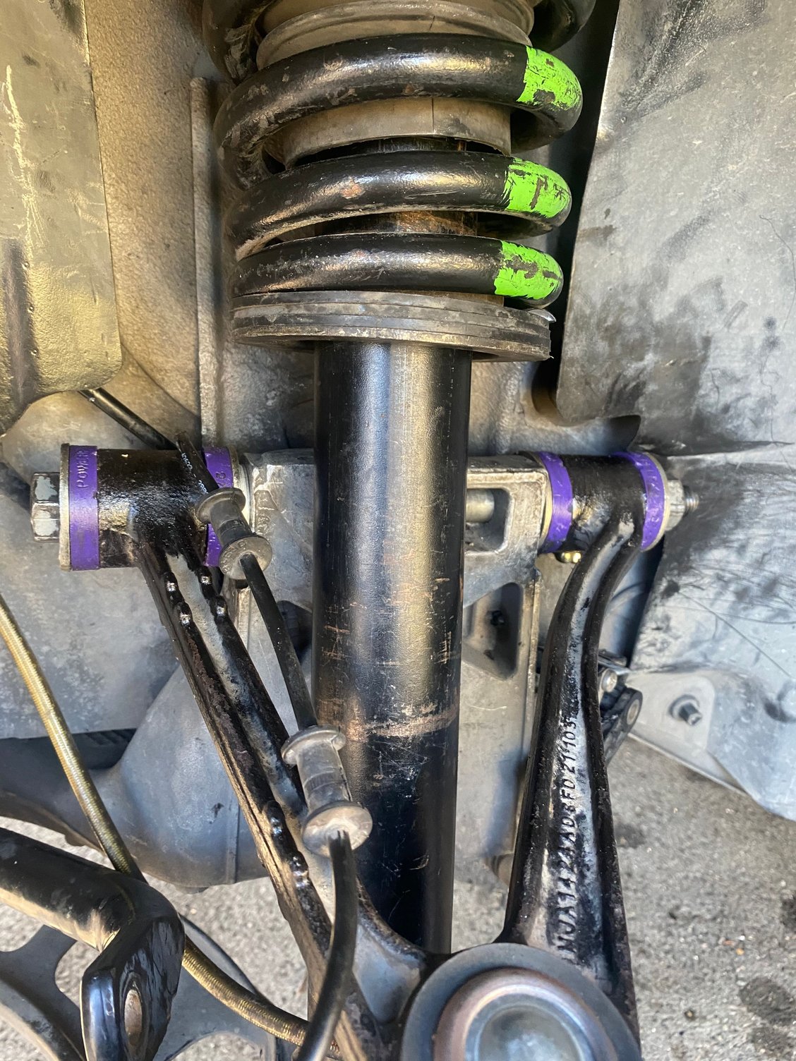

Last night when it stopped raining I took some time to fit one of the shocks. Everything went in smoothly. I did not do the other one because it was getting quite late. I took the pictures this morning. Although the parts are fitted, nothing is torqued yet.

I bought the purple control arm polyurethane bushes from Powerflex USA.

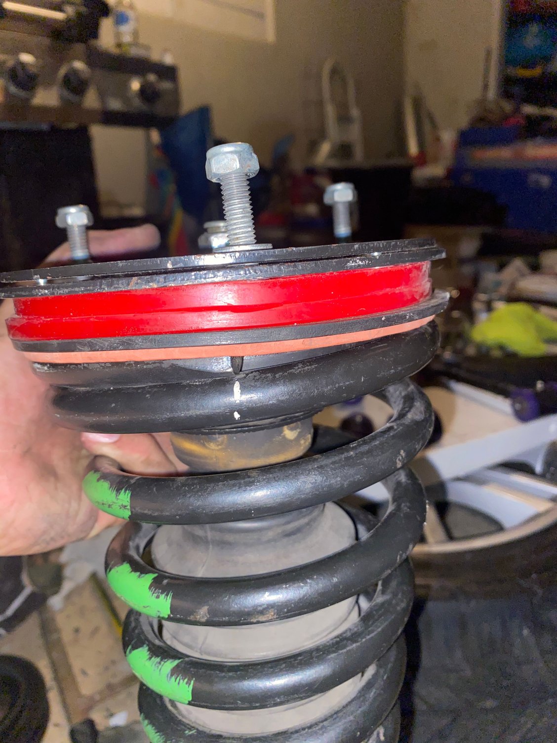

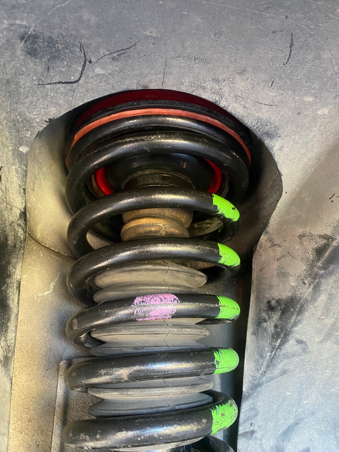

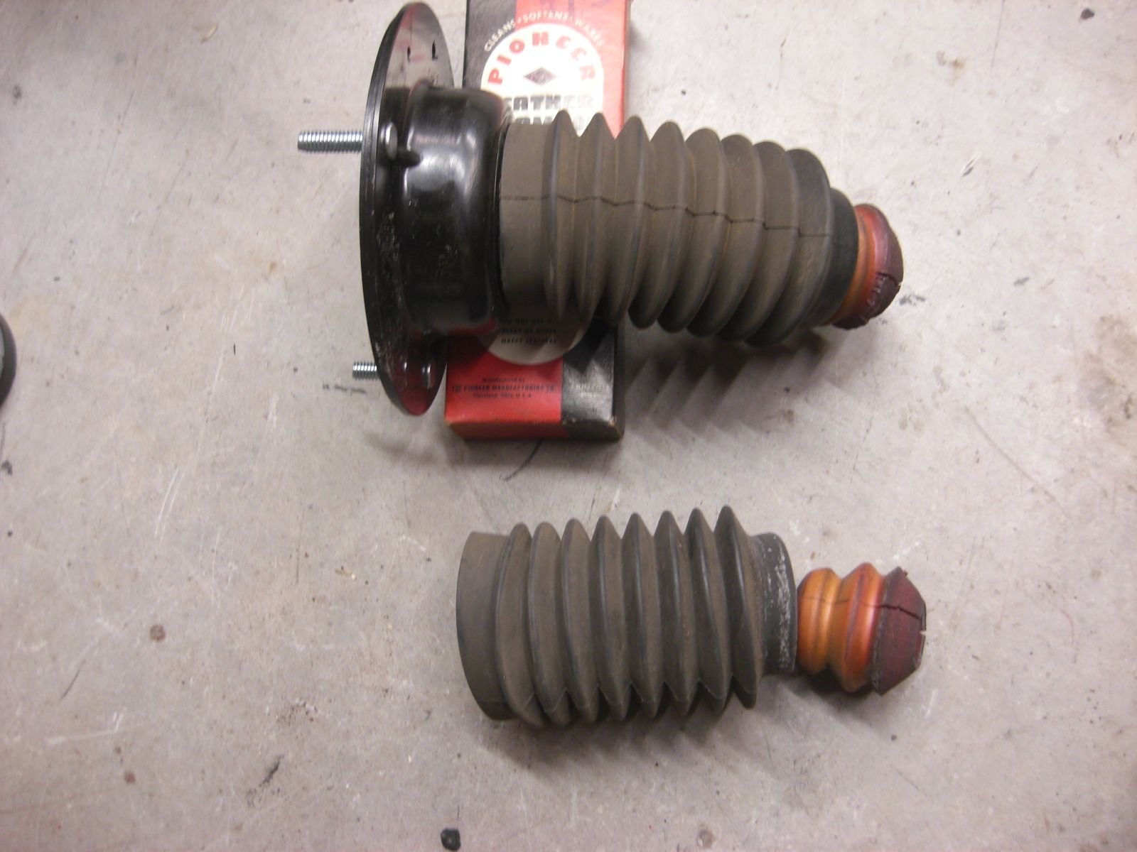

Seeing the strut pix Gian has posted over the last few days I was interested to note the positioning of the dust gaiter. I was reminded that during my inspection of several cars while looking for one to buy, and my subsequent meanderings around the Forum and on various XK related You Tube clips, I've seen several different positioning arrangements for the gaiter:-
-Small end of gaiter up against the bottom of the bump stop, large end free floating (flopping) loosely around the shock body.
-Large end of gaiter pushed right up over bump stop cup, covering bump stop, small end riding directly on shock rod (my car as received).
-Small end of gaiter slid up over bottom (smallest) 'node' on the bump stop, large end free floating (flopping) loosely around the shock body.
-One car I saw in person had torn gaiters, both laying loosely over the shock rod, not attached to anything....but the large ends were uppermost.
The illustrations in the parts lists and shop manual seem to show the small end uppermost but that leaves the large end around the shock body, but so loosely as to be worthless at stopping dirt getting up onto the rod. Am I missing something? What is the correct orientation for the gaiters?

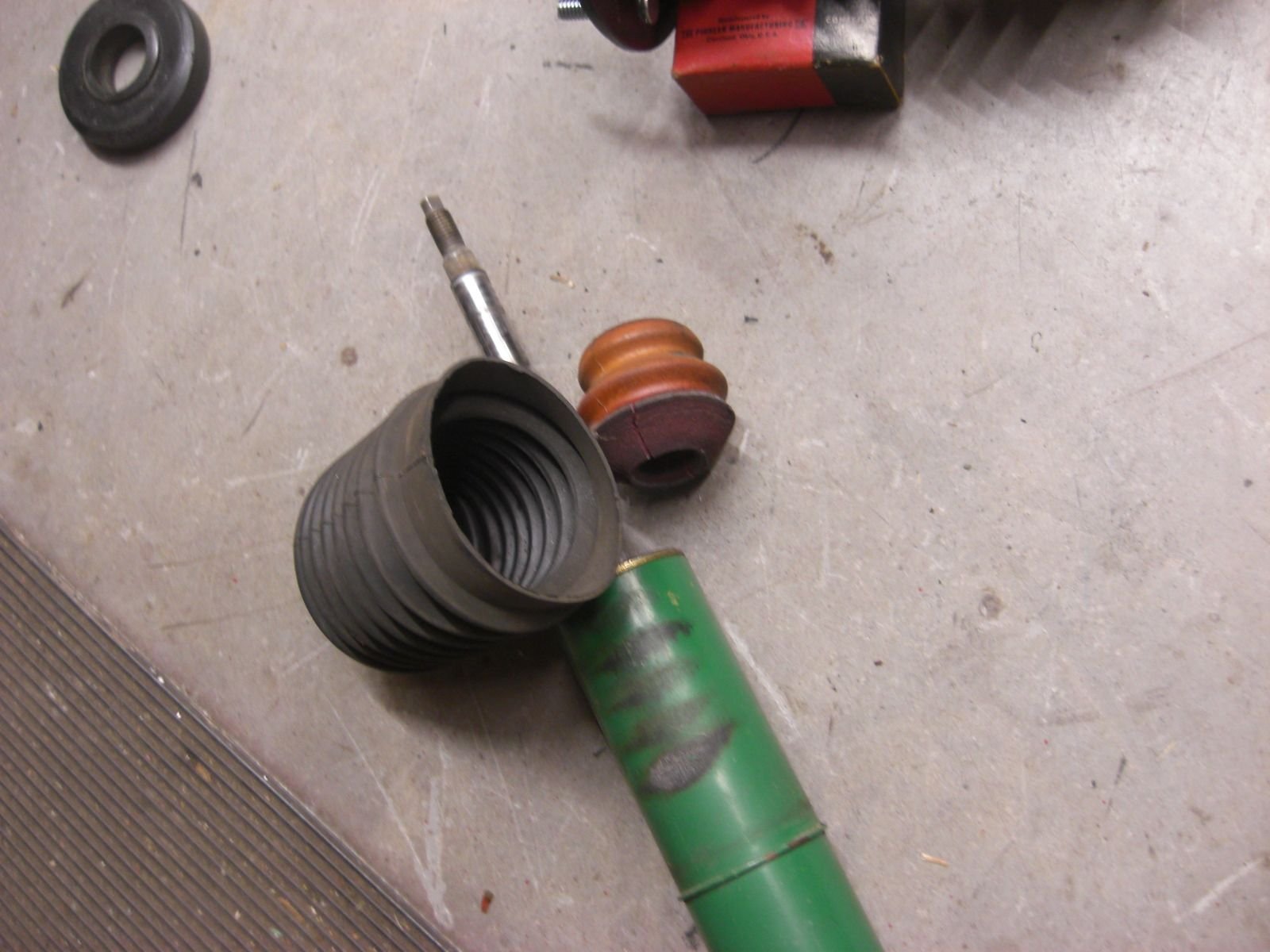

I should have come in earlier with the way I do this. The page or diagram of the KYB kit from most of the auto stores shows it the small end down.
No way will it keep dust out.
The best way I have found is to put the bump stop on with large end towards the shock, bellows small hole over the first ring then the large ring goes over the bottom of the bell, space is provided and a zip tie snugged around that area.
That's the most protection against dust you are going to get in that area until the bellows split.

Small end goes up. Workshop manual description is
1. insert the spring assister fully into gaiter
2. Insert the gaiter into upper mounting location.
The insertion is into the small bell projection on the underside of the mount.
There is no connection of gaiter to shock absorber body.

I can't disagree with you Baxtor on what the manual says.
Have a look at what I do and you can see the shaft would be sealed most of the time, unlike the large end fitting loosely over the shock to bang around on the springs.
But that's what makes life interesting, different strokes for different folks.
I must admit that a good squirt of WD40 every oil change at the base of the stem would be a good idea.
