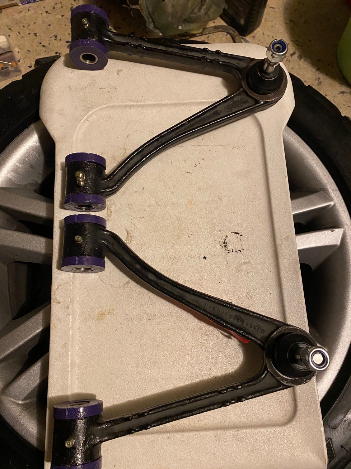

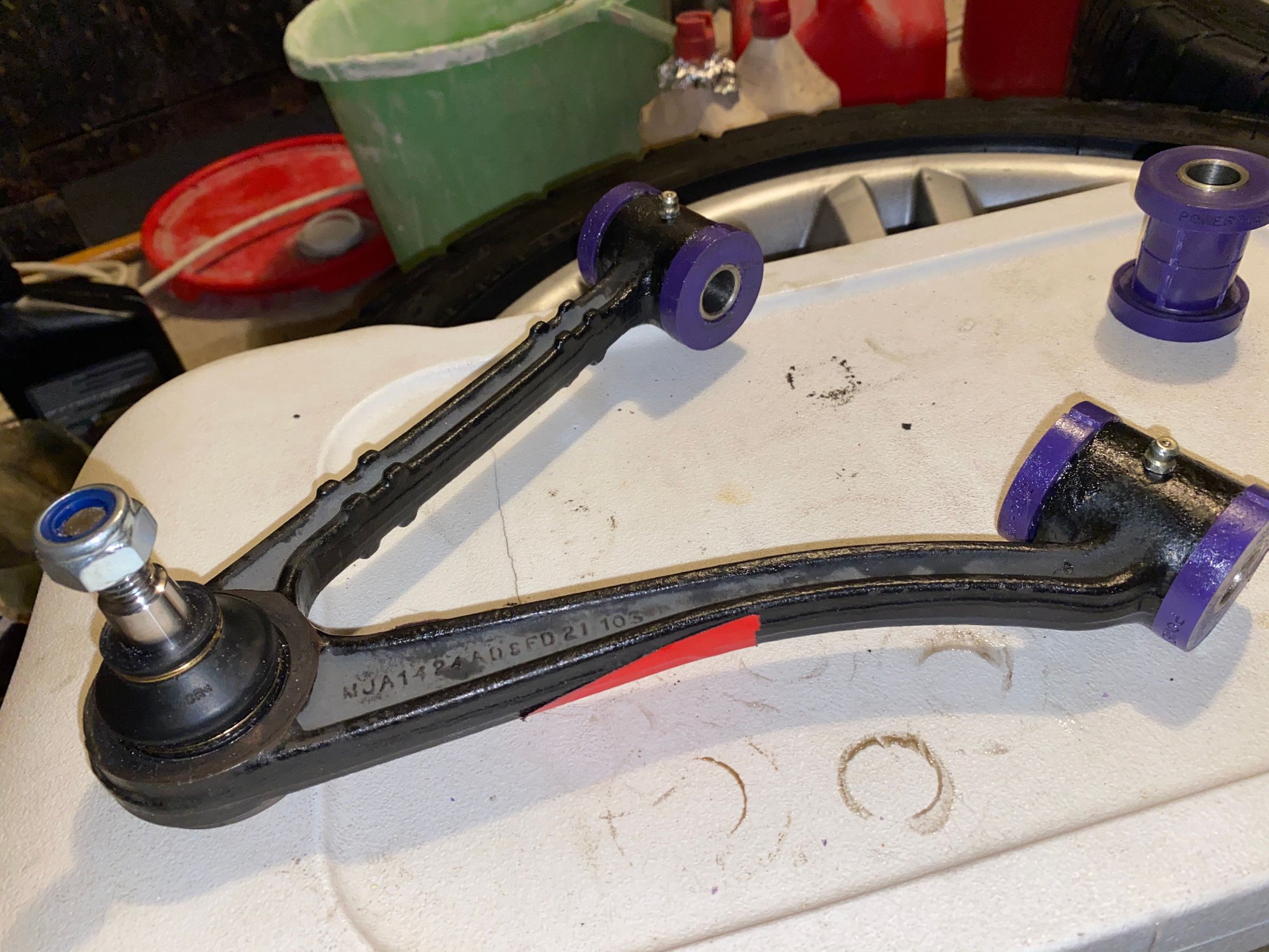

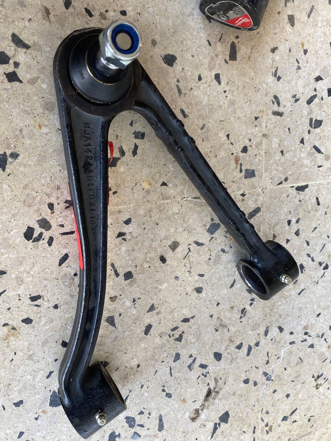

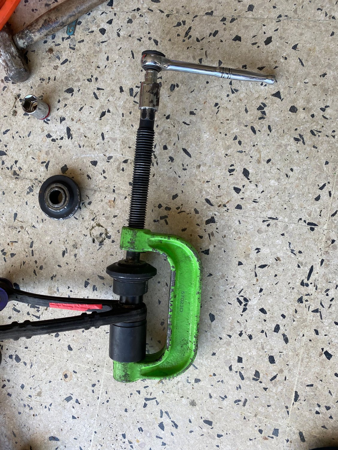

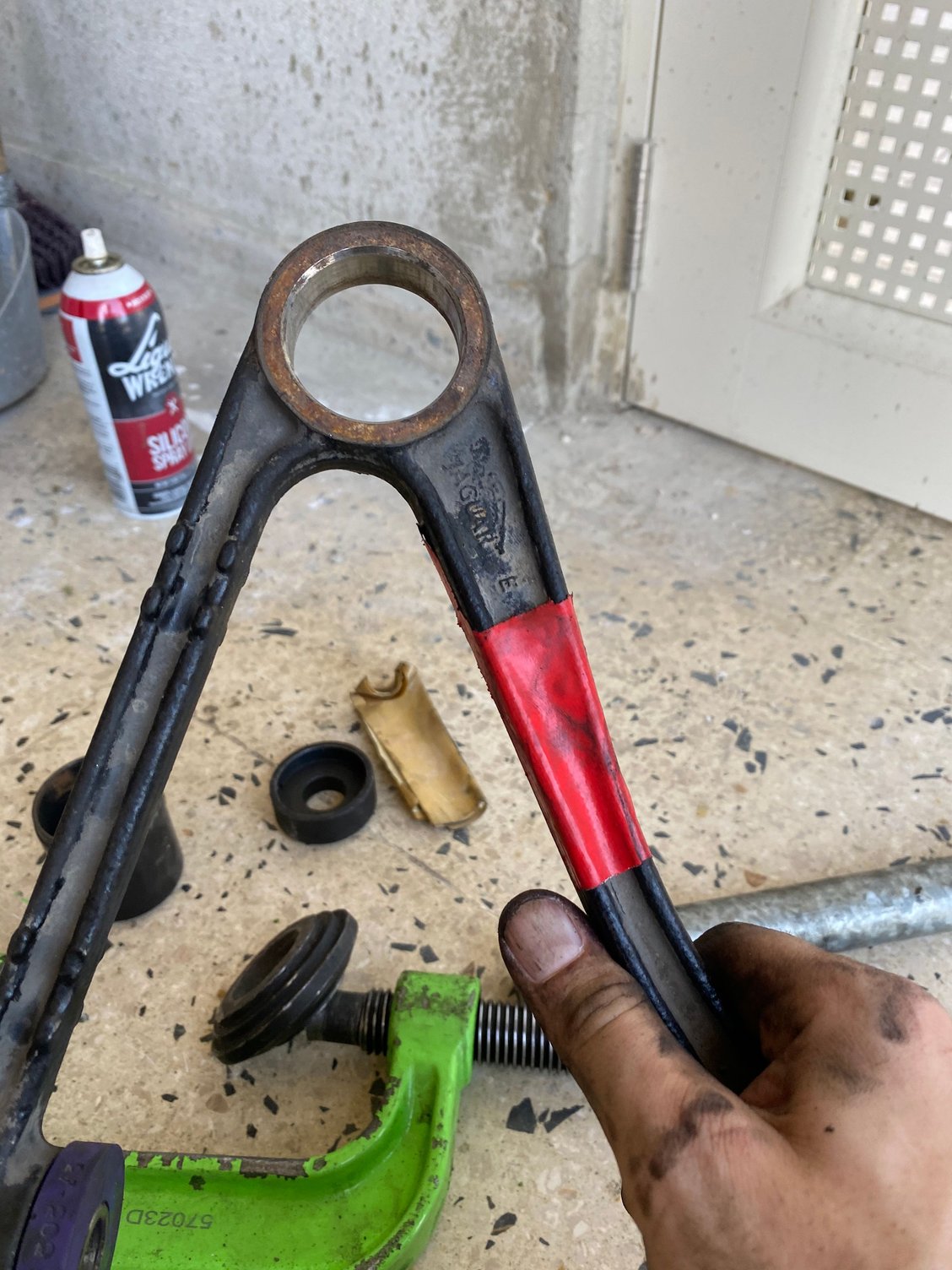

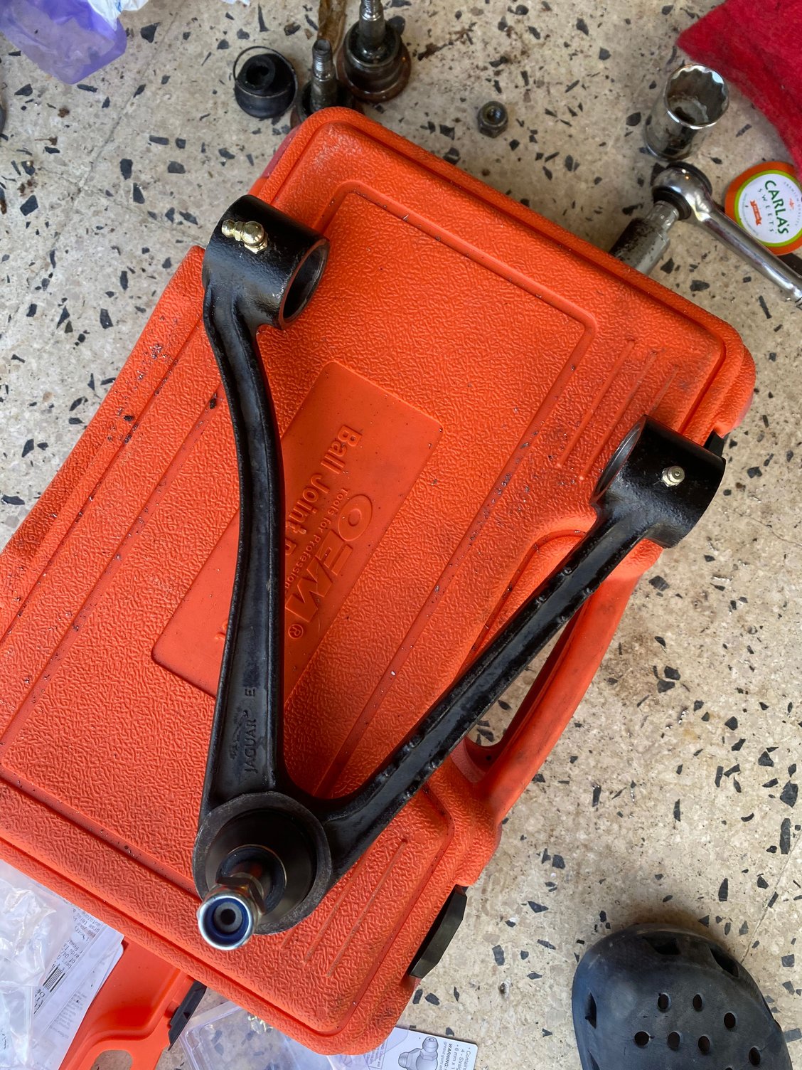

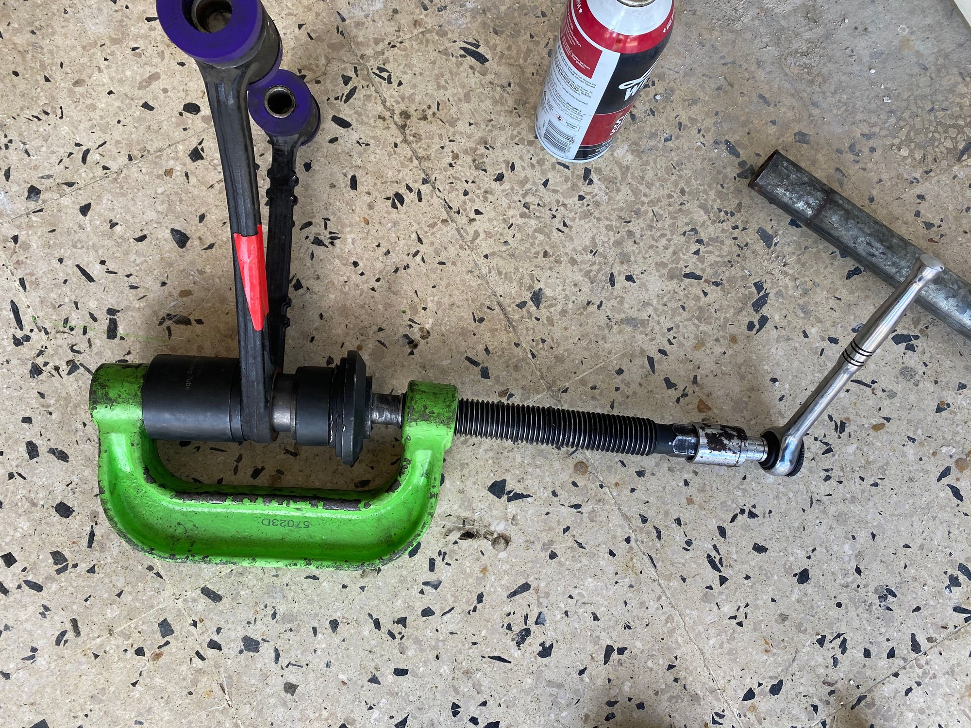

I went ahead and started the project despite not having received the package yet. I replaced both of the Tie-Rod ends. The driver side tie-rod end had a split boot. I tried separating the upper control arm ball-joint and found it imposible with the fork and hammer. Forget about using the tuning fork to separate the ball joint. (When using it, I accidentally missed with the hammer and dented my passenger brake rotor. It’s not much, but it will require resurfacing.) Instead, use the ball-joint separator that looks like a couple of jaws with a screw. It’s much easier with that. Once I had them out, I removed the fulcrum bolts and the upper control arm was then free.
My upper ball-joints were goners. They had lots of movement with no resistance at all. My lowers I replaced last year and am not worried about them.
I then used a C-clamp press to R & R the ball-joints. Next I drilled and tapped the control arm bushes and installed some Zerk fittings for a grease gun. I was now about to modify the powerflex bushes by adding grease channels to them, but it turns out my dremmel is damaged and won’t turn on. I am now off to the store to buy a new one.

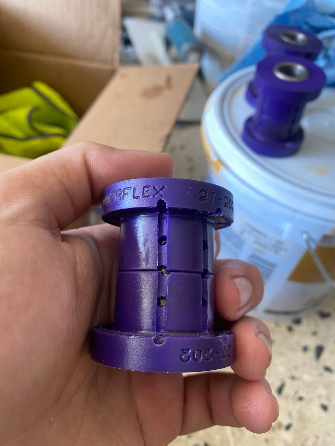

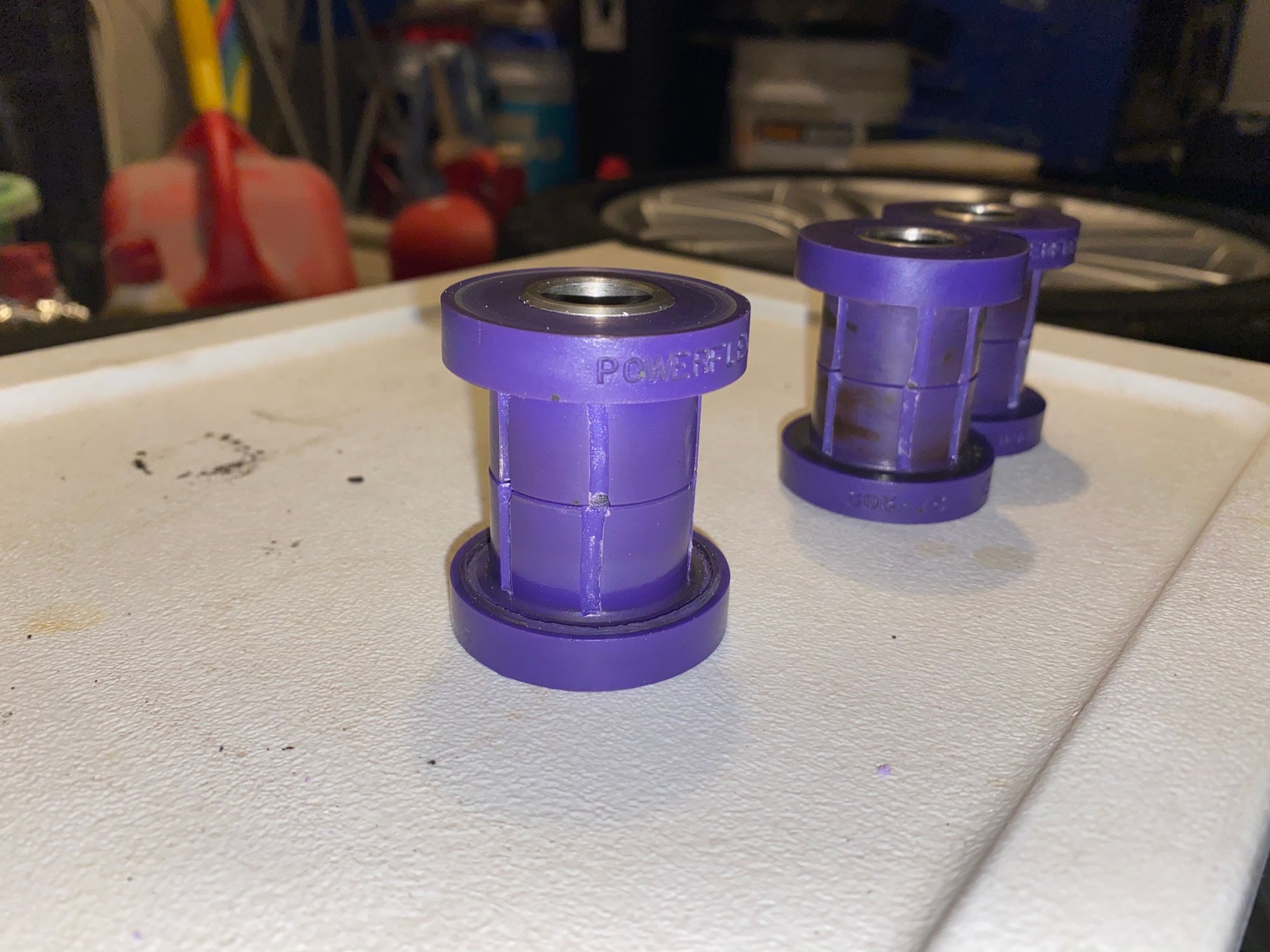

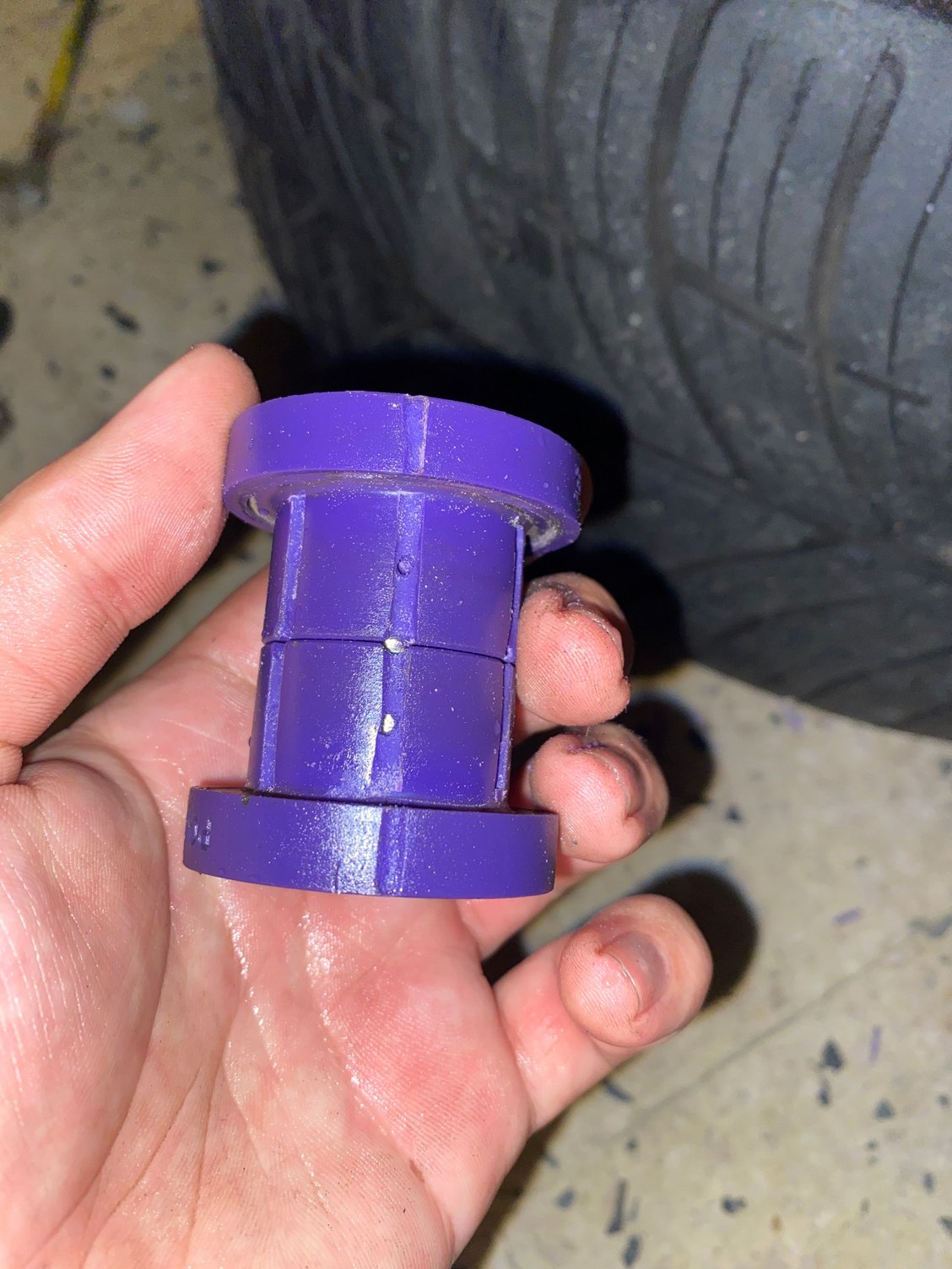

Re: the suspension. I did manage to buy a Dremmel at The Home Depot and used it to create grease channels in the powerflex bushes.
First design: grease channels
Then I tested them out and found, that while the bush was being greased, the inner bore was only lightly greased.
I drilled some holes and tried again. I was happy with the results.
Final product: New ball joints, and new zerk fittings. The bushes were greased using Hotchkis Super Silicon grease. That stuff is extremely tacky, it took me 30 minutes to get it off of my hands.

Poly bushes are usually fitted to be static in the control arms and rotate only on the crush tube, hence the cross hatch grease trap in the bore.
l can't off the top of my head see why your greasing inside and out would lead to any problem but it is unusual.

Well, I'm thinking greasing the outside is just a consequence of using the zerk fitting, but what I want to do is have the inner bore be greased, which is why I created the channels and drilled the holes to allow grease to reach the inner bore. I might modify them a bit more tomorrow.
Also, I just learned that adding some Teflon tape to the anti-roll bar and the control arm bush sleeve can help eliminate squeaking.

I first modified the upper control arm bushes even more. I widened the holes I made in the channels to allow grease to flow into the sleeve with more ease. I also created some channels along the outer rim of the bushes to allow excess grease to flow out when greasing the bushes. I then went ahead and greased the anti-roll bar bushes. The squeak is now gone.
Next, I removed the strut assemblies from the car, which was easy without the upper control arm. I remembered today how much I hate using spring compressors. I managed to get one of the shock mounts free from the assembly, but the second one is giving me some trouble. The top shock bolt inner hex that accepts the Allen key is slightly stripped. I wager a slightly larger Allen key would do the trick. I will have to buy one tomorrow and hope that solves the problem.
Re: The mail. Today the mailman delivered the thin and thick caster alignment shims I had ordered for this project that I had ignorantly thrown out the first time I installed the polybushes. However, the mounts were not in his truck today. Hopefully, they’re here tomorrow.
The final design of modified bushes.

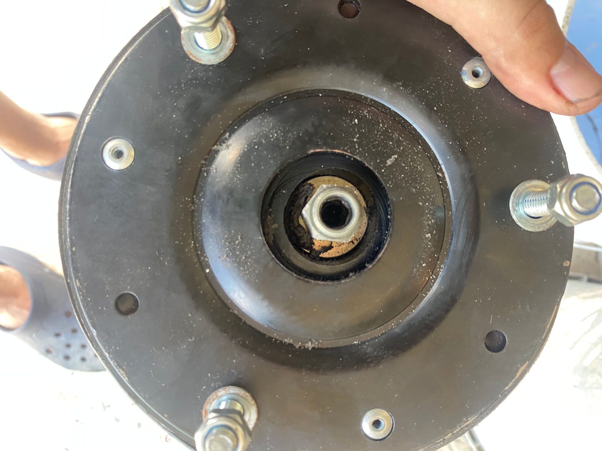

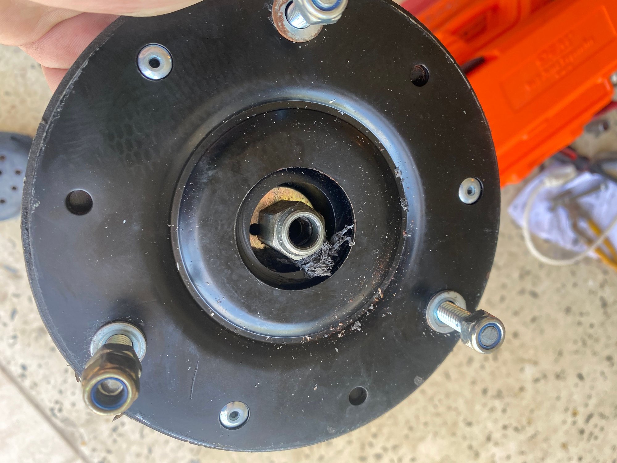

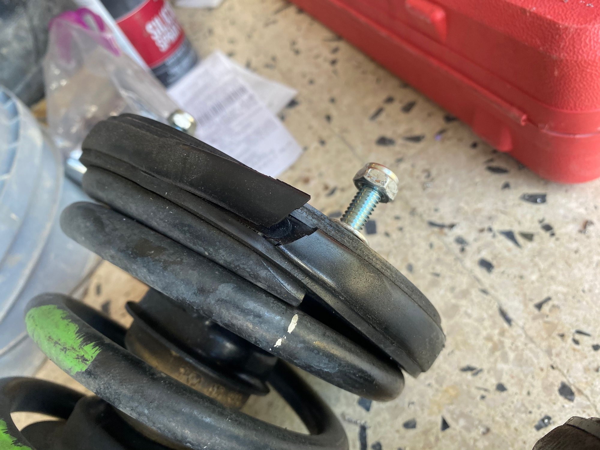

Passenger side Welsh mount was already starting to break apart. According to my records, these mounts were installed on May 4, 2020 at 74,800 miles. Currently mileage is 79,989 miles.
Shock nut is not centered and you can see signs of the bushes being shaved by the mount itself.
As you can see, the Welsh mounts were beginning to fail after 1 year, and 5,189 miles. Truly abysmal longevity from them, and this is my third set of them.
