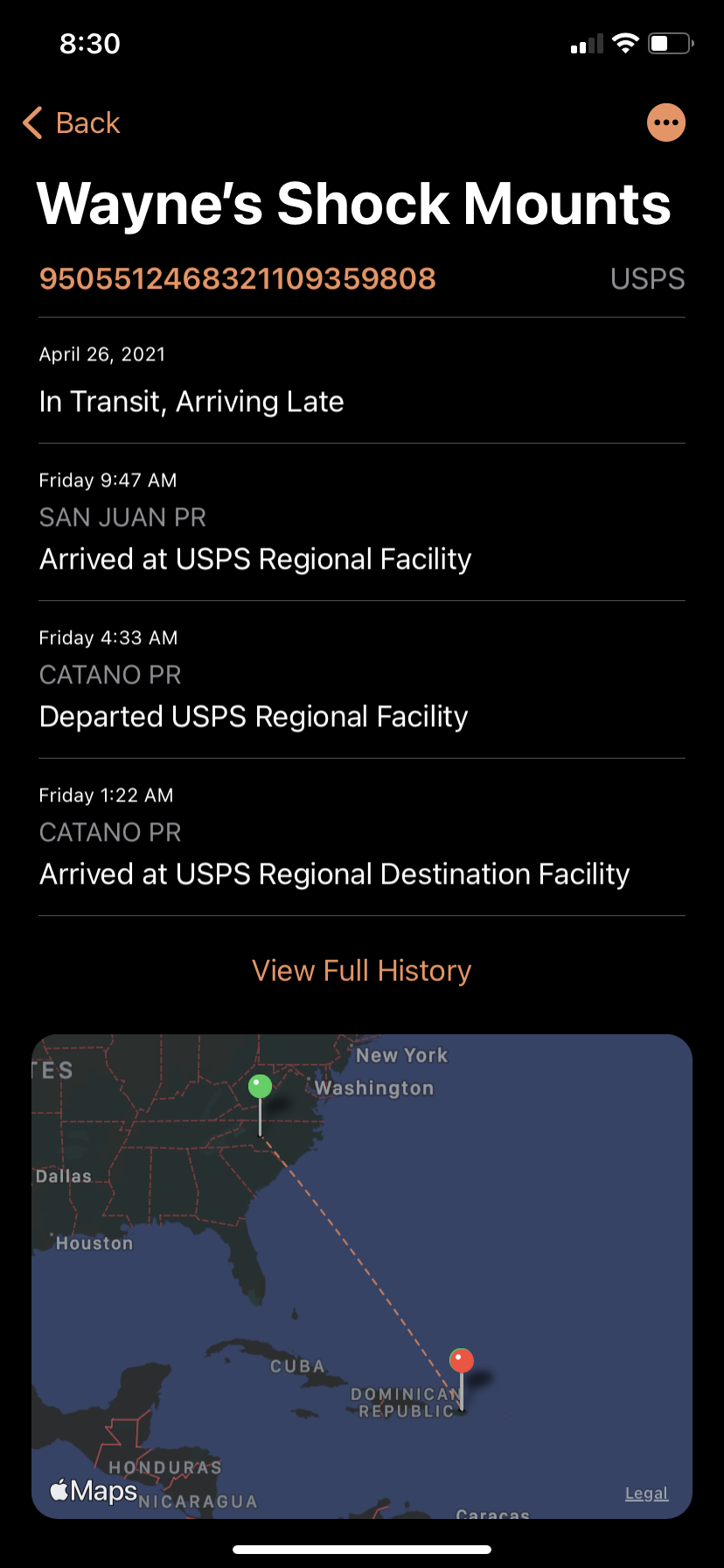

It seems the mounts will arrive Monday, since they never arrived yesterday, perhaps even Tuesday. I had a chat with a buddy mailman the other day and he told me they have been severely backlogged on deliveries since the pandemic started.

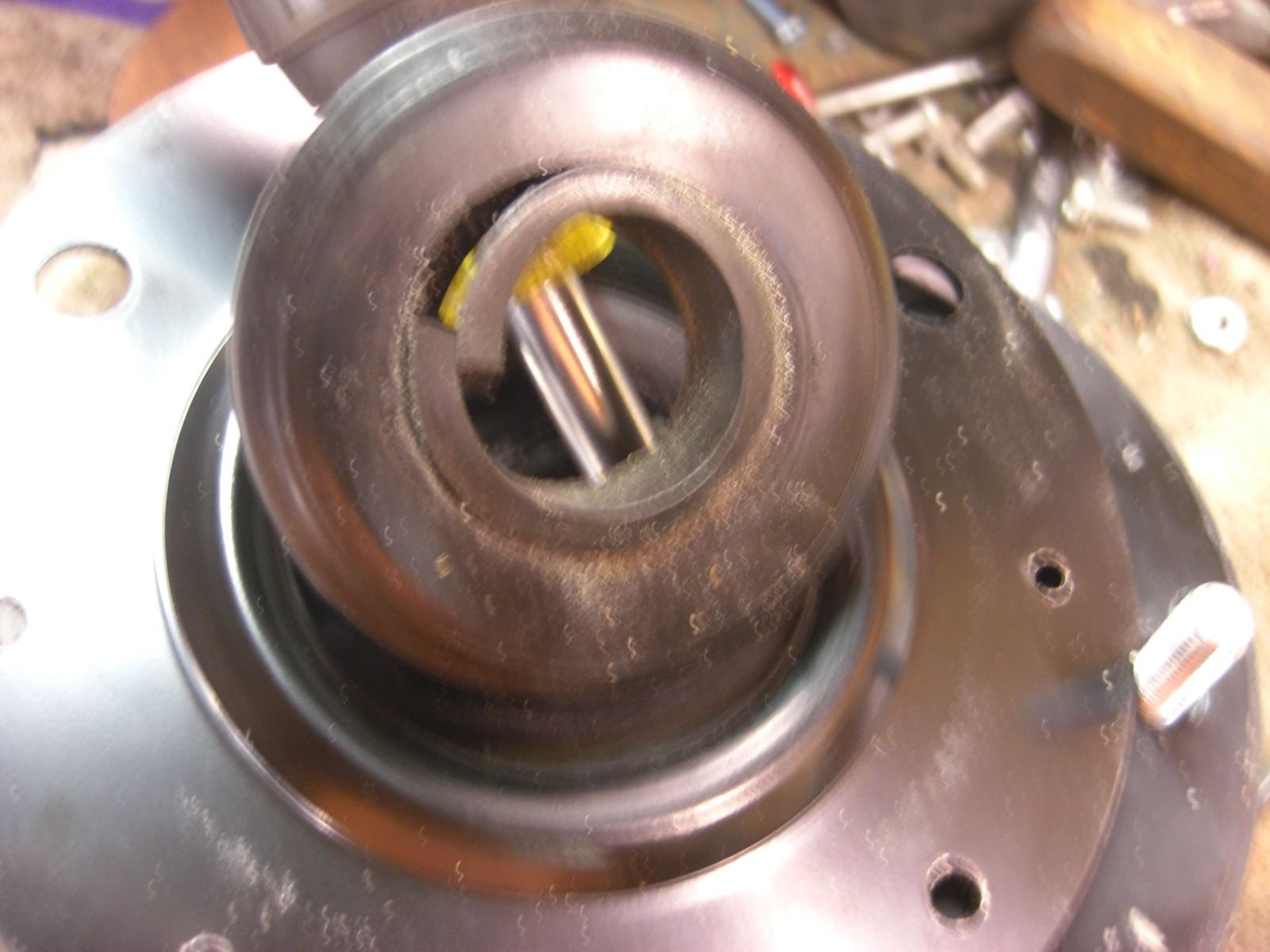

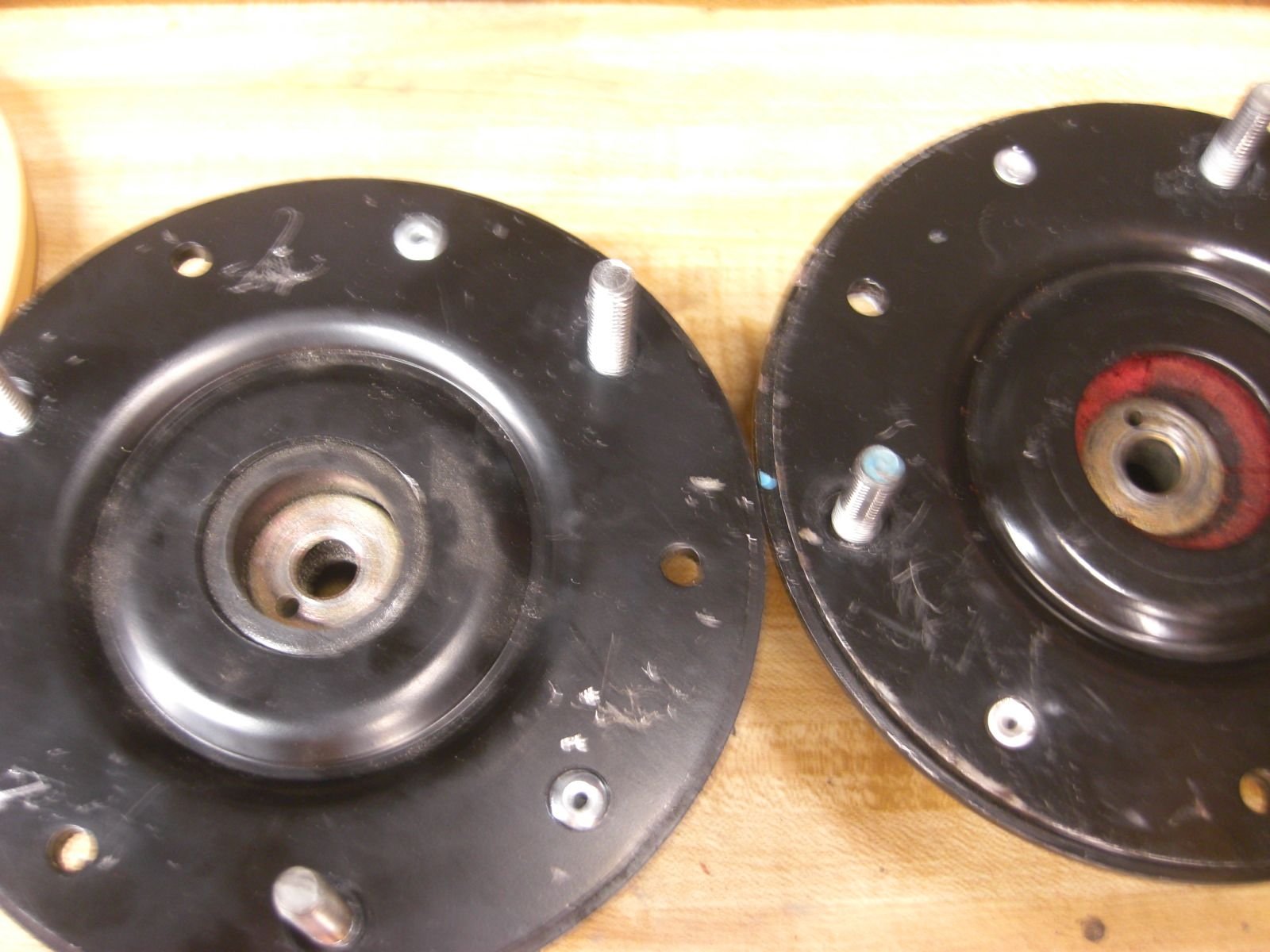

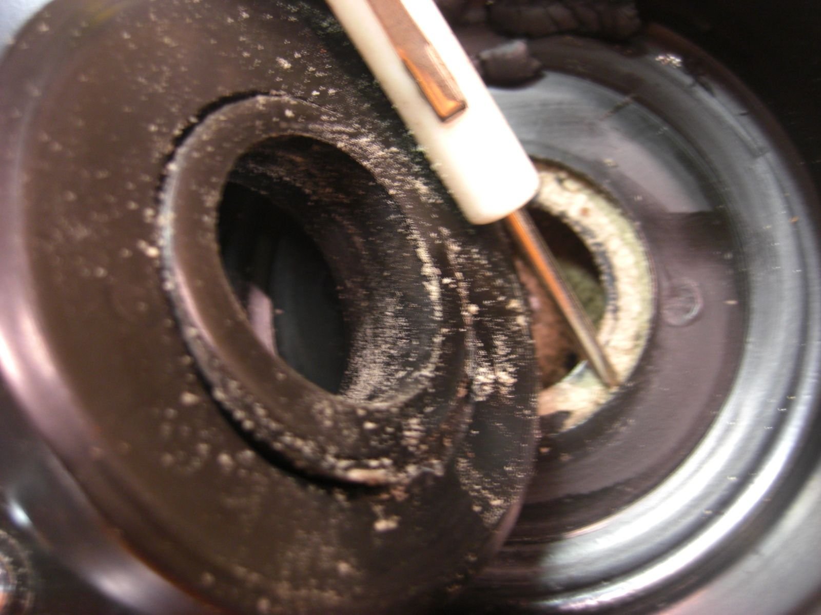

Took Steve's Welsh mount to the table for some R&D. The bells are the same height, that's good, the washer in the middle, same but the hold groves are in the Welsh washer and may hold the bushings in place better but I think they have some issues. The holes in the middle of the washer are the same size as the crown with no corners to keep it in place. Small issue there compared to what I found inside.
Biggest surprise, it was the bottom bushing in the bell that was self destructing and the top one had already cut the top lip of the one around the hole.
On some of my earlier work, we (Jim ( Wymjym) had noticed sharp edges in the bottom of the bells. Both stock and Welsh had the same problem.
When you look at the pictures, it's so obvious the bushing are cut in half and the top one was not far from being just as bad.
The sponge ones from the original mounts would hold up a bit better but we all have seen not completely. The screwdriver points to the really bad edge.
So any one replacing their mounts, you need to make sure the sharp edge is taken off, even if you have to take it apart. sorry.
The pictures of the mounts show the same height and disintegration inside the top. Notice the bottom lip was cut off and the top one was not far behind.
Oh, the edge would cut your finger if you applied and pressure around it. So what do you think happens as many up and downs of the shock on a 10 mile trip. No chance, but the material was nothing like any shock mount on a regular one with big cavity washer holding it together.
Feeling better about my system all the time.

I assume where you're pointing with that tool is where I would need to smooth the edge when I install yours?
Old Apr 27, 2021 | 06:56 PM
  #95
cjd777's Avatar
Posts: 2,946
Likes: 1,586
From: Spencer, NC
No Gian, already done.
I do bet that grinding teeth as a daily thing would make you a lot better at it than me. LOL
Finish up the exam and lets see what we have.

Good news: according to the tracking, the shock mounts finally arrived at my local post office this morning. I expect them to be delivered today.

A little bit of bad news, the package has not been delivered yet. Tomorrow I'm going to the Post Office with the tracking number to see what's up. It's been "out for delivery" since yesterday. They seem to be ridiculously delayed at the Post Office.
